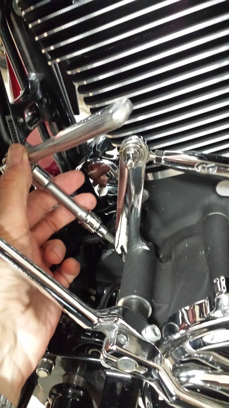

first off make sure your linkage is adjusted correctly and tighten up good and lubed up good. i noticed when a first bought a six speed bike that i was hitting neutral all the time. after riding a five speed for years and never having this problem i found it was me and not the bike. part of the problem is the six speed can access neutral from 1st or 2nd. i learned to hold up alittle on the shifter when going for second. problem solved. now i have a trike with a hand shifter on it and if i just reach over and slap 1st to 2nd i will miss it sometimes. i think the reason why is when i just slap it , it jumps back and goes back into neutral. only happens to the 1-2 shift. if i shift it without slapping it, it shift fines. just something i've learned after learning to shift with my handshifter.
