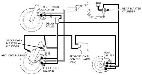

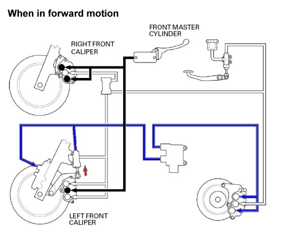

Here goes my feeble mind again! I thought the secondary master cylinder activated the ADV ????? What is capped off on some conversions is the fluid flow to the rear brake when applying the front brake lever??????
This is why, I thought, was one of the reasons all trikes were included in the latest revision to the recall??????
With the new brake system that RS now offers...the ADV is disconnected & the secondary master cylinder is removed..And the brake system is now linked...
Huh????
Do you mean not linked?
Be willing to bet when applying the rear brake, it is still linked to the front left!
I'm surprised that removal of the ADV and the SMC is part of the conversion process but, it is what it is.
Still, part of the recall is a new rear master cylinder and a fluid flush and refill.
I'd still do the recall just for the flush and fill!
My brakes were delinked during the install of the HTS RS kit...my rear brake pedal only works the rear brakes & the front brake lever just works the front..
If you own a newer Champion IRS, the secondary MC is still hooked up to the anti dive valve. The plumbing is reworked so that you have 2 pistons working on the left side when using the front brakes!
The new plumbing allows you to bleed the secondary MC at the ADV. ( part of the conversion includes a new hose from the secondary MC to the ADV!
I have a 2013 Lehman Monarch LLS II, and I de-linked the the brakes following the Champion instructions!
