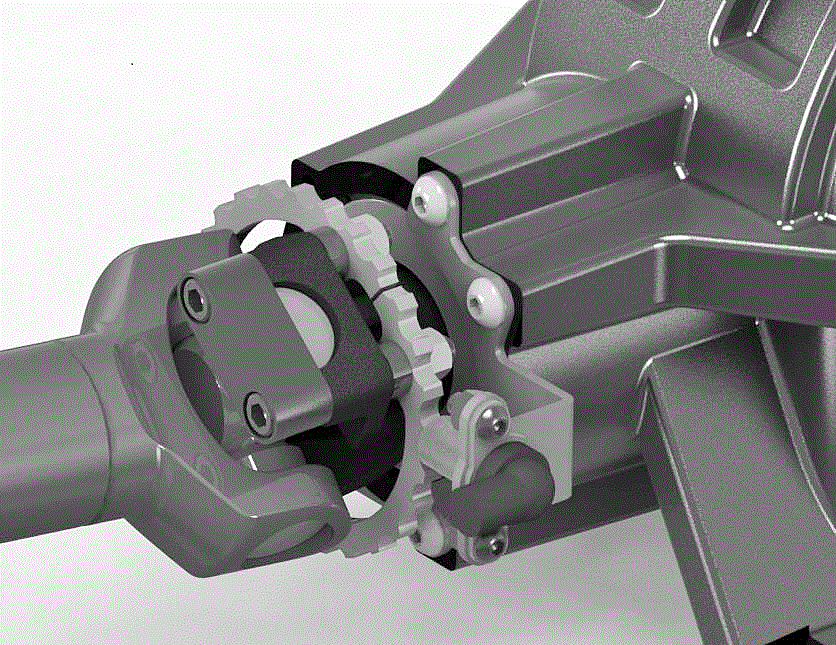

I am having mine triked with the CSC kit in July. This is the first I heard of the Shaft issue and it is concerning at the least. By your statement above it sounds like CSC fixed the problem. Is that true or did they just mask it? If they did fix it, is it the same technology as Mountain Trikes??
I found this photo of the newest drive shaft with the ABS upgrade in the PDF installation manual with a release date of 4-15-2015.
