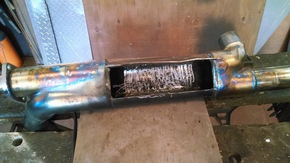

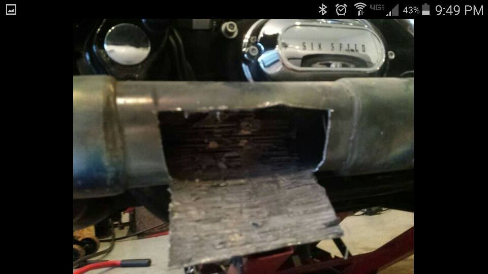

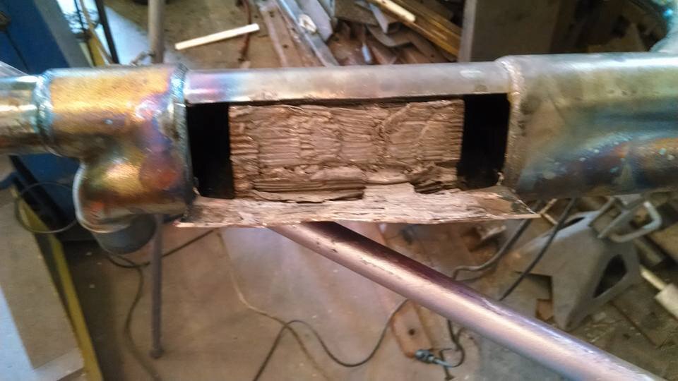

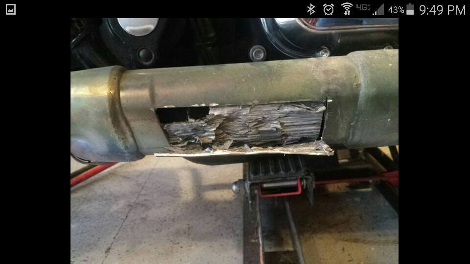

It's a little more entailed then just pulling the cat out. The area on the header where the pipes come together is where the cat is located. You have to cut that area open dig the cat out then re-weld that area back together. Yes a tune will have to be done, because you will have seriously changed the flow of the header pipe.

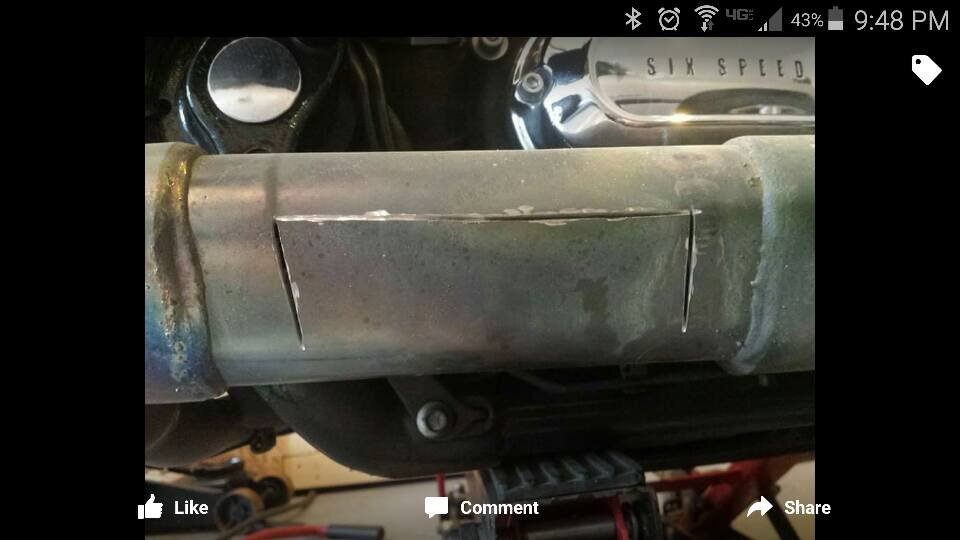

I was just talking to a guy after I made my last post. he has a nephew with a welding business. He thinks that the nephew could cut a pocket in the pipe and remove the cat for me. I have to wait until Monday to find out for sure though. Might be the way for me to go and the cost will be much less than buying a cat less pipe from someone.

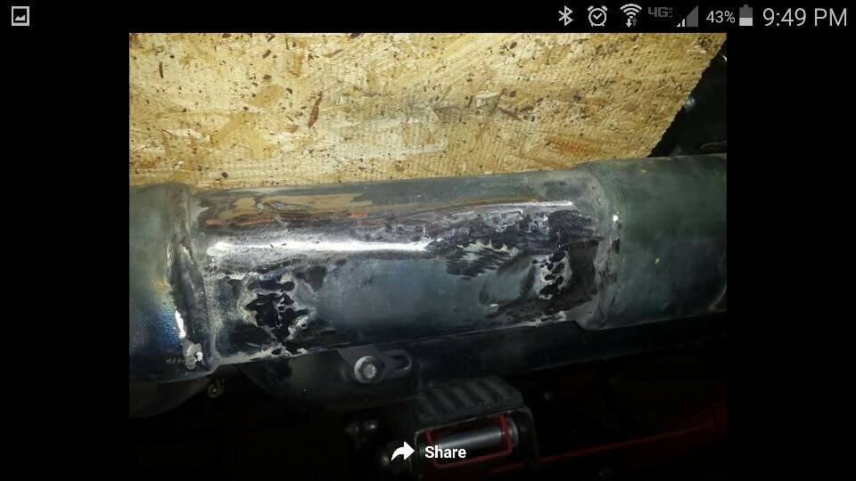

Thanks for the pics of the cat location and removal. Definitely didn't make it easy to get too.
Thats why most do the after market headers or buy them from some one who decats the headers. Either way, you need to get that heat down to make it a comfortable ride.

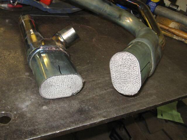

Your little flow test did prove it flows pretty well. A while back I bumped into a thread on another site about dyno numbers with a cat on a big engine. A mechanic had tuned a 124" S&S engine with the cat in the head pipe, he found it didn't cost much torque, and the HP difference wasn't real huge either.
The moral of the story is the cat doesn't hurt performance, it just cooks the rider.

I had an extra head pipe from a previous TG. I just cut a window in it and dug out the cat. Made sure I got it all out using a dremel grinder, flushed it out with a water hose and welded window back. Put it on my FW. Sounds a little deeper and runs cooler.
