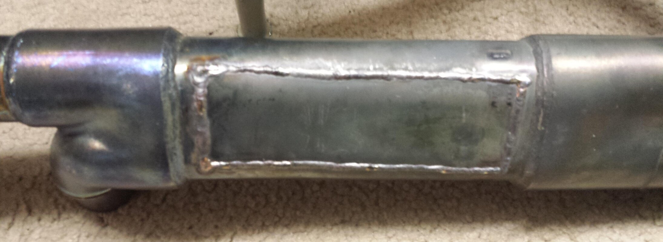

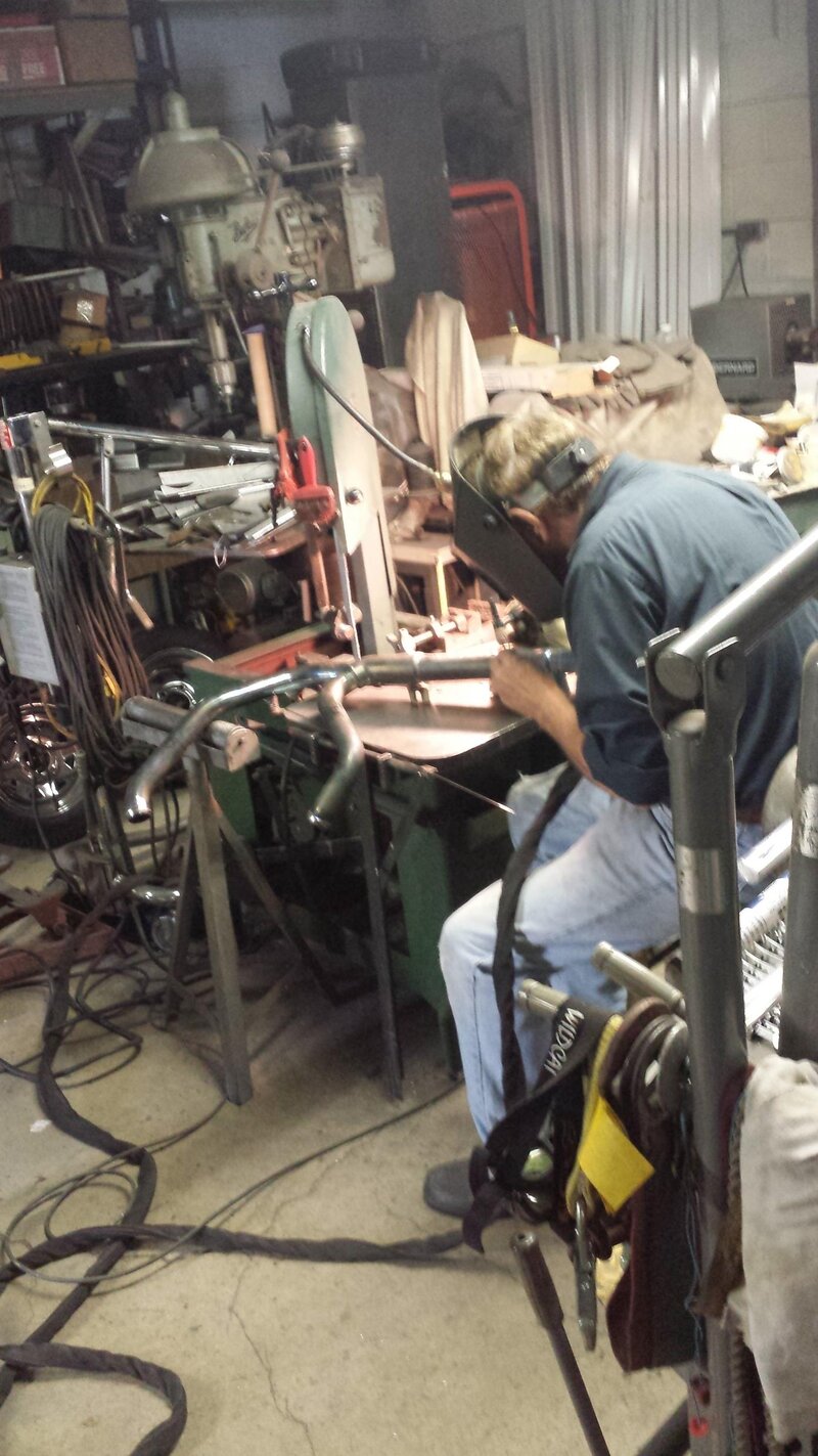

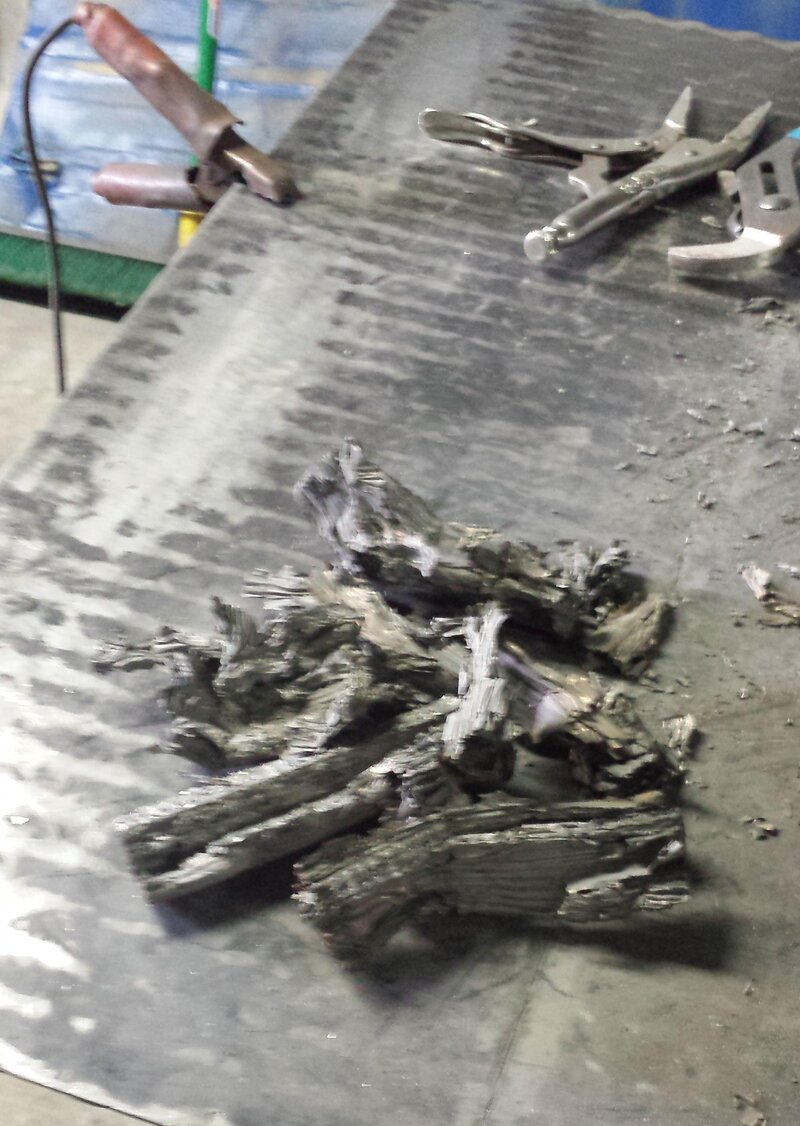

Today the de-catting was done! Damn that thing really hangs on and does not want to come out. We ended up milling most out. Next de-cat I will get a 1" carbide ball burr with 1/4" shank and use my air powered die grinder.
Will swap pipe once I get new gaskets for heads and crossover pipe. Thanks everyone.
