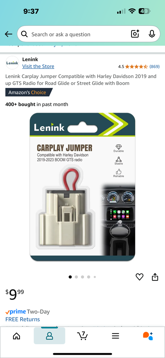

After I installed the CarPlay jumper, CarPlay works but the passenger intercom mic does not transmit. When I disconnect the jumper, the intercom mic works. Is there a way around this problem?
Tom - I think you posted this same question in another link and I asked some questions.
First, it would be helpful if you tell us what bike and radio you have.
Also, are you using wireless headsets and, do you have a WHIM?
Example, if you have a TriGlide with the GTS radio and are using wired headsets, you do not need a jumper for carplay to work.
