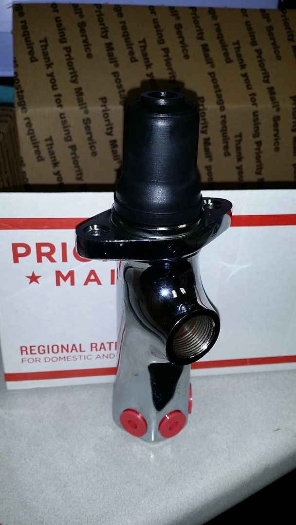

I forgot to get a pic of the lever. But i have a pic of the master cylinder.*

If you zoom in on the number of that master cylinder, it is merely a standard VW bug early style master cylinder. You can go to your local NAPA parts store and get one pretty much identical for cheaper. You can probably buy the res from them as well. Then you don't have to rely on Ebay sellers shipping the product to ya.
It don't say what size it is.
But i do know that at least one of those stock type iron ones with the threads for the resivoir is a 22mm.
I will go and price one out there thanks, plus I would have to get the ebay seller to ship it to canada
What year would I ask for?

I like that aluminum buggy one you found before.
We may need some help from the guys who know some more history.*
But from what I remember. ..
The dual cylinder came in 66 or 67.
So i am gonna say 52 to 65 beetle if you are looking for cheap.
yeah it was nicer looking and looked more for a bike, but it cost more and I would have to get it shipped into Canada
your talking about this one http://www.ebay.com/itm/Unpolished-...ggy-/161295912965?hash=item258dfc5005&vxp=mtr
Yep that one.
Also solves the problem of mounting the resivoir and/or rubber grommet/ tube of a stock type master.*
I don't have the room for it on mine.
