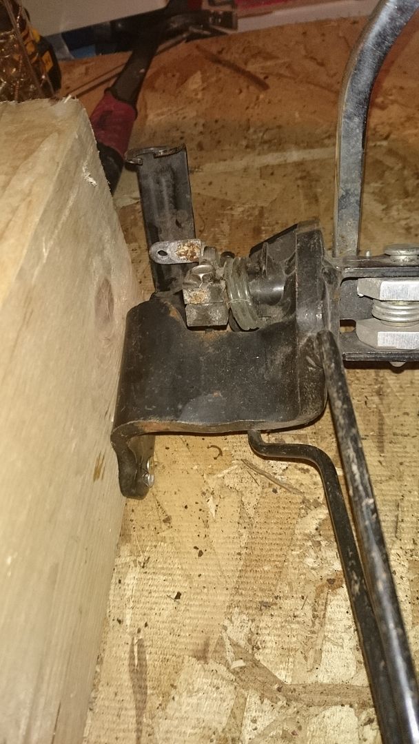

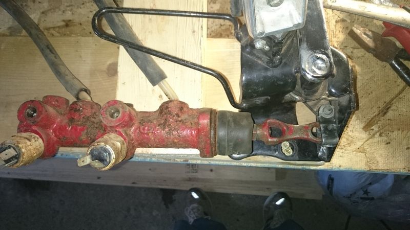

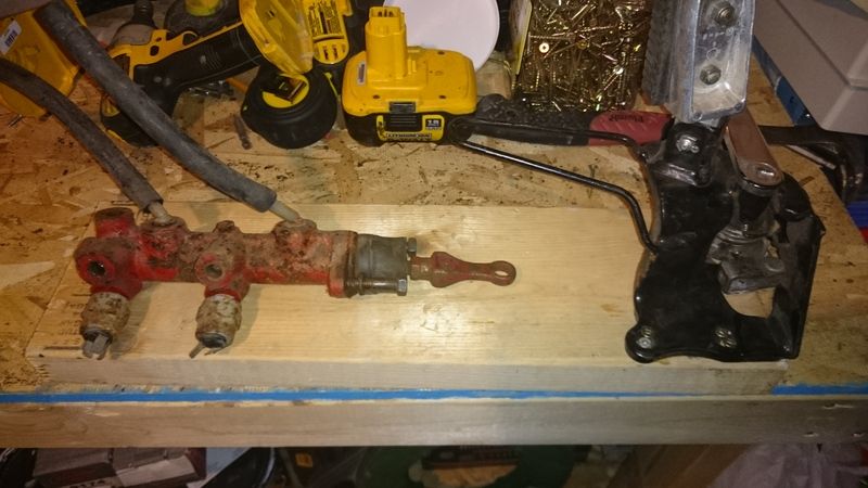

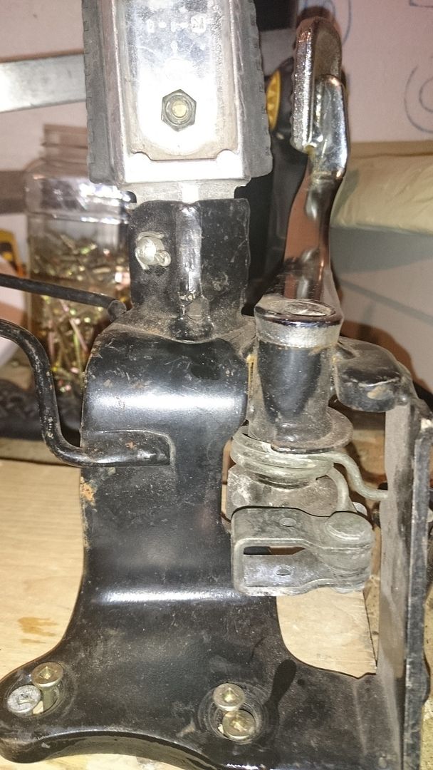

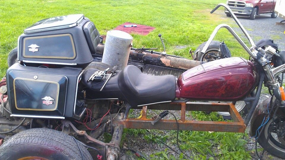

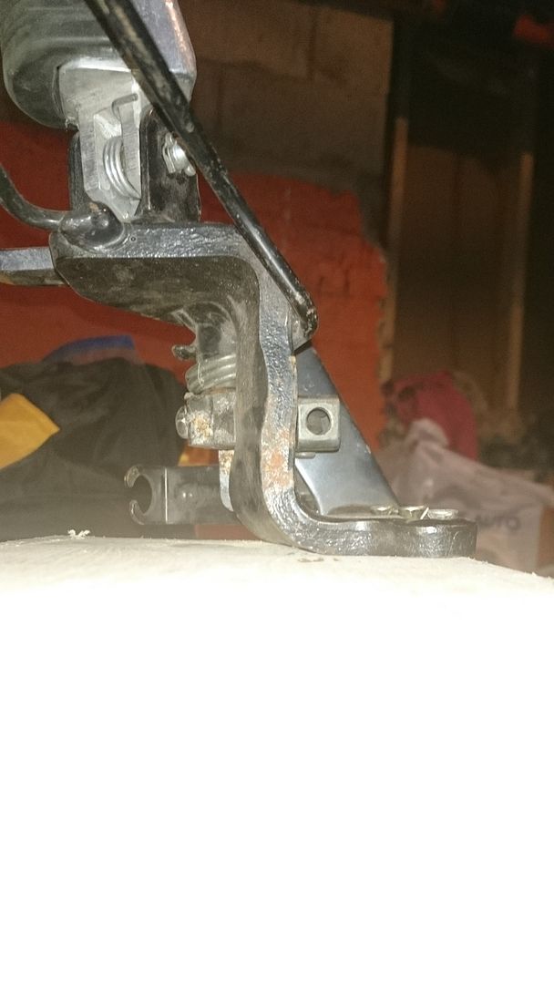

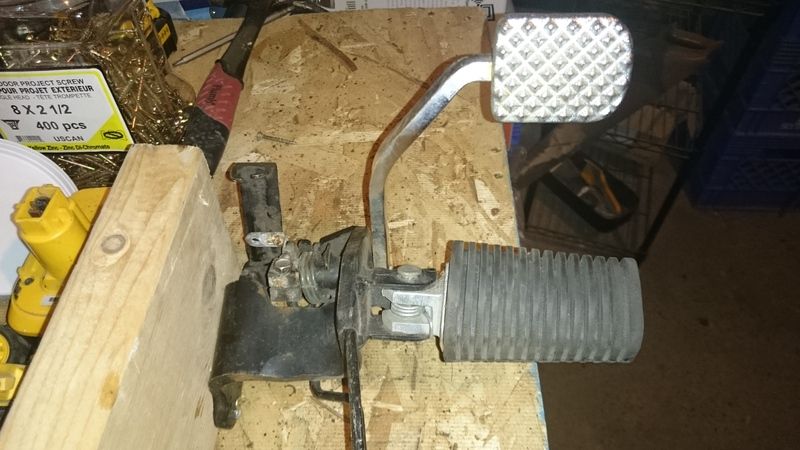

Ok trying to find out what I need to get the rear brakes and clutch working. I got a as of bolt on pedal I think the came off a old v star, I think they are stock foot controls, anyone have anyidea what I am going to need? and what is the best set up? it on a rear engine vw trike

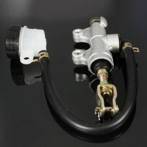

About the rear brakes..... most (not all) motorcycle master cylinders do not have enough displacement to operate (correctly) automotive brakes.

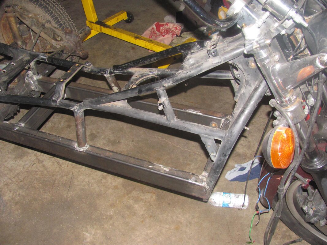

Some good choices. I presume a first build?
Not raked to far for the forks used. Should handle and steer well.
Simple construction do what you know.
I see you don't have any of the tunnel left.

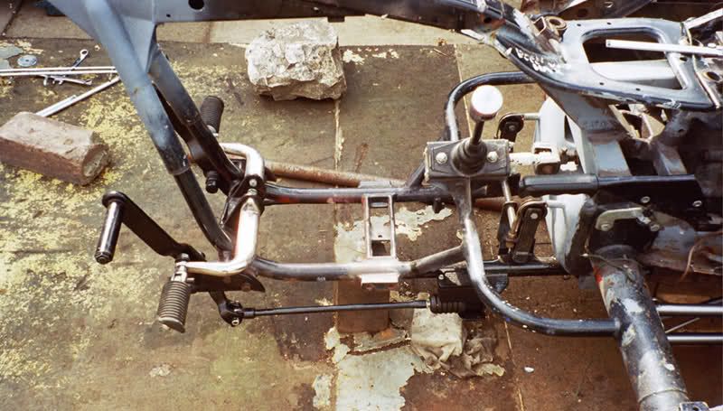

I like the hyd unit but don't have room for it so mine is all mechanical linkage.

The low and mean look is my favorite also. Now a word about rake. The most critical geometry of the front end is trail. You can make any rake angle work, you might effect turn radius but that is just an inconvenience. If you rake the front you will be changing the geometry in a big way. You will have to also change the offset of the yoke or change the entire front end to a springer, leading link, or gurder to be able to correct the change in trail. If you are not up to the construction and the math involved don't do it yet. Ride this one, learn a few things about what you want. Include all the things you learn into the next one or totally rebuild this one.
If you rake the front you will be changing the geometry in aa big way. You will have to also change the offset of the yoke or change the entire front end to a springer, leading link, or gurger to be able to correct the change in trail.

First of all East Coast, I don't believe the geometry on that pedal assembly is going to work with that master cylinder! You would probably have to have a force of 300 or 400 pounds to be able to push the brakes correctly. Keep in mind that your pedal assembly is made for a mechanical brake system not a hydraulic system.

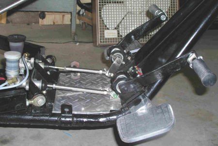

You might want to look at a complete all in one assembly like this:
http://www.pacificcustoms.com/vw-trike-swinging-pedal-assemblies-short.html
As Deathbysnusnu mentioned in another thread, the bore size will entirely depend on the wheel cylinders and or calipers being used. None the less I think you need to move completely away from the original setup that your trying to use. Just my .02 worth.
Of course I realize that most people are working on a tight budget, god knows I am LOL, but when it comes to brakes I think you need to make sure its safe man.
On the clutch set up, I would convert the clutch to a hydraulic setup like this:
http://www.pacificcustoms.com/cnc320b34.html
Will work much better and you don't have to worry about feeding a cable. You can mount the hydraulic line pretty much where you need to.

I have an odd set up on mine, but everything about mine is odd.

That is a motorcycle shifter up there. It could possibly be used as a part of a cable pull or mechanical linkage.
That motorcycle master cylinder up there would be fine on pressure but very very low on displacement. May not displace enough to operate drum brake adequately. Possibly ok with disc brakes and a residual pressure valve.

The rear brakes on a car are only a small part of the stopping power. On a trike the rear is near all the stopping power. Stock vw brakes are sadly weak for stopping by themselves. I would at least put super beetle front slave cylinders on the back with decent condition drums and new quality shoes.
Since you will only be using the rear brakes you will need a single piston/curcuit master cyl. Drum brakes take a good bit of displacement to fill up then build pressure. I personally would not use a motorcycle master on car drums. Go with a buggy/vw single master in the 17mm to 19mm bore size. Make sure your peddle and lever have the travel to push it way down the bore to get your displacement.
