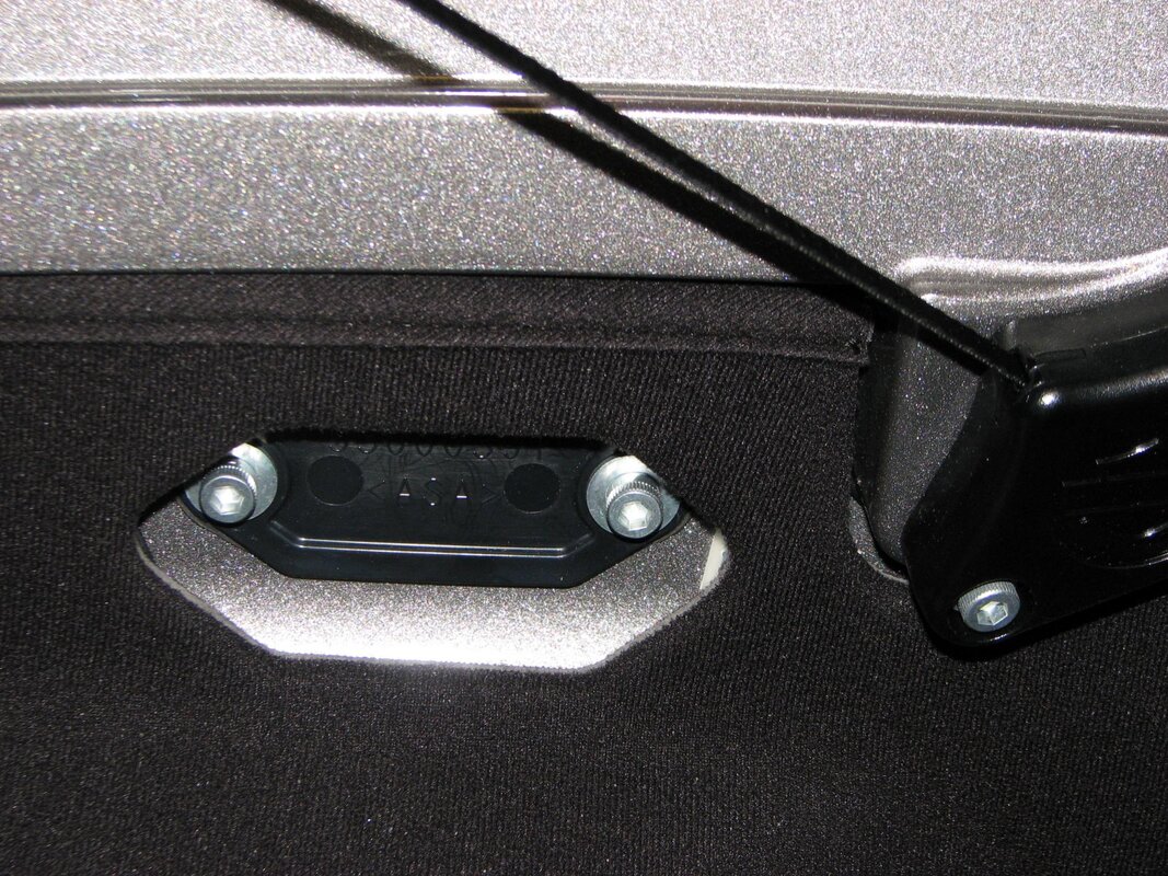

Rick, I'm having the same problem after mounting a LB01 light bar on my luggage rack. Think I will use posi-taps for the power and ground to the frame.
Yeah. I tried pushing them out from the front. Pushing them out from the back. I'm wondering if they are a one shot use. I was trying to keep the rear light circuits on the 7B connector but it will be a week or so before I can get a new connector. I thought about using Posi Taps too. If I do it will be done tomorrow. I'm going to have to use them or solder tap wires for the ground and running light so I will probably just go with a third one for the brakes.
Thanks for letting me know it wasn't just me.

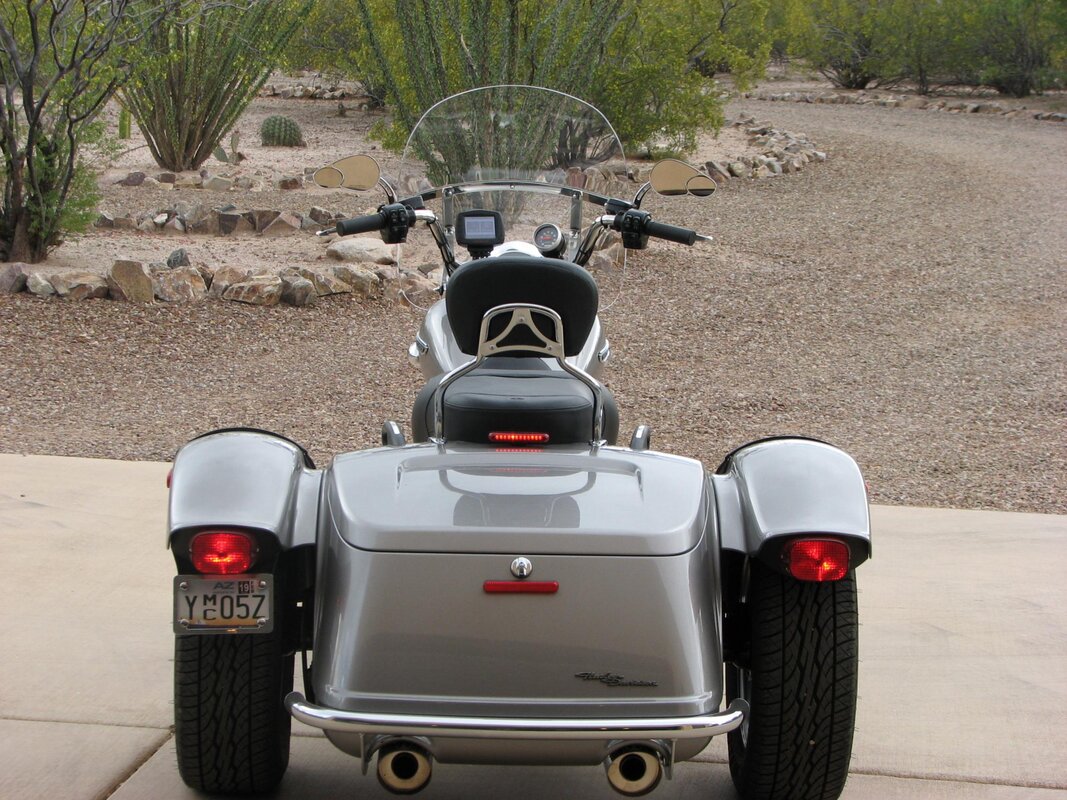

As I said in an other post I went with the Custom Dynamics LB03. They call it Non-Sequential/Flashing Brake.

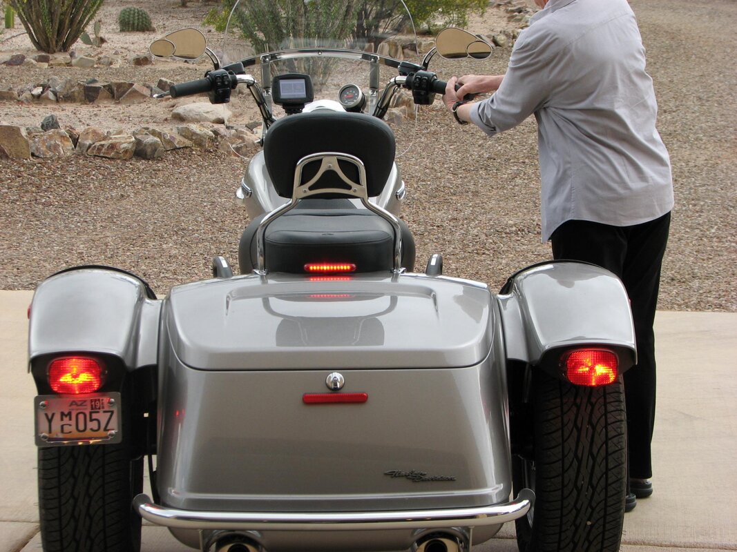

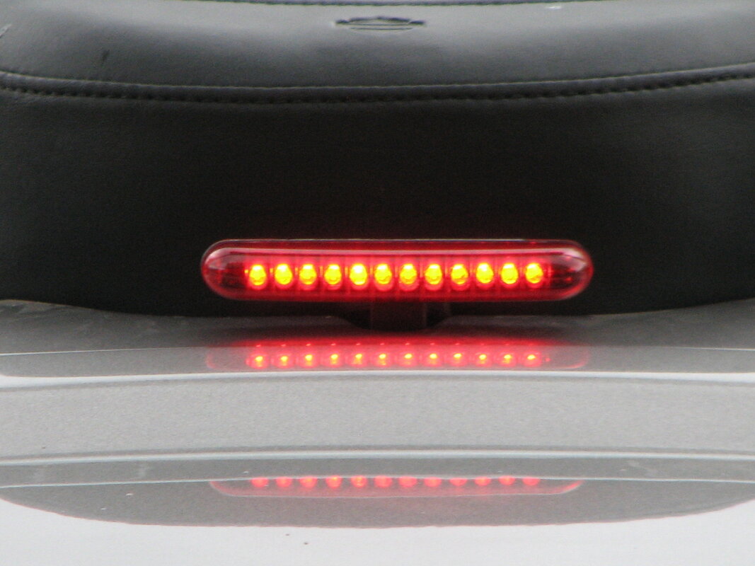

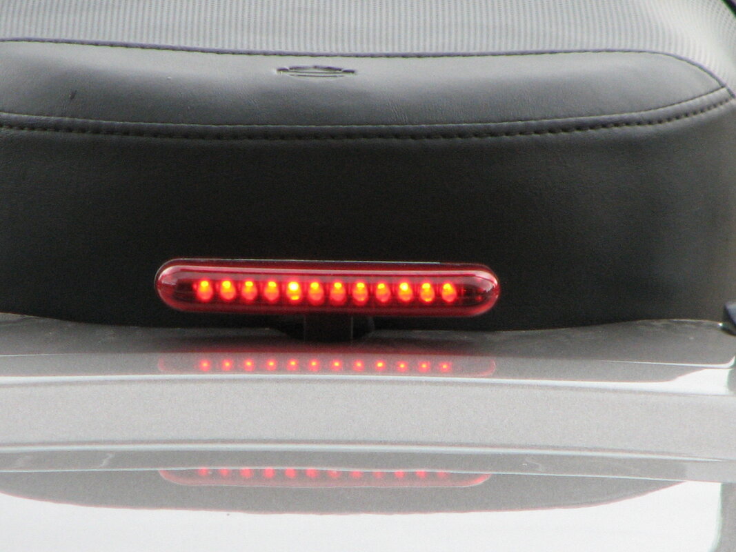

I thought about putting it where the reflector is under the trunk latch but decided I wanted it higher. I used a tee bracket and mounted it to the seat screw. I used Posi Taps to connect it and it made it very easy. Here are
some photos. It's actually brighter than the pictures show.
Thanks for posting pics. I like the way it looks, but I can't do that.

That sure would make it easy to wire with the plugs being right there under the seat.
My '17 has a small access panel on the top left back of the trunk. May be for an OEM trunk light. It goes right to were the rear light cable is. The Custom Dynamic lights come with a 36" pig tail. Looks like it is a little short for going from the reflector under the latch to where the cable is but wouldn't take much to add a little. I would put some shrink tubing on the wire where it comes through the trunk and up to the top of the trunk liner. Then some split loom around the top of the trunk. I would use adhesive tie wrap mounts around the top of the trunk. A grommet through the access panel and a little silicone would make it waterproof .
That's the way I would put the Custom Dynamic light where the reflector is. For what it's worth.

T-bracket
I really like your setup with using the T-bracket to get the light up higher. I think with it at that level it would still show underneath a luggage rack. Where did you get the T- bracket or did you fabricate it yourself. Is it secured with the seat bolt? Really neat job of concealing the wiring. Nice looking rig!
Thanks for the kind words. I used a 3" tee bracket from the hardware store. Bent and drilled it where I needed it and painted it. Yes it's attached with the seat bolt. I replaced the phillips head screw with a stainless steel allen head cap screw so I could put a little more torque on it.

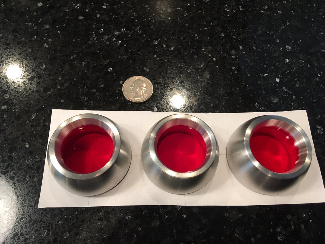

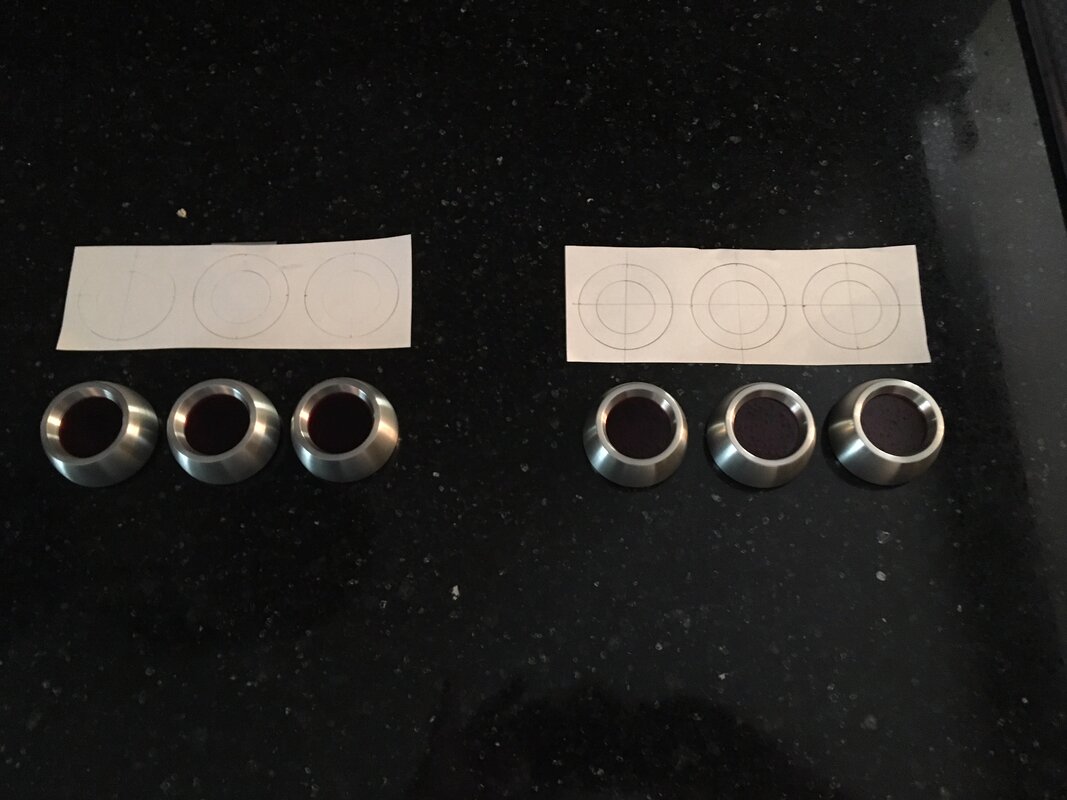

Here is where I finally landed. With my tires and new fenders disallowing the use of the OEM rear lights, I had to go to something that is body mounted. So I am mounting two set of three Bates style billet tail lights from Analog Motorcycles. The guys there were nice enough to modify their current offering to accommodate the needs of the trike body
I still need to polish the housings but have the LEDs, all the mounting hardware and rubber grommets for the assemblies. The LEDs are set up as running/brake lights and turn signals and I am adding the sequence module from United Pacifica to get the 1...2...3 directional turn signal sequencing like the current generation Mustangs and old Impalas. I will post pictures/videos when complete
Thanks for starting this thread... it has given me a LOT of things to explore and learn

Sorry it took so long. I had to put the bike back in the shop to get some paint corrected. You can see the Radiantz LED bar in the recess of the trunk. It functions as running, brake and turns. It is plenty bright.
Trike looks great! Who's handlebars are you using? Would love to see some front and side shots if you have time. Did you increase the tire size? Thanks again. Great job!

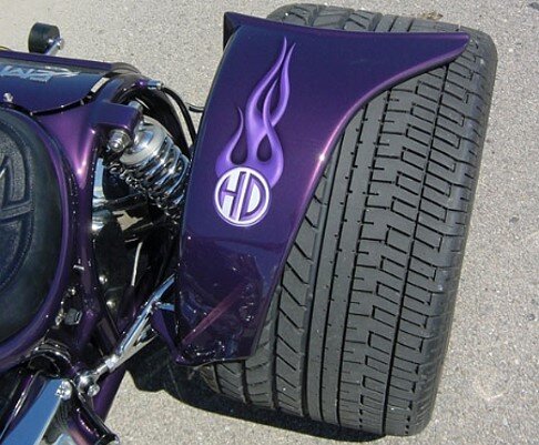

Fenders are last thing to do. This is the basic concept:
The engineering on this is essentially building a wire frame that uses the swingarm as a hard point on the front and beefed up axle caliper mounting bracket at the rear as hard points so the frame and fender float with the rear axle rather than attaching to the trunk body. I am interested in the bracket from DK and will check it out. Current plan is a beefed up machining to replace the OEM bracket.
There is a lot more detail..... but you get the idea :cool:

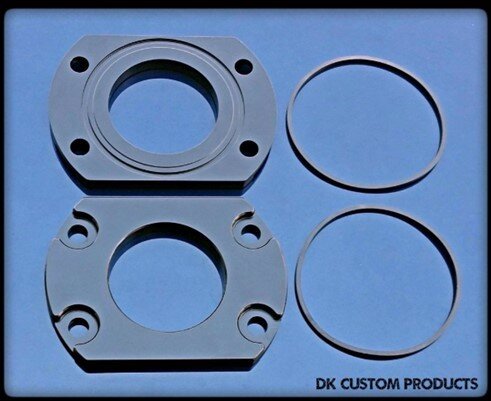

DK Comes up with the most practical and coolest (bleep)! This is so obviously a good idea and what a great gift to have a shop interested in making the ideas real. Harley should have seen the reliability issue coming for the stock trike assembly. For my modified trike, I have been concerned about shear loading on the bearings with my wide tires. I had issues when I put a sidecar on a softail (the swing at bearings were never designed to take the irregular bending moments and shear of a sidecar). So I had similar concern about my tires and the bearings in the differential of the trike..... Issue (mostly) solved! Thanks DK!!!
And a double shot of appreciation to "I'm Jonesin' on my Trike" Mike.... Really appreciate the reccomendation
