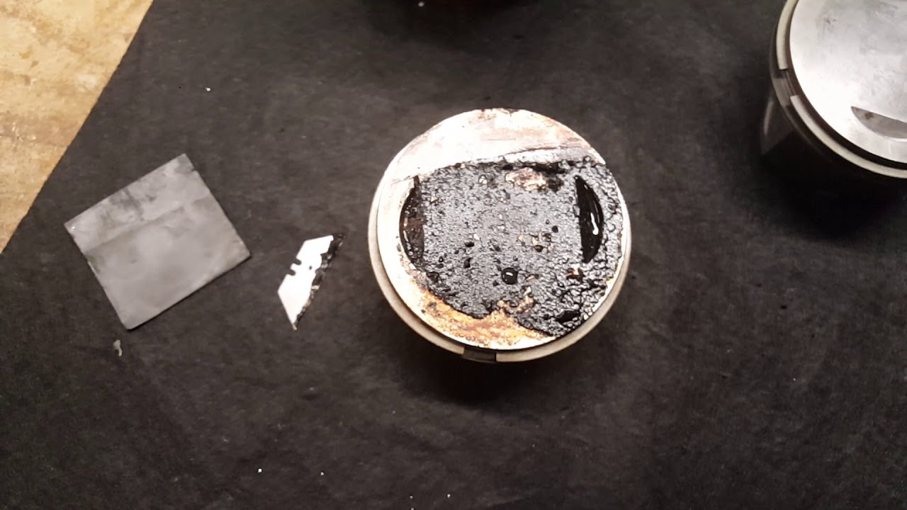

Think Carbon. Using a quality additive with NO added alcohol will help clean carbon from the combustion chamber. As carbon builds it raises the compression in the engine. This adds heat and the need for higher octane for the complete burn. Only you can pick the right additive and how often you want to use it. My adage to all of this is TOO much of a good thing is NOT always the answer;)
You will not get carbon with unleaded fuel. Leaded fuel used to build carbon on pistons and valves.
Sure you will, any oil that gets past the valve seal, the piston rings and thru the PCV system has the potential for building carbon. It may not be as pronounced as with non fuel injected engines but it is there. Here is 1 example
