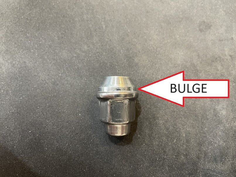

I’ve been around cars/bikes for many years and I’ve never heard of “bulge type” lug nuts…
Now that I have, I’d like to learn what the difference(s) are.

A quick description: a “regular” lugnut will usually utilize a 13/16” socket to install or remove… the “bulge type” which is used on the Trikes will utilize a 3/4” socket and will fit the hole opening of the wheel better, especially if using a thicker impact type of socket.
Although both utilize a 60* taper, there’s a little more contact surface area on the bulge type too.
