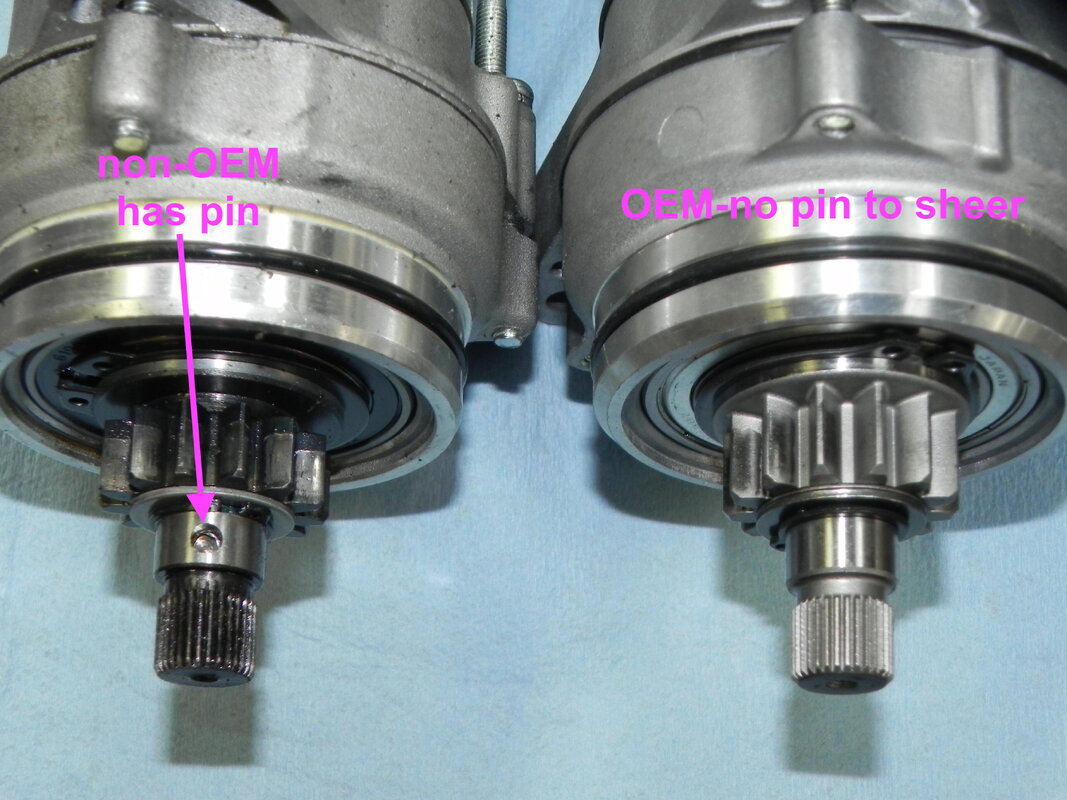

Good news ... installing an aftermarket starter can save a few hundred dollars.

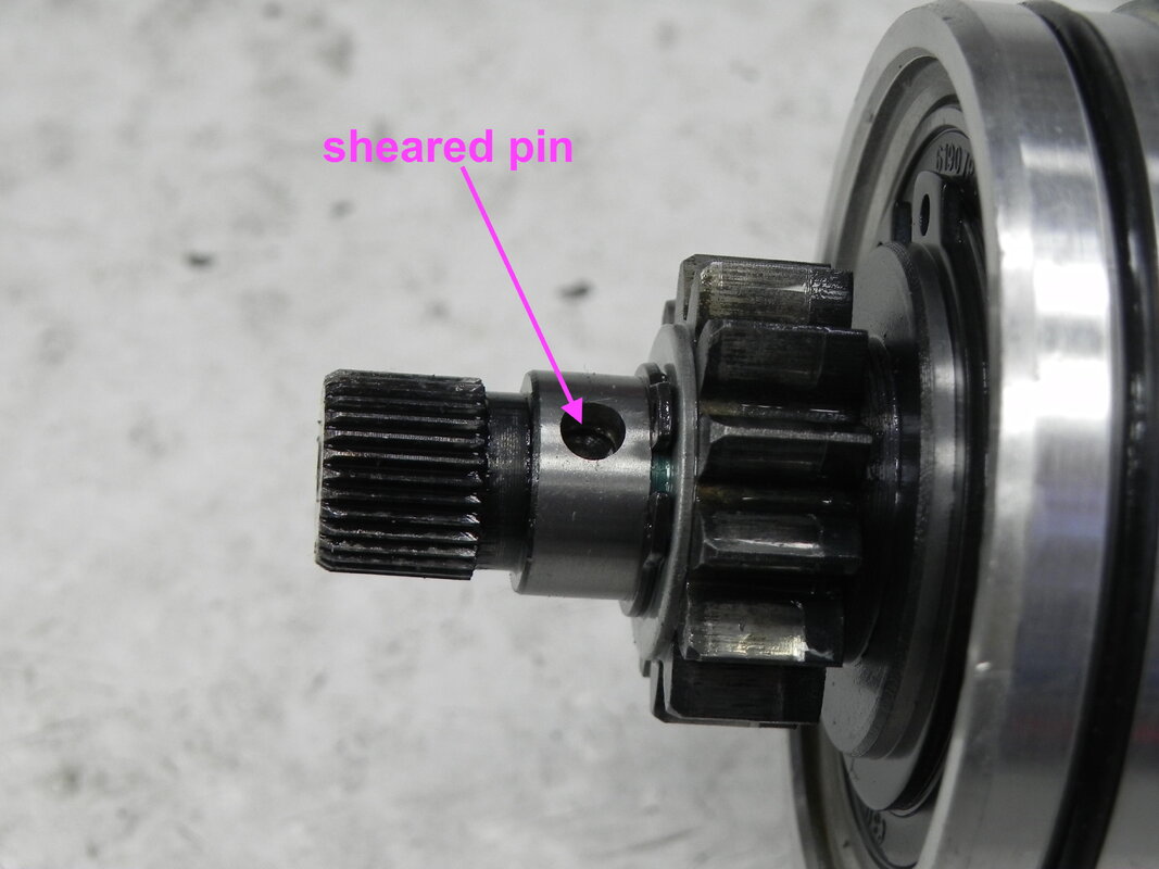

Bad news ... most aftermarket starters often fail shortly after, and some sheer their hold pin. If that happens, the engine needs removed and the metal found.

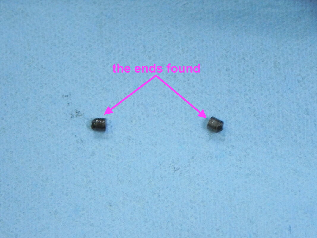

Good news ... on this one, with the engine out, and the rear case removed, the metal was quickly found.
Bad news ... if the metal is not found under the rear case, then the engine needs completely disassembled which quickly increases the repair cost by another $1,000 to $2,000 more.
Good news ... on this one he was lucky. Once the engine was pulled and the rear case removed, the lost metal was quickly retrieved. His bill was just under $5,900.
Bad news ... sometimes we have to do a similar repair when someone installes and aftermarket alternator.
The take away ... on 5th gens, if repair costs and down time are an important consideration, it's often far cheeper and quicker to install OEM parts.
