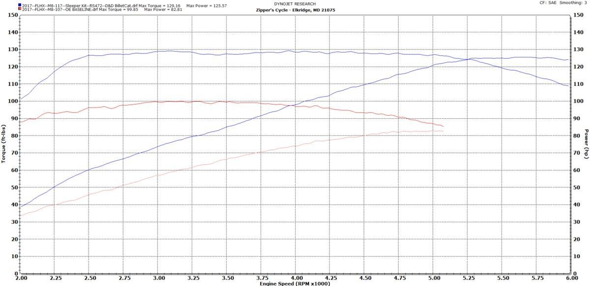

Zippers Red Shift Cam 472 - bolt-in grind for 114, 117 & larger M8
Work with factory valve train components, as well as modified heads with upgraded spring / valve combinations and porting.
A mid-range to top-end cam that maintains low-end torque. Cranking compression is only slightly higher than factory for easy starting
Quiet operation and long valve train life.

Found this to add to the study....
This is a great discussion of the M8 head's air flow and cam dynamics.... It is done by Zippers, so it is definitely a sales pitch for their cams, but it is also a good look into the engineering of the M8 heads and the needs of any cam design that aims to take full advantage of its design. Enjoy....:Dorag:
