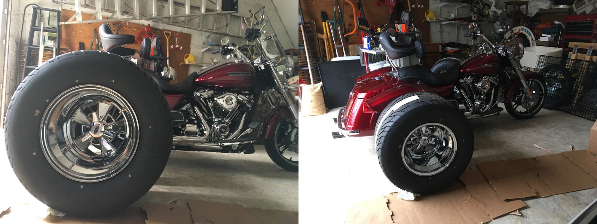

The bolt pattern on H-D trike rear wheels is 4x4.25" or 4x108mm. This bolt pattern was used on some Ford and Dodge products. Stock Harley trike rear wheels are 15Dx5.5W" with 2.25" backspacing. Harley Lugs are 1/2" - 20 threads. I verified this when I put my Cragars on.
So essentially any wheel that has or can be adapted to the 4x4.25 pattern will work. The adapter width can be used to manage net backspacing for wide wheels.

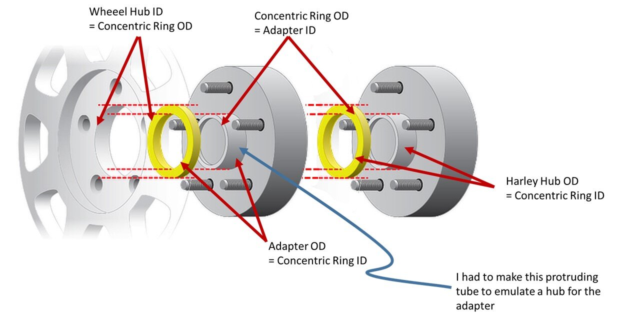

Hi Harrison,
No the Cragar does not have an HD wheel pattern, you have to buy and fit an adapter that bridges the connection between the 4 lug Harley hub and the 5 lug wheel. It works kind of like the illustration below I made for another member of the forum (except the Harley has on 4 lugs not 5) . There are details of this on the Freewheeler Chopper Project posts. Hope that helps

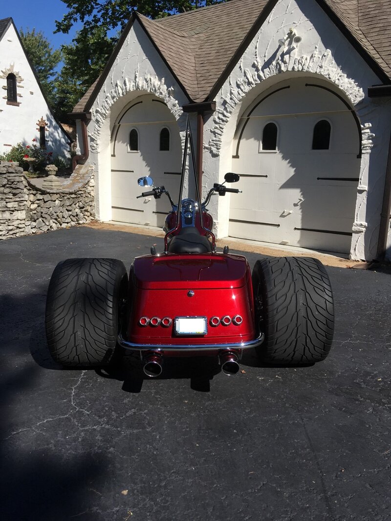

There is a wheel store on Page close to 170, maybe they could help. I would take them the stock wheel info from post #3 that Free Bird provided. Those tires on his are massive.

That is a REALLY good point. My tires and wheels were very purposefully put on my bike. As MDO points out they are unusually wide and tall (29x18). I worked for several months to design a way that would get them just right so they were not a degradation to performance (they ride REALLY nice). BUT ... There are trade offs for their installation. You are de facto carrying a passenger at all times as far as the bike is concerned as they are HEAVY. They also require the elimination of the fenders and stiffening of the wheel bearings (which voids the differential warranty). So the decision to go down this path is not a light one.

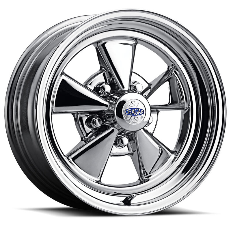

There is a narrow S/S 15X6 Cragar that may fit (albeit really tight) or fit well with some slight OEM fender widening and would work
But the same adapter issues need to be figured out and worked into the plan if you go that way...

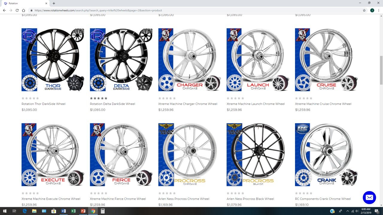

Here is a link to a web site that has many styles for trike rear wheels. Should give you an idea of what is out there as a bolt on option.
https://www.rotationwheels.com/search.php?search_query=trike+wheels&page=2&section=product
