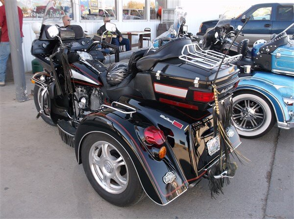

I'm running a 1989 tour glide ultra, I have owned since new. Carbed.ThumbUp I put in an E-27 cam for more uhmh and it runs 95 mph. top end. I want my engine more for longevity than speed. The more you do to an engine, the more you will have to do.
I seldom need more power, as it works very well in most conditions. pretty darn well two up and I'm not in a race? It runs highway speeds all day long pulling a small trailer.
I bought a Champion straight axle kit from Bazooka ( forum owner) at a great price and purchased a 5 degree raked triple tree from Zook also at a hell of a bargain compared to any other tree on the market. around $700.00 and the others have nothing on it for quality. The 5 degree makes it handle great one handed and is much more responsive than the tri-glide, I don't care what year?
My old glide had a natural 4 degree rake so I am running with an overall 9 degree, My god it responds quick!
I didn't put a reverse on mine, it rolls too easy. the tri-glide? not so much, Trying to push my friends tri is a chore?
I may be mistaken, but I think the tri has around 2-1/2 degree natural rake? I often wonder what would happen if someone increased it a might?
I heard talk of it here one time but lost track of the results if someone did it?
The kit was drop shipped through champion by fed-ex and I picked it up at the local dock, It could have been dropped at my door if were willing to wait a day or two?. Not to mention a way to unload it from the truck. At the dock they had fork lift to set it on a trailer for me.
I guess you could build a rabbit cage out the expensive box in came in?
Bill at Champion is a great guy and saved me allot on shipping.
To see pics of my build google- pcombe@photobucket.com
