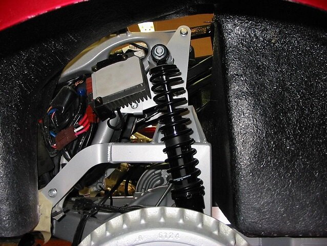

Second, check the coil-over shocks and make sure they have the same pre-load.

If it is a Monarch it has 2 coil-over shocks outboard. Need to remove the wheels to see them.

Howard did you see Jim's post where he said you have to remove the wheels to see the shock that can be adjusted?
Thanks ,Yes I did, but I can look down on the shock with the seat off. I haven't had a chance to take the tire off yet but I really don't know what I am looking for. Does anyone have a pic.
