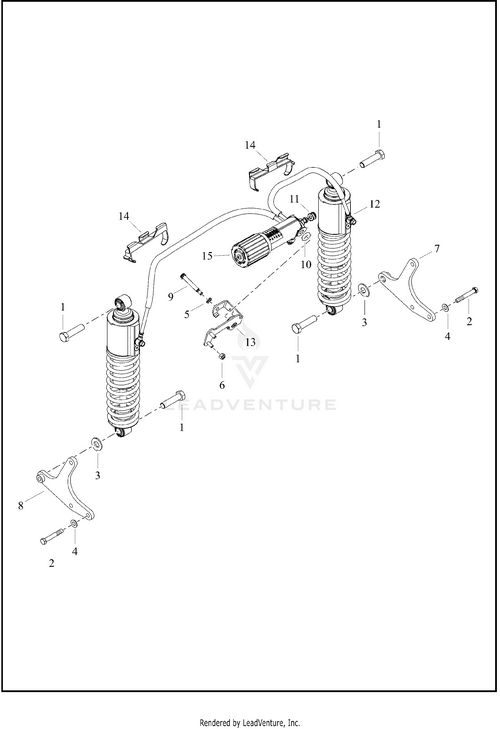

2020 Triglide and had to try HD's adjustable coil over shocks to see what I could get without adding anything. The ride was much improved from Harley's air shocks but still significantly less that Pro-Action shocks so added all the goodies I had on our 2017 Triglide.

You need to re-read it, he said his 2020 had coil over shocks, sounds like it was better than air shocks but still not happy, went with other shocks that he had on his 2017, pro action

They are coil over adjustable s
