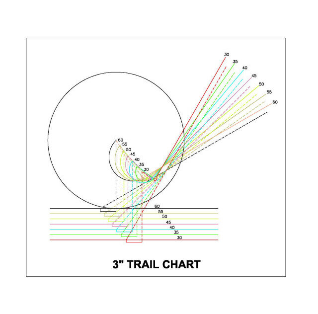

Jack, let's talk rake and trail one more time before the gas ax and frame jig come out....
I have reviewed a number of posts on the site and there is a LOT of debate regarding this topic on the internet in general. I wondered what your two cents was on final/net RAKE and TRAIL.
I have read a few different sources that say 44-45 degree rake is optimal for a trike but trail numbers run all over the place from 1-3 inches.

This will depend on looks vs function IMO One advantage may be raked triple trees to help with too much off set
Longer rake looks cool but many times you give up slow speed maneuvering and a smaller contact patch( trail) JMO
I believe your stock rake is near 26 degrees, I would look for 35 degrees of rake and 3 of trail for easy steering and stability
The trike is headed up to the frame and fab shop this week for the long awaited choppin. She will get hacked and goose-necked and raked out to get the rake and trail of a trike plus all the mods for the streched fat bobs, panhead buddy seat, floorboards, fenders, boat tail fairing and trunk etc.
be aware if you rake it out you are increasing the trail which will make it harder to steer

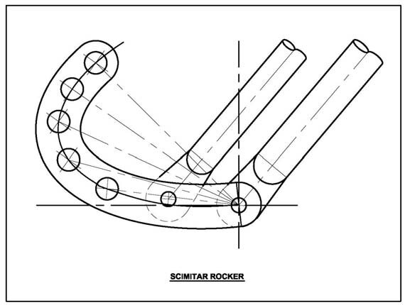

You can have the look AND the handling if you design rockers to get you to the optimal R&T
This sketch above shows how 'Scimitar' rockers essentially work. In the old days it was done mostly by experimentation. But Ed Roth published a tech article on rake and trail in early 1969 that defined the math. This is one reason that Ed Roth is held in such high esteem. He always openly and unselfishly shared whatever information he came across. The diagram below is a CAD copy of a chart that relays what I am trying to accomplish. This particular chart was set up to determine the rocker geometry for forks where you want to maintain 3-inches of trail regardless of what the neck rake angle happened to be. On the full-scale chart it was easy to interpolate down to 1-degree of accuracy.
Those semi-circular arcs you see drawn between the axle and the rear pivot pin hole having nothing to do with the rocker shape but are there just to make it easier to understand what axle locations go with what pivot location.
In the end, these dropped rockers give the rider the impression (perceived feel) that the bike has less trail than it actually has in reality. Sugar Bear's LONG springers used this principle very successfully. Some people say that riding a a Sugar Bear bike with dropped rockers is like having 'power steering' in that it takes very little effort to move the front wheel. Basically what is happening with a set of dropped rockers is that you are 'tricking' the steering geometry into thinking that the bike is running a much smaller diameter front wheel that is set much further forward than the physical reality of the hardware.
Anyway, that is the idea. If I can get to a target rake/trail, it can be engineered into the geometry of the frame neck and rocker combo.
You can read much more about this concept at the Chopper Builders Handbook web site (an awesome source for ideas if you are into choppers) Here is the link:
https://chopperbuildershandbook.com/rockers.html

a couple things come to mind.... the line in these sketches are the center of the headset or triple tree pin and NOT the fork itself
i have found when the axle is about and inch or so above the pivot they ride pretty good
in the case of the dropped rocker, dont let the curly cue rocker fool you...
the lower the pivot the less the suspension can work... example if the axle right above the pivot the only time it will work is if you run into wall or deep pot hole... because there is almost no vertical travel.
if you go the other way with the axle below the pivot ... this can be just as bad.... for example if the axle and pivot are in line with triple tree pin you might as well put in a solid bar... think about pushing a wheel barrow over a curb... its easier pull than push it and the higher your hands are the harder it is to push over the curb and easier to pull

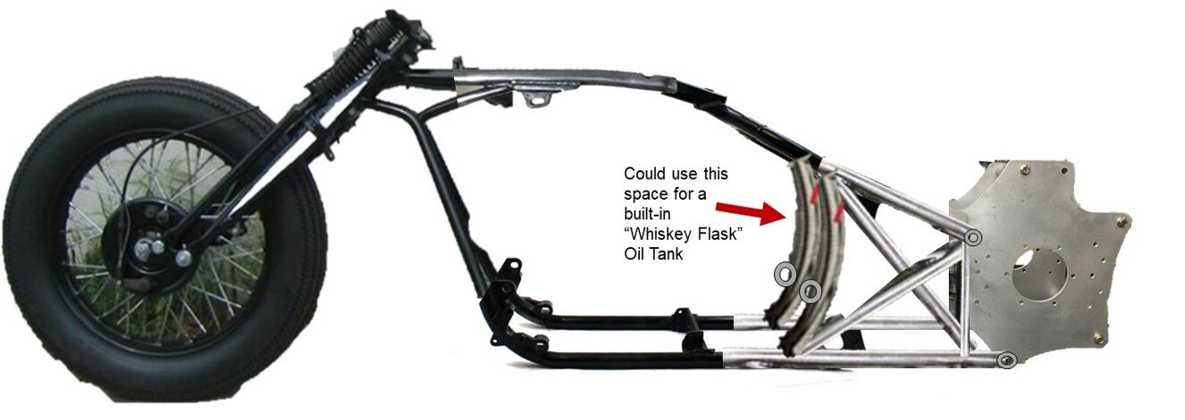

Well I finally got the trike to the chop shop yesterday for the frame mods and chassis work. I took the trike and a pick-up full of parts to Just Hawgs in St. Louis. Great "Old School" shop.
We will cut out the backbone and replace it with round tube for locating the stretched fatbob flatside tanks. We will replace the swingarrm castings with tubes that will accomodate rear motor mounts and then weld in a hardtail that will pick up the rear axle attach points (No shocks needed on the frame as the independent suspension is part of the rear axle). Then we will cut the downtubes at the front motor mounts stretch the new downtubes and fab the goose neck. The VIN will be cut out of the original neck casting and welded into the new neck to keep the DMV happy and serene....
I have not decided whether I am going to go with a round pill oil tank (like the paint concept photo below) or make a built in tank (whiskey flask style). I really like the look of the open area above the tranny. Looks very clean. So I am leaning in that direction.
Here is the idea...
Now you know why I am painting the logo on the tank as:

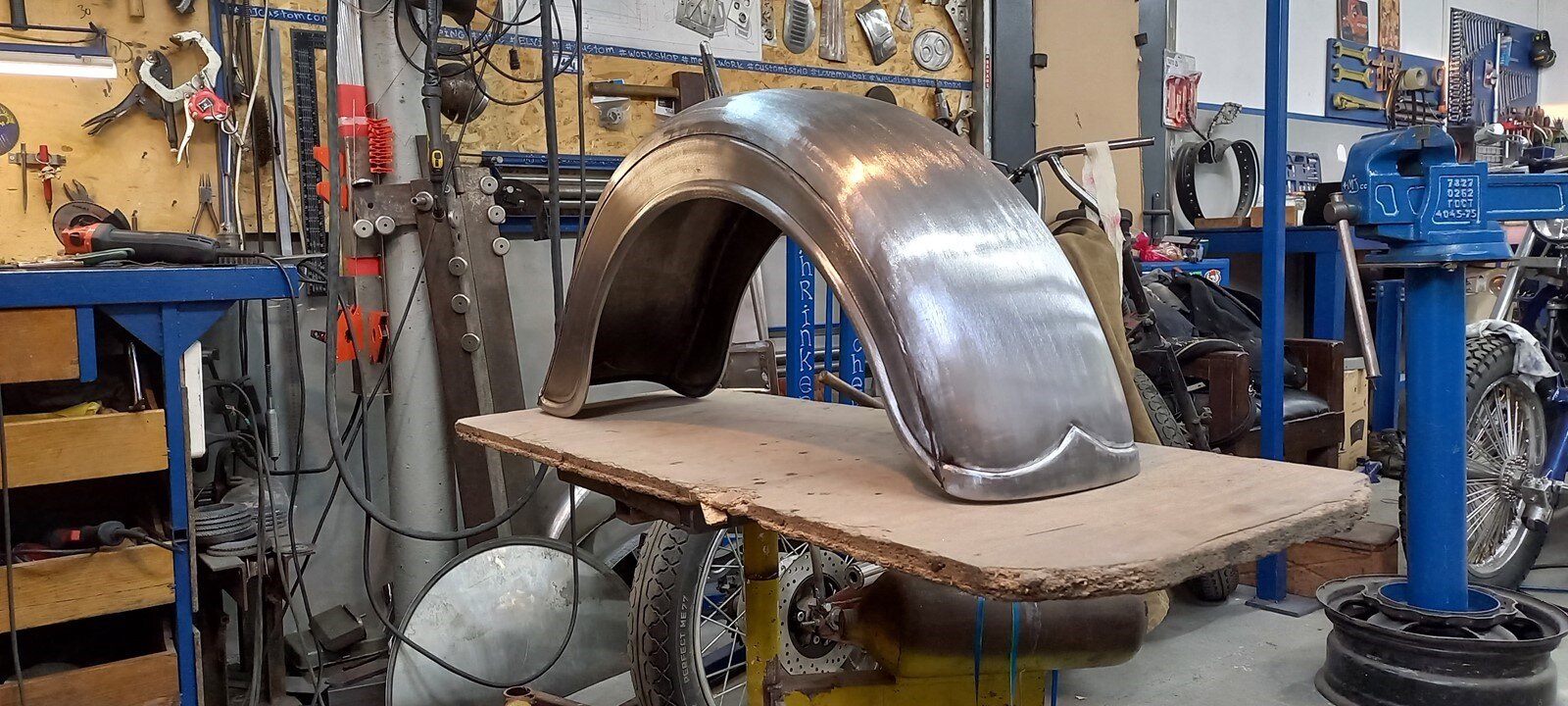

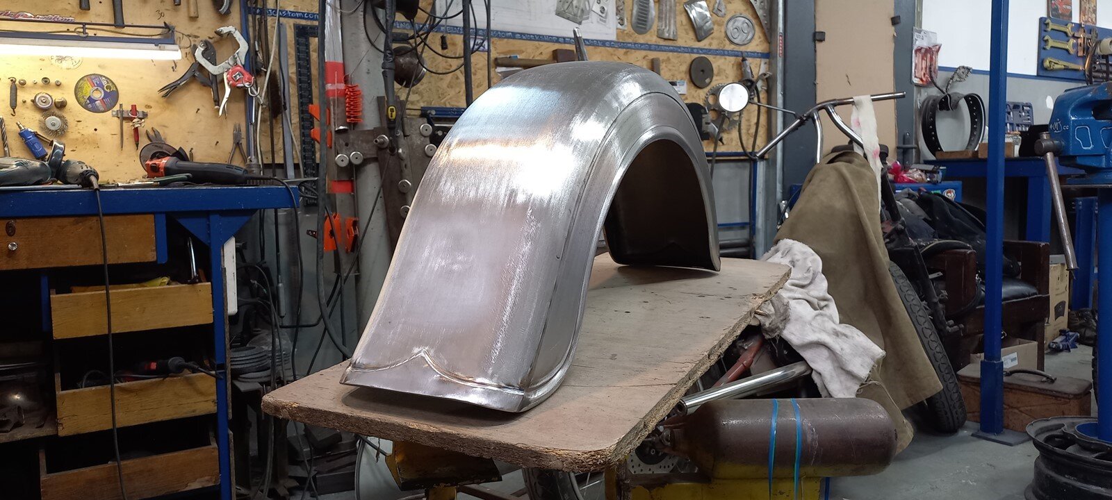

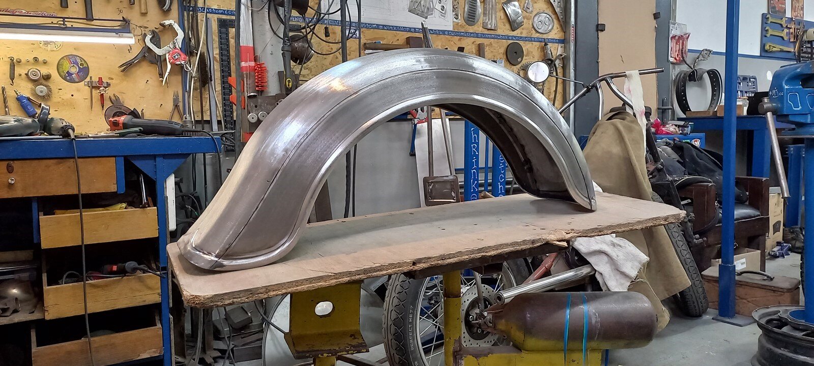

Front Fender

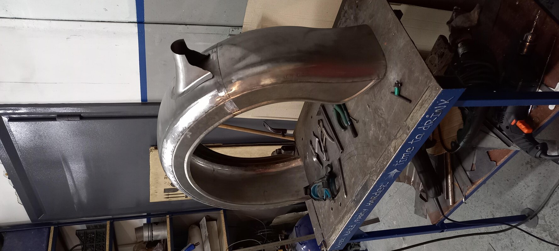

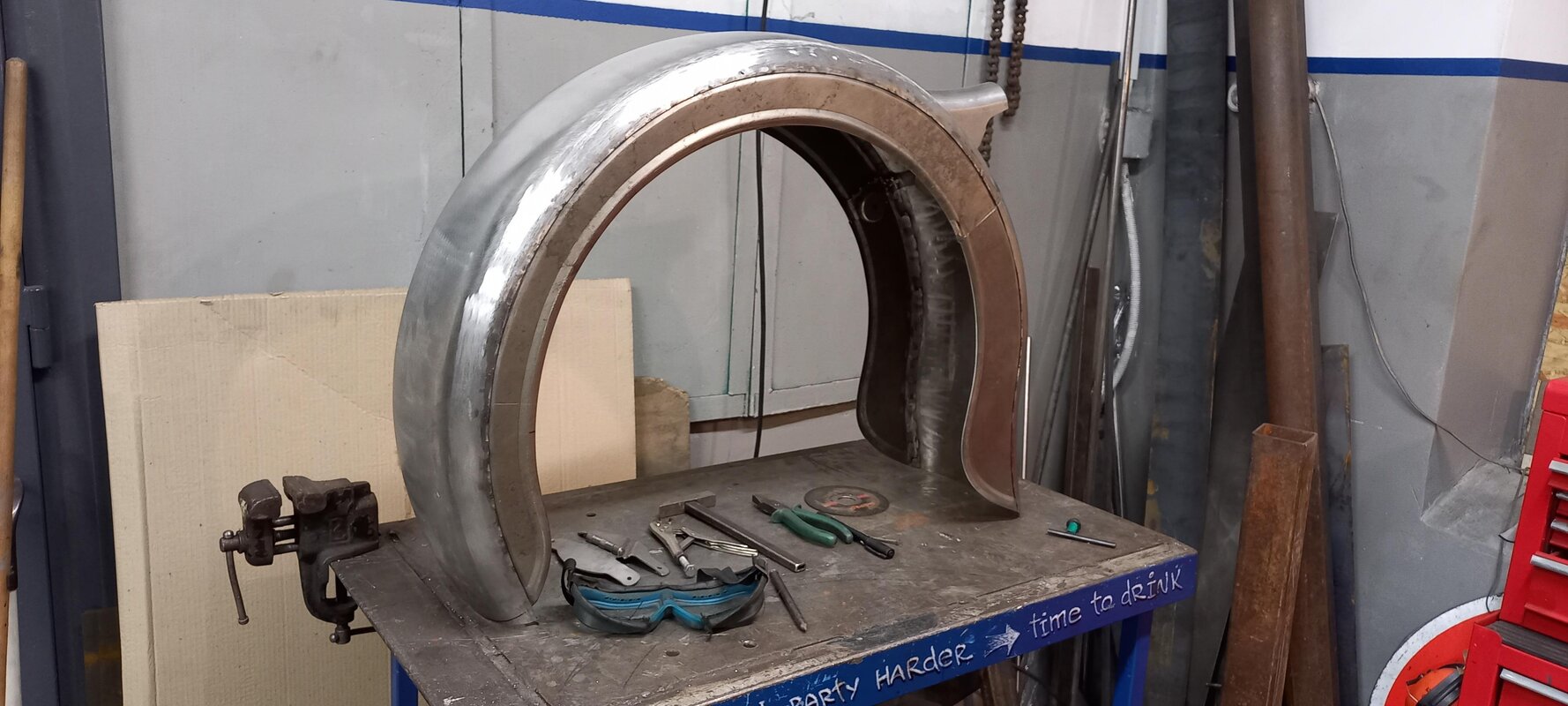

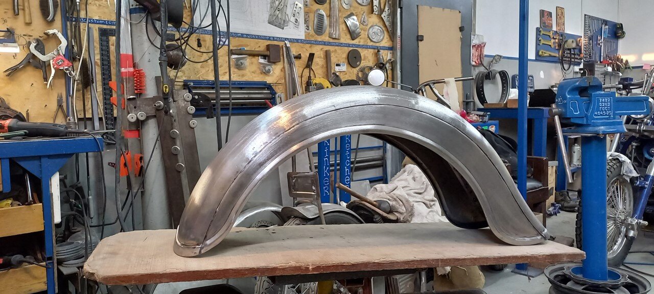

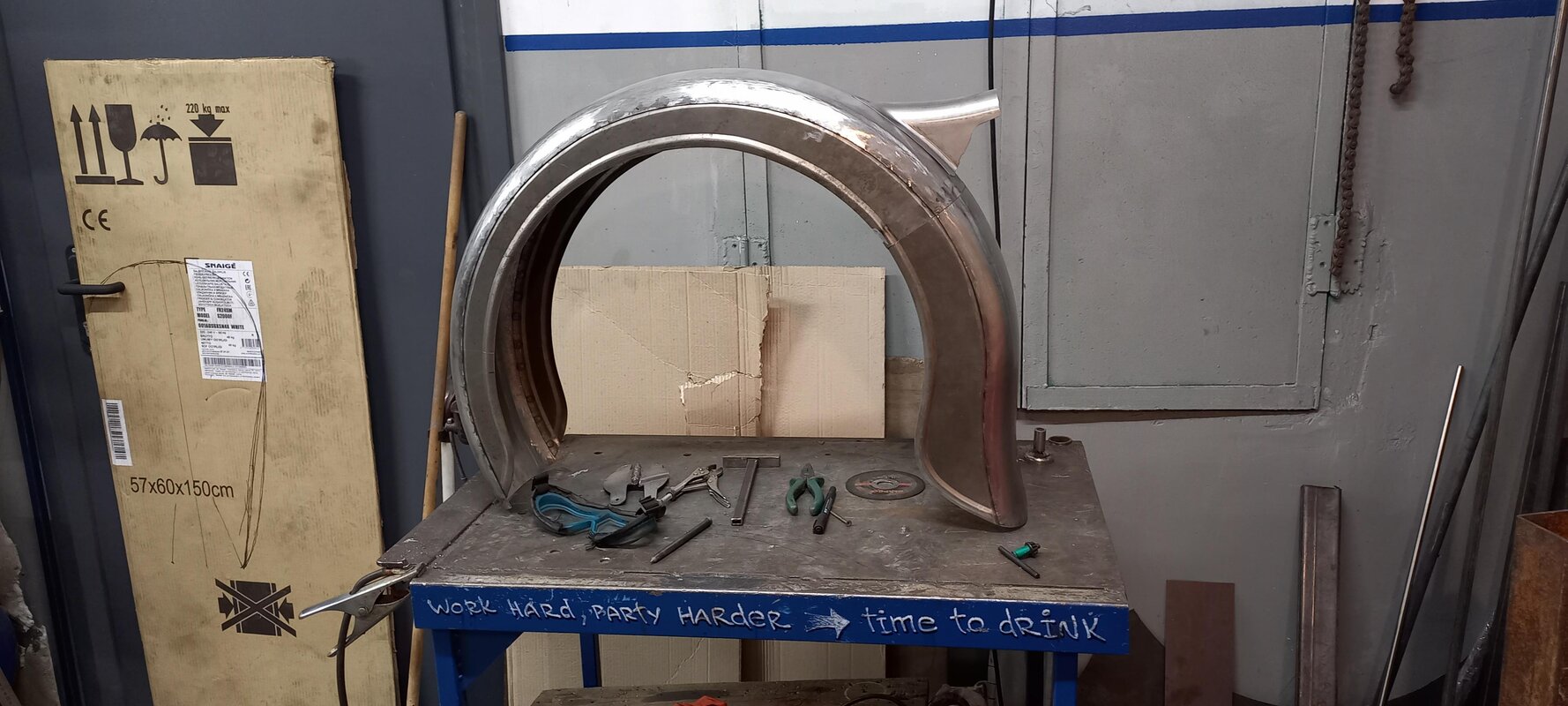

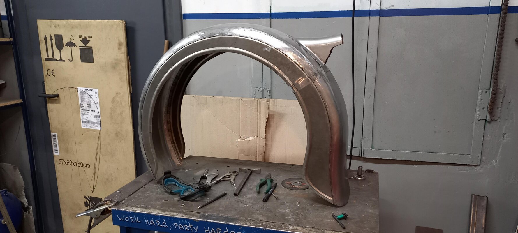

Rear Fenders (Almost Finished) - Using Reproduction 37 VL tail lights
Sorry for the sideways view....
