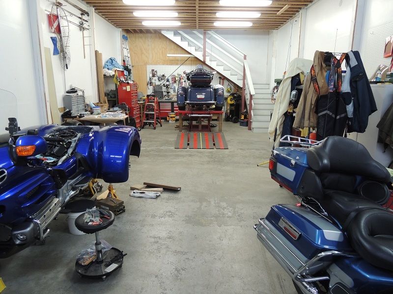

There is a lift available, but my brother "SEAlaskan" HOGs it.
In his defense, it is his shop.

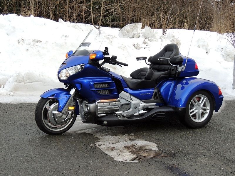

Yesterday, got the trike out for it's first ride of the year. The streets were a little wet and the temperature was about 36*F.
Some first impressions:
- I feel like I'm forgetting something. (Seat Belt?... Kickstand?)
- My Wife likes the idea that she can get on and off without me being there to hold it.
- The running gear seems smoother since I went through it.
- Have to approach potholes a little differently.
- Don't have to worry about the gravel at the intersections.
- It didn't get as dirty as I expected and seemed easier to wash.

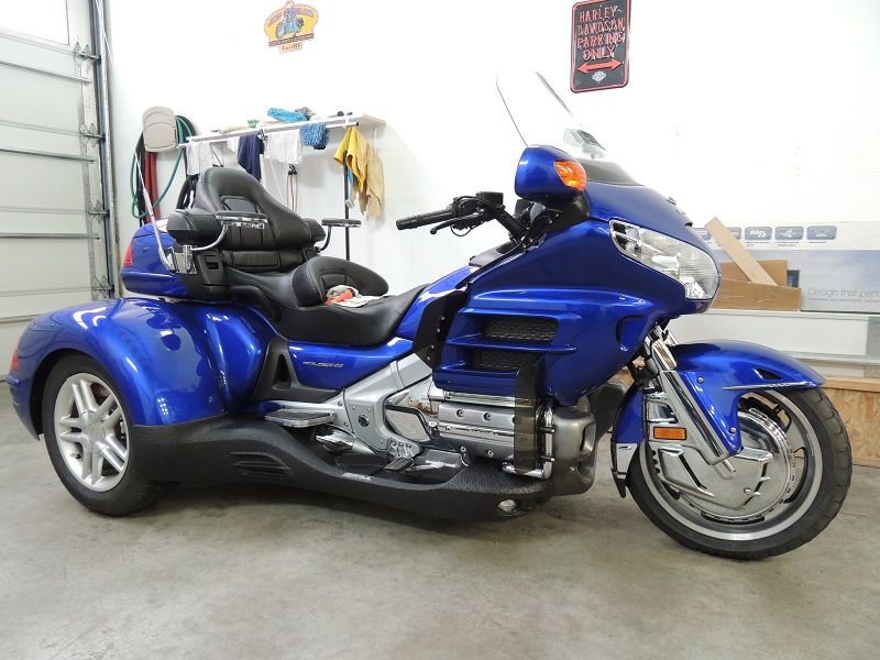

Added the Trike Wings and a fender extender.
Took it for a short ride. Some of the roads were wet from melting snow and there was still some ice on the road near the glacier. The Trike Wings did help keep a lot of the road spray off the rear fenders.
The trikes looking good.
Beautiful, I love the color and now you have a trike you know you can depend on. Just watch the wide rear end when you are getting close to fuel pumps, and ride safe.

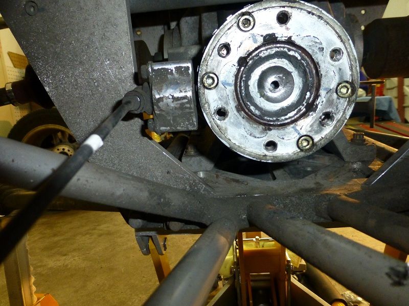

Jackpoet, I didn't know what a Delrin Disk or a rzeppa joint was until I looked into doing this project.
Delrin is a registered trademark for a crystalline plastic that has good wear and abrasion properties.
The disk fits in the center of the adapter (see picture) and serves a duel purpose.
First it provides a wear point for the tail end of the drive shaft. You can see in the picture where the drive shaft has been wearing into the adapter.
The drive shaft is connected to the rzeppa joint (CV Joint) with a snap ring. The disk forces the drive shaft forward so that the bearings in the rzeppa joint are centered and also pushes the front of the drive shaft further into the yoke (universal joint assembly) for a more secure connection.
Not the best explanation, but I hope you get the idea.

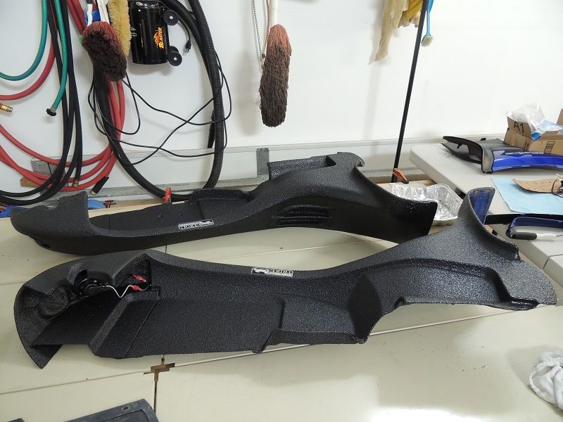

Chose to do the repair work on the running boards myself. Figured that they were going to be covered with a spray-on bed liner, so didn't need to be as perfect.
[/QUOTE]
What brand of spray-on bed liner paint did you use??
Re: Body/Ground Effects Repair
I don't remember the name of bed liner, but it was one of the few options I had in my home town. I see a lot of folks have had good luck with Line-X, which is probably sold in your area.

I like things that are functional. To have running boards that are not usable is like having a pretty woman in a glass case. Nice to look at but not good for much else.
I did some work on my running boards to make them weight bearing and added the Comfort Controls to put the rear brake and shifter down and forward. This allows me to put my feet where they are more comfortable.
It actually does make the trike feel bigger or more roomy.
I like the idea of coating the Aqua Shields, Wing Boards or what ever your running boards are called with a product such as LINE-X! ThumbUp
Not only for the protection it provides, but in my opinion it looks great as well! ;)
