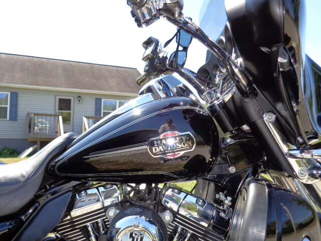

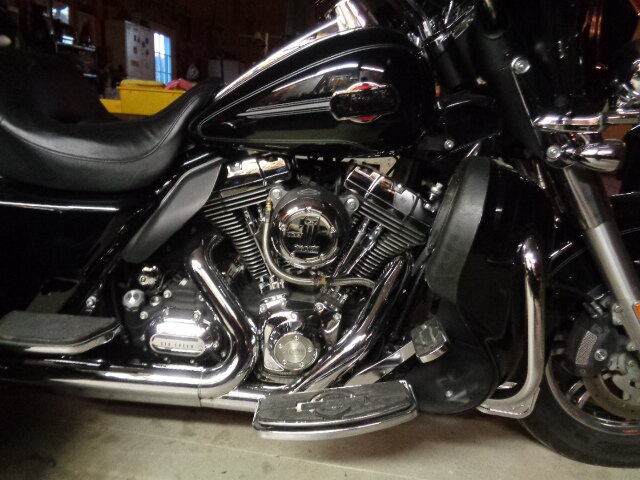

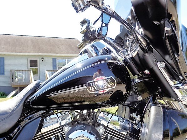

when I installed the tank lift and deluxe option, I slid the tank as far to the rear as possible, didn't want to get anything hitting. This caused the front of the seat to be a little cramped in the crotch. I reset the road pegs, which helped but still I did not like the feel. Well I was willing to take the deluxe out and get the seat back to normal. I got the front tire off the ground and loosened the lift brackets. I kept moving the tank forward and rotating the bars from side to side and checking for clearance. I was able to move the tank all the way forward and had enough clearance that nothing would hit. This took care of the cramped crotch and as a side benefit lowered the amount of air coming over the tank. Jim

Luckily, I had enough clearance with the deluxe option slid all the way forward.
Because of the bars I have, all the stuff hanging off of them, and that I have them pulled back toward me...I barely have enough clearance, and that is with the tank slid all the way back!
