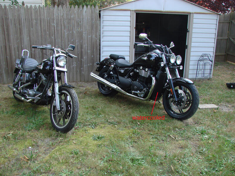

My 2011 Triumph Storm 1700cc was water cooled and in 24,000 miles no one ever paid any attention to that radiator. You could idle all afternoon in a traffic jam on a hot summer day and not even think about overheating. That would have made an awesome trike if I hadn't wrapped it around a telephone pole. If Harley made a proper water cooled Freewheeler I'd trade up in a minute

Harley had a full water cooled engine, (V_Rod) but the Harley snobs wouldn’t buy it…

I dig your Troublehead, is it a FXE? I see a kicker on it
