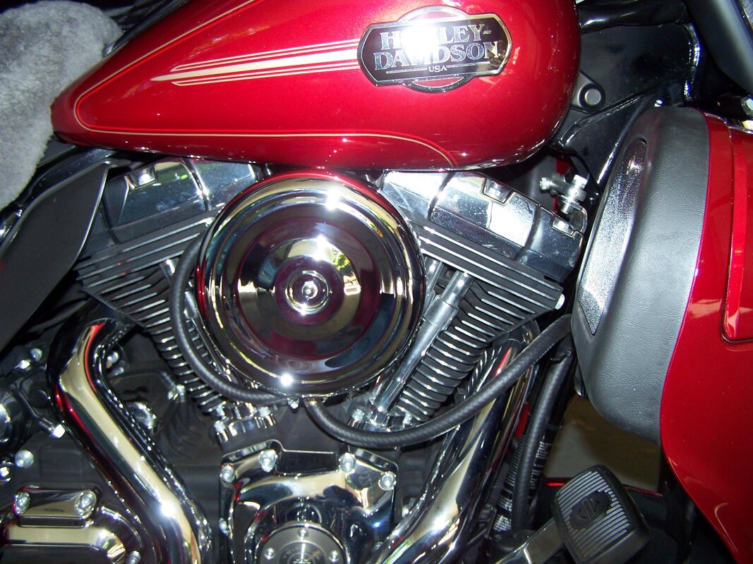

The first pic is from yesterday when I quit because of the heat. You can see the tubing too far to the left of the filter cover.

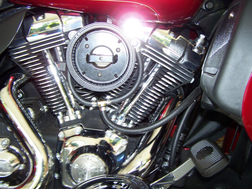

The 2nd pic is after I changed the tubing so it ran inside the left part of the support bracket.

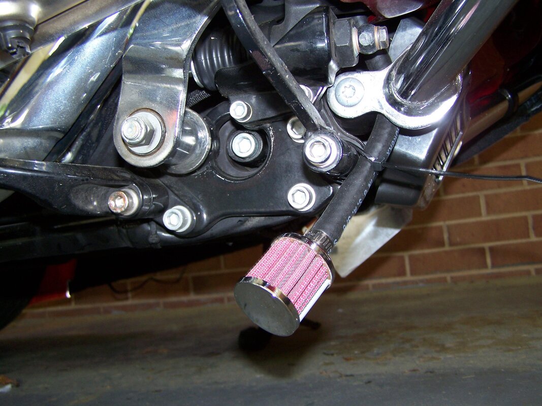

The 3rd pic is the filter and its location near the front of the frame.

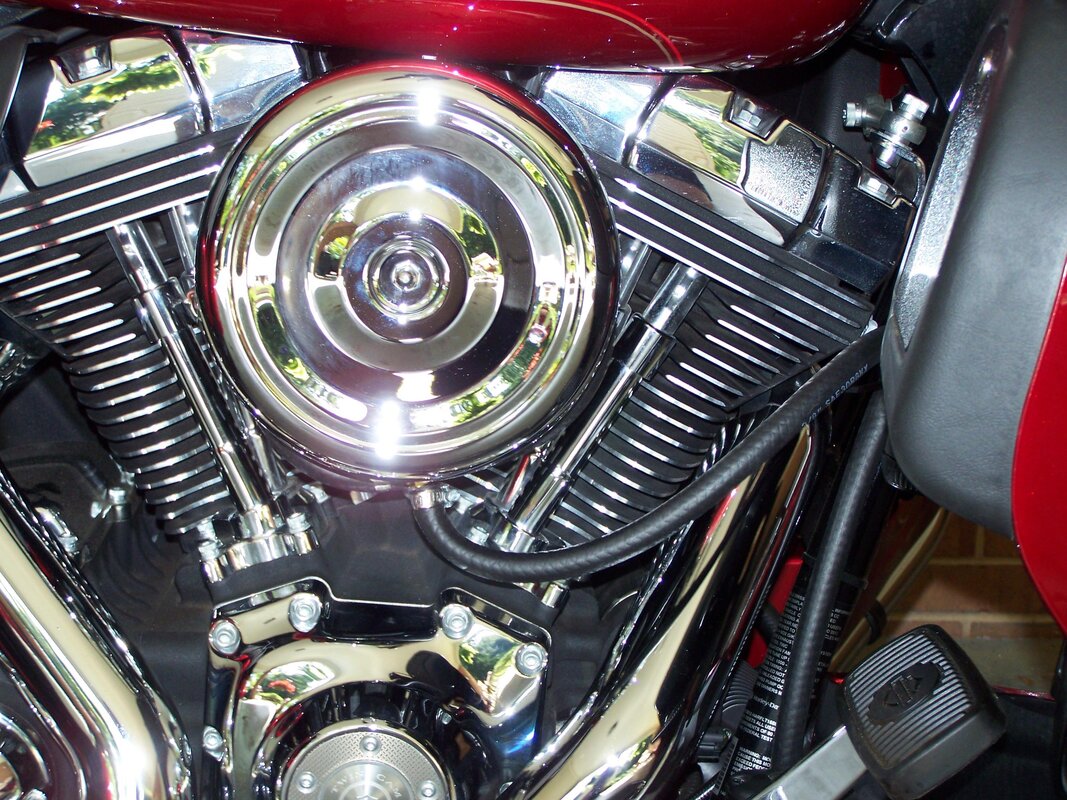

The 4th is the finished look after changing the tubing.
I think the tubing could be shortened even more at the T connection but for now I am going to leave it like this. I first tried to run the filter tube to the rear just in back of the trans cover. I decided against that as I was afraid it would rub on the exhaust.
I am all ears if anyone has a suggestion on another location for the filter tube.
I can change the position of the filter hose so that it does lead angled downward zip tied to the front of the frame.
I don't know how much oil to expect to be discharged from this system?
I am glad you brought up the filter hose angle. I was so focused on the 2 side hoses being closer to the filter that I overlooked how I had the filter hose. Tomorrow I am going to see how I can reroute it to be more effective.
The stock filter I removed (6500 miles) was dry as a bone with debris in it. There was a very light oil coating on the back of the filter mating surface to the support bracket and that was all. Mine is older than yours so yours should be more clean than mine I would expect. I haven't seen any oil drops at all.
I am now wondering how long this filter at the end of the hose is expected to last?
