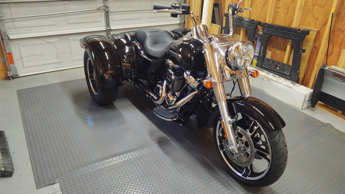

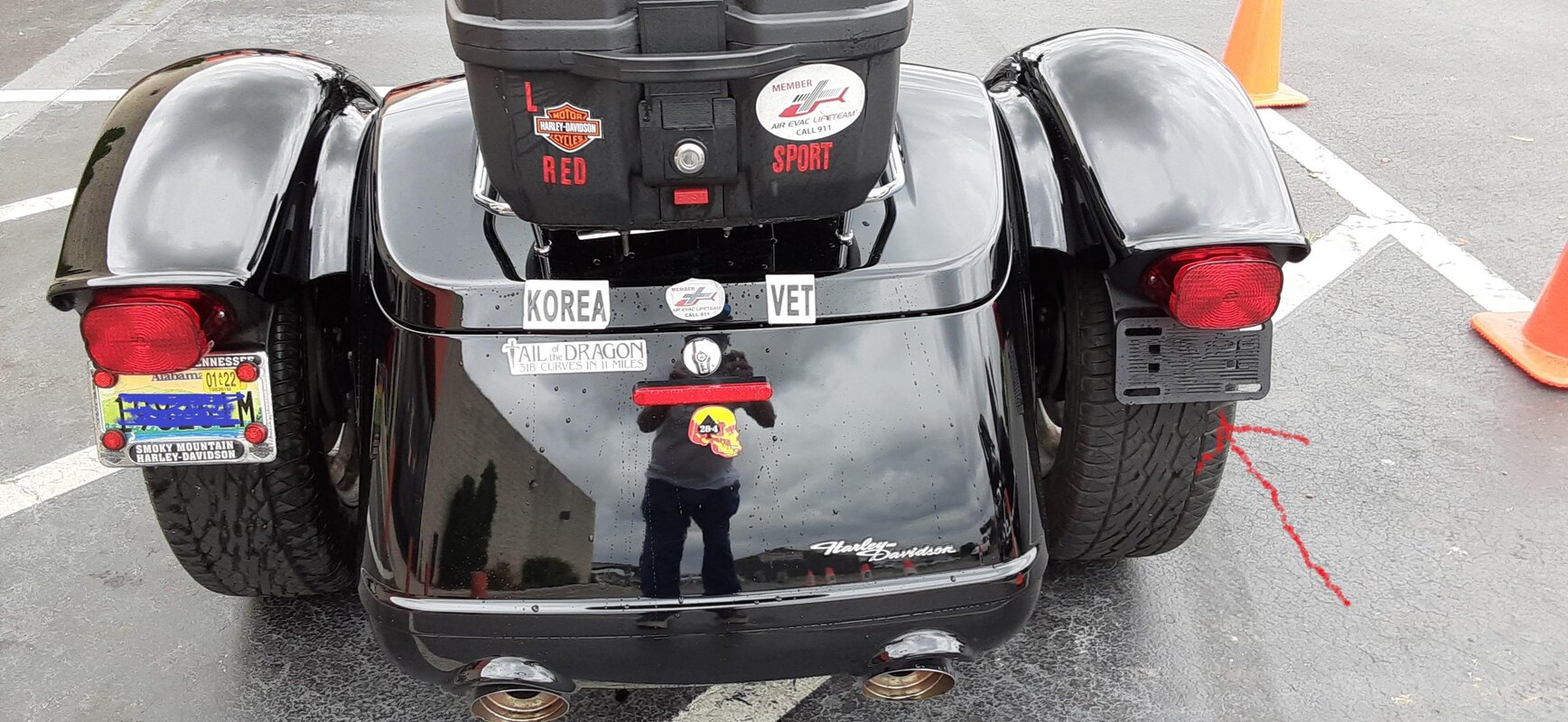

Added license plate Bracket (#67900187) to Right fender, My group riders was making me ride in the rear said I was throwing rock at them. My goal is finding mud flips (pow) that will fit. Can't find those red bolds with wing nut on back like the L side, still looking. Had dealer order it & put it on a little over a 100$.
Up Date: HD Dealer has the red bolts with wing nuts.

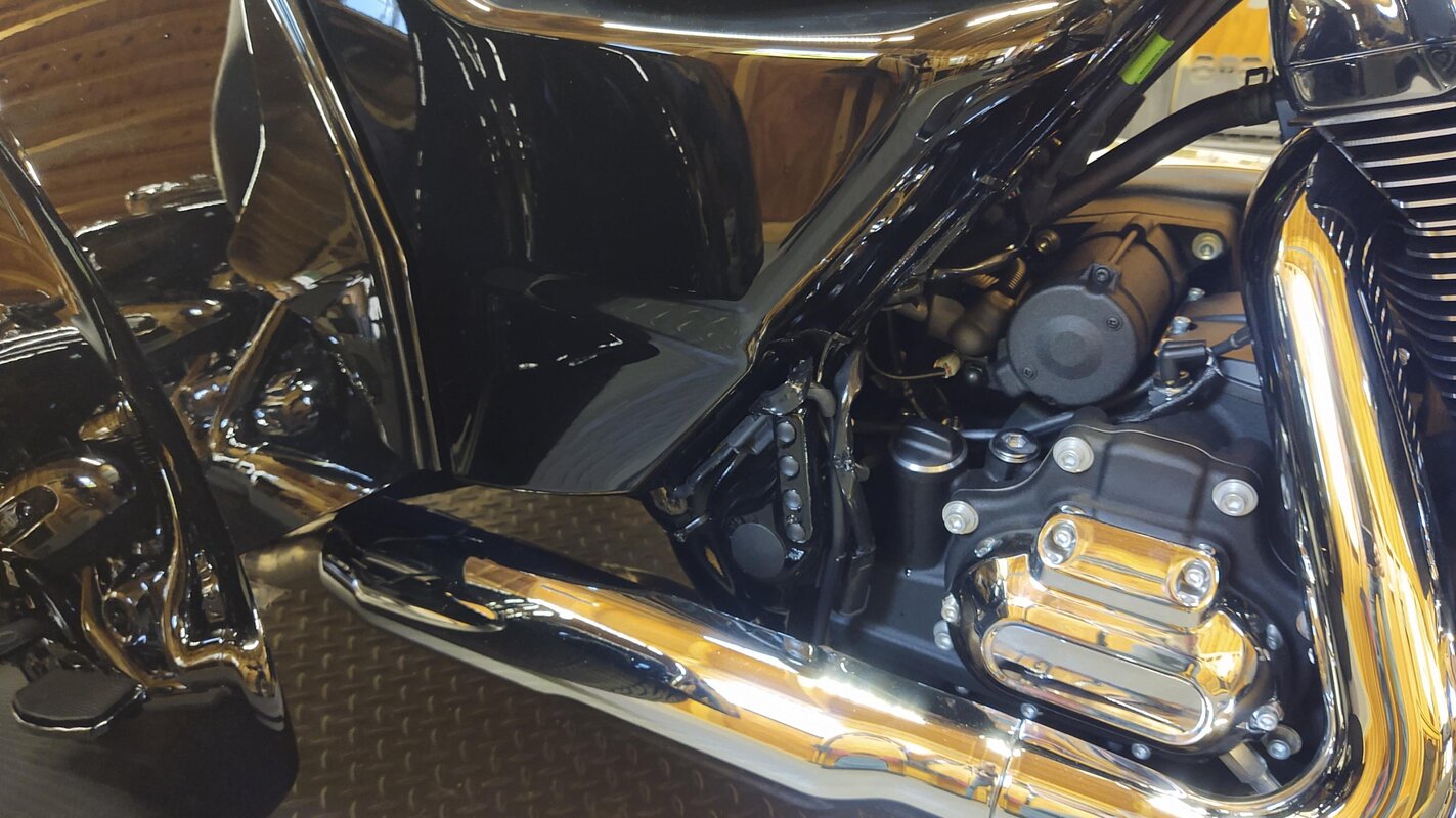

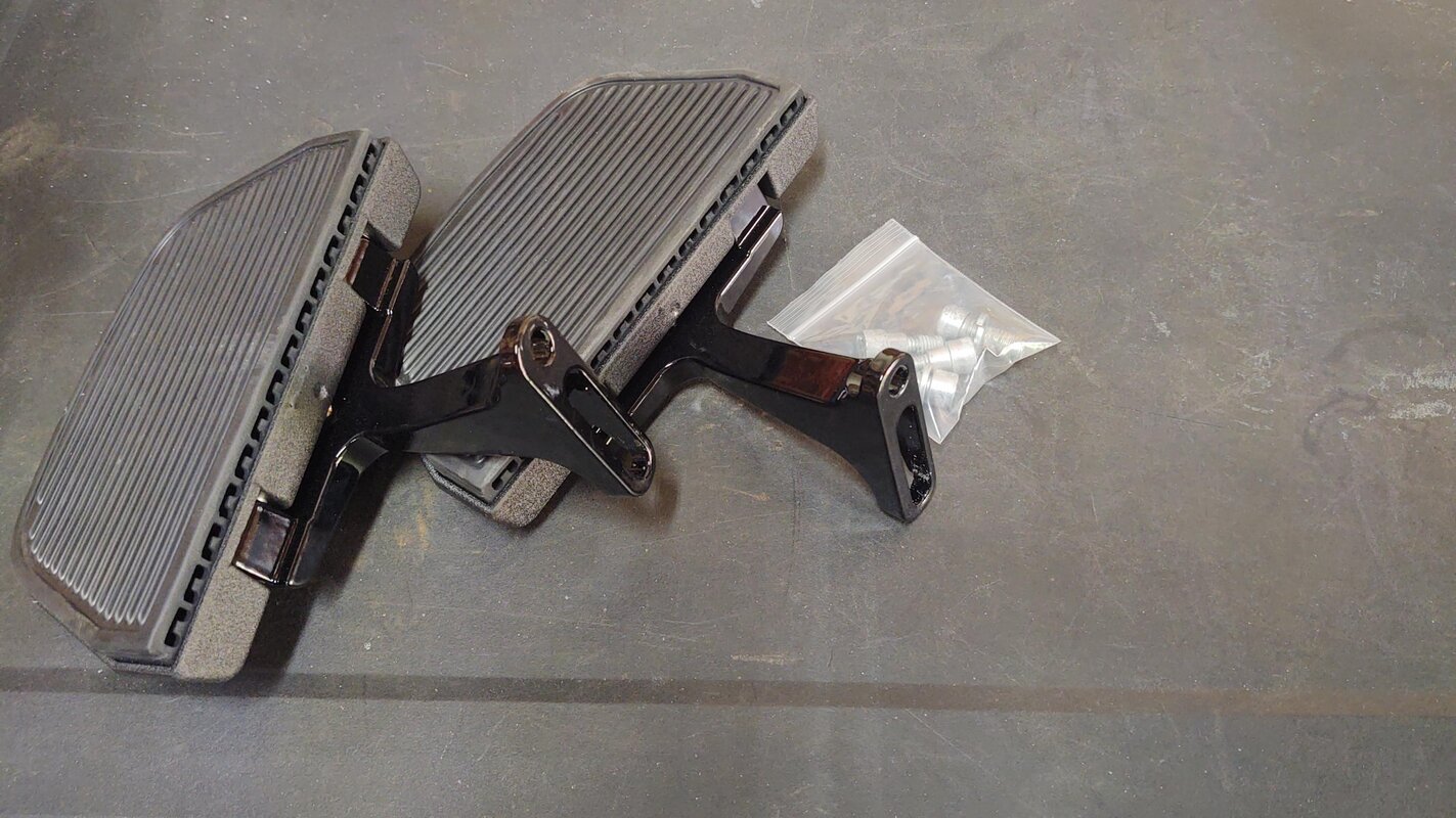

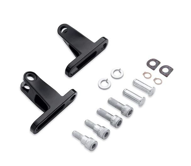

Took off the passenger floorboards. Wife can't ride anymore and I'd just as soon not carry a passenger anyway. Filled the 4 bolt holes with 5/16" hole plugs from Lowes. Eventually going to install a standard set of black rubber passenger pegs from Harley just in case somebody really, really wants to go for a ride.

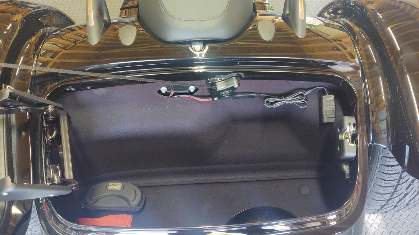

Phone Charger

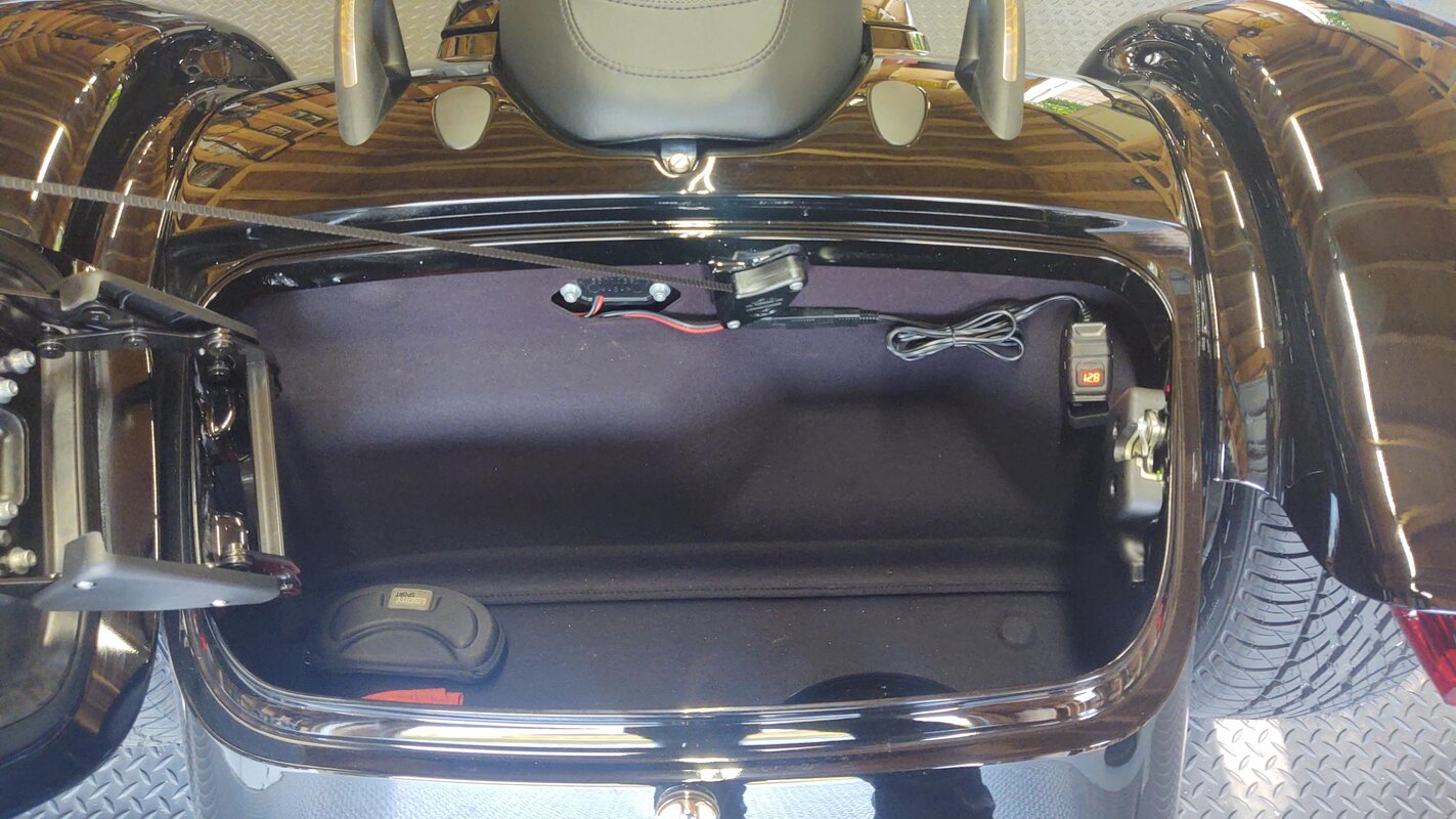

Re-routed the battery tender connector with an extension into the trunk of my Freewheeler and plugged in a dual port USB adapter that turbo charges my phone. I would have preferred to get the Harley versions, but they weren't in stock. The USB adapter has an on/off switch and displays the voltage output from the battery when on. Hopefully it will work out. Need some way to keep the phone on when out and about.
This is in my Freewheeler trunk. The picture is sideways but the plug is not.
I was thinking of going that route. It's very clean installation. I didn't want to have to keep removing the left side cover and unplugging wires to connect my battery tender when the time comes. Just figured it might be more convenient to have everything in the trunk. Battery tender and all. Guess time will tell.
I don't understand why you have to remove the left side cover and unplug wires to connect your battery tender.
The USB port is plugged into the battery tender wire which, in my case, was stored under the left side cover. Should I need to plug my charger into the battery tender wire I have to pull the left side cover, unplug my USB port and attach the charger. When I'm done I'd have to unplug the charger, re-plug the USB port and put the side cover back on. With the battery tender connection in the trunk I just have to open the trunk and everything's right there. Or so goes my thinking anyway.

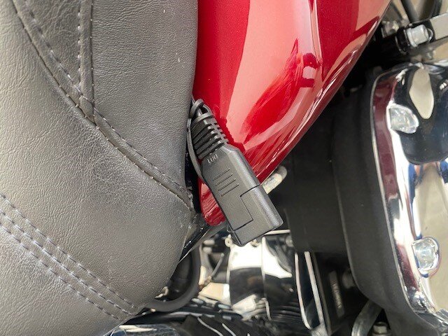

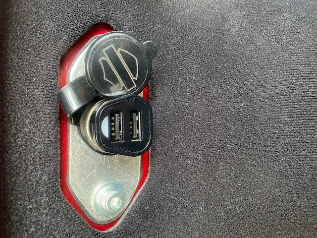

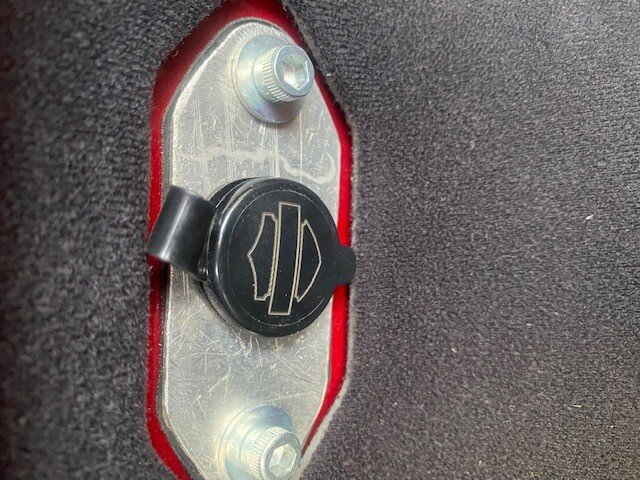

My USB is plugged into the Auxiliary Power Port, HD Part Number 69201099. I bought it 5/02/2017, so that may have changed.
My battery tender is readily available at all times. I can use them both at the same time, if I so desire. I had this set up on my 2015 Freewheeler. This is a close up, it's not that obvious when looking at the trike. I am not saying my way is better, just sharing information.
I like your idea. It eliminates having to disconnect the USB and would leave the battery tender available, but I didn't see any kind of auxiliary connector under my seat. Maybe I'm just not recognizing it.
