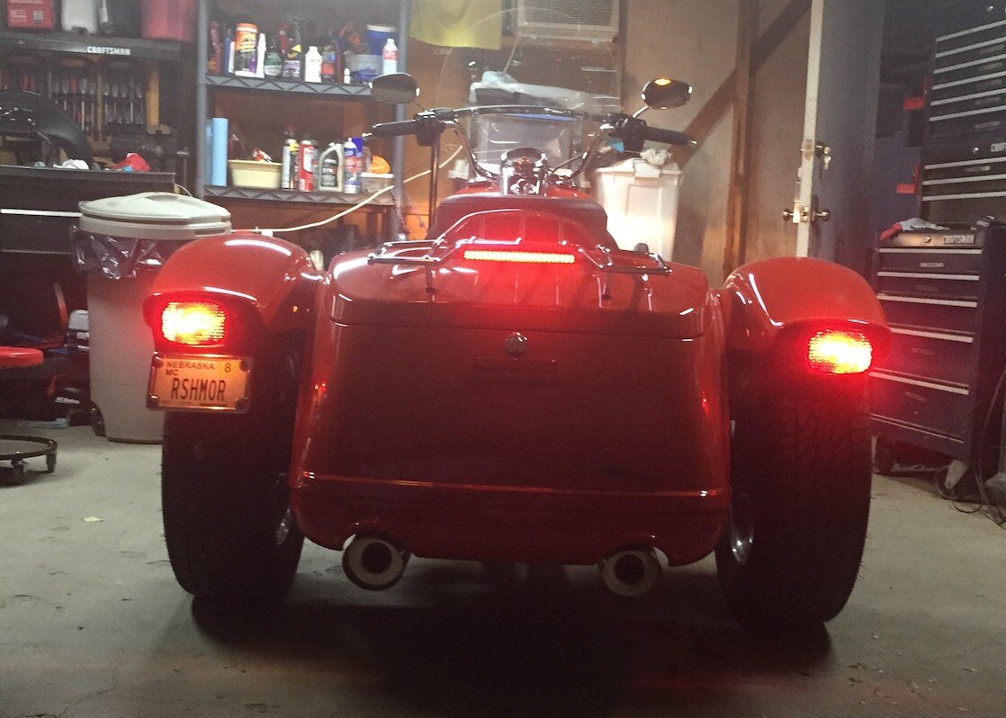

I went with Custom Dynamics LED inserts with my front turn signals and love them and have gotten numerous positive comments. I did change to clear front lens covers for maximum visibility.
While your ordering, I highly recommend their brake light modulator that gives you like 10 different options for brake light patterns and that greatly increases visibility while stopping. I have tried them all, but went with a pattern that pulses 7 times when the brakes are applied, goes solid for about 3 seconds, then repeats. I have had many positive comments on it also, with followers saying it really grabs your attention. The brake modulator is plug & play on the Freewheelers and only takes a few minutes.
Let us know when your done with your mods and how you like them.:cool:
We think alike. I had Custom Dynamics Pro Beam front turn signals on my Low Rider, I swapped them to the FW when I bought it. Also put on CD's LED tail lights and installed the modulator at the same time.
One of these days I need to spring for an LED headlight.

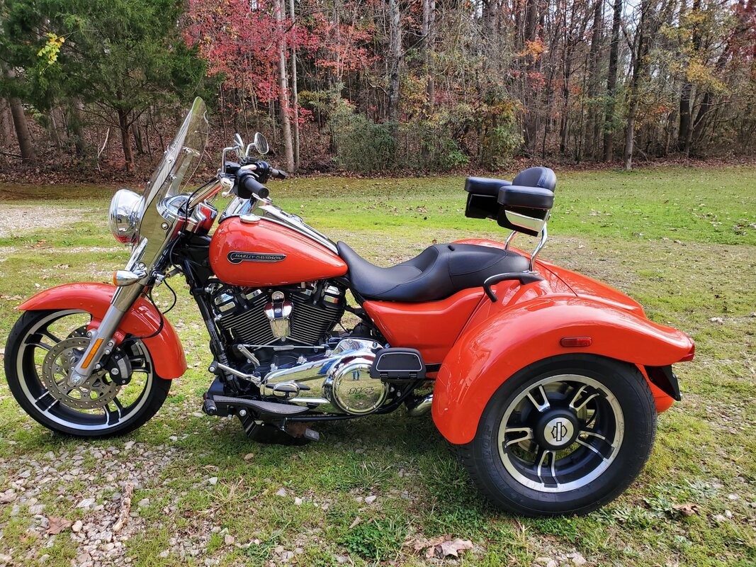

Ordered a 15" light tint windshield from Freedom Shields for my '19 FW.
Please let us know how you like the shield after you get a chance to test it, and we will of course need pics.

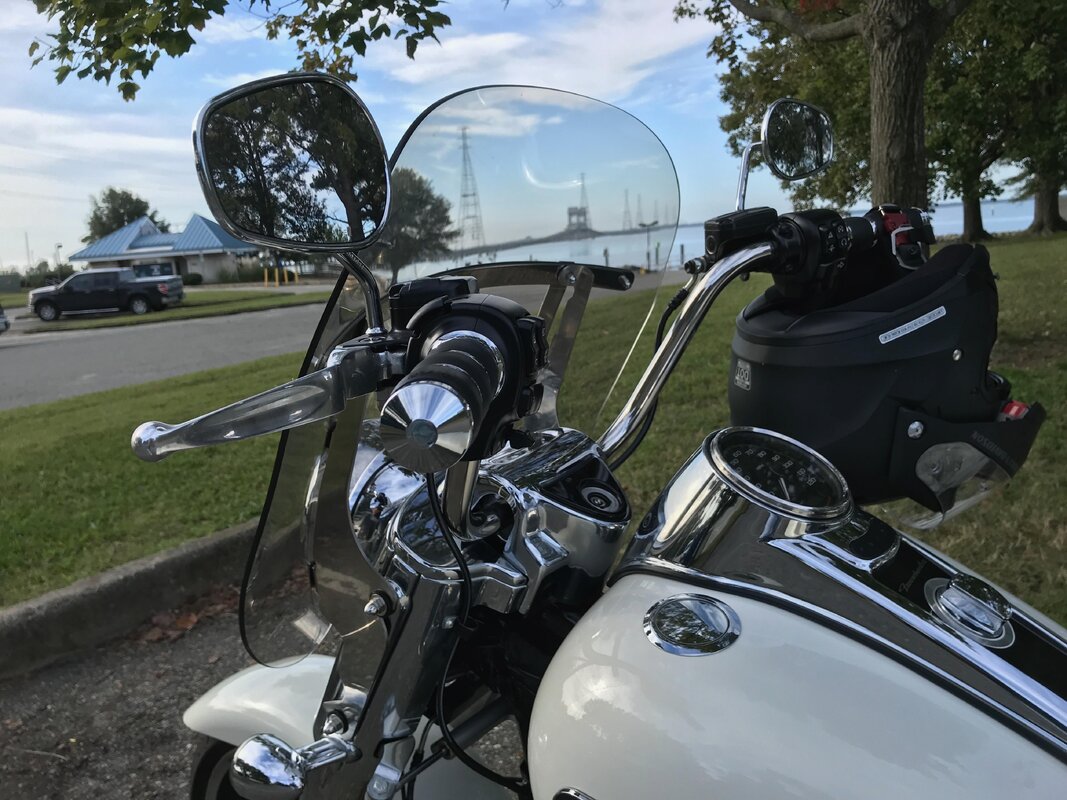

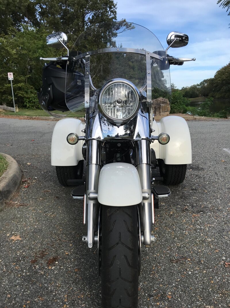

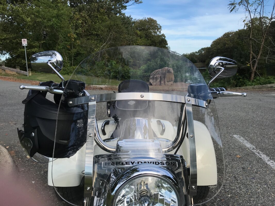

Axe and ye shall receive Mike. :D
I really like it, much lower profile than that HD 20" tall slab I had on it before. I'm 5'10" or so and my line of sight is a couple inches over the top of it. It still breaks the wind and I didn't feel any buffeting at all. The top has a slight curve towards the front and that helps deflect the wind. It's a tad thicker than the HD windshield, about .030" I believe, and is really sturdy.

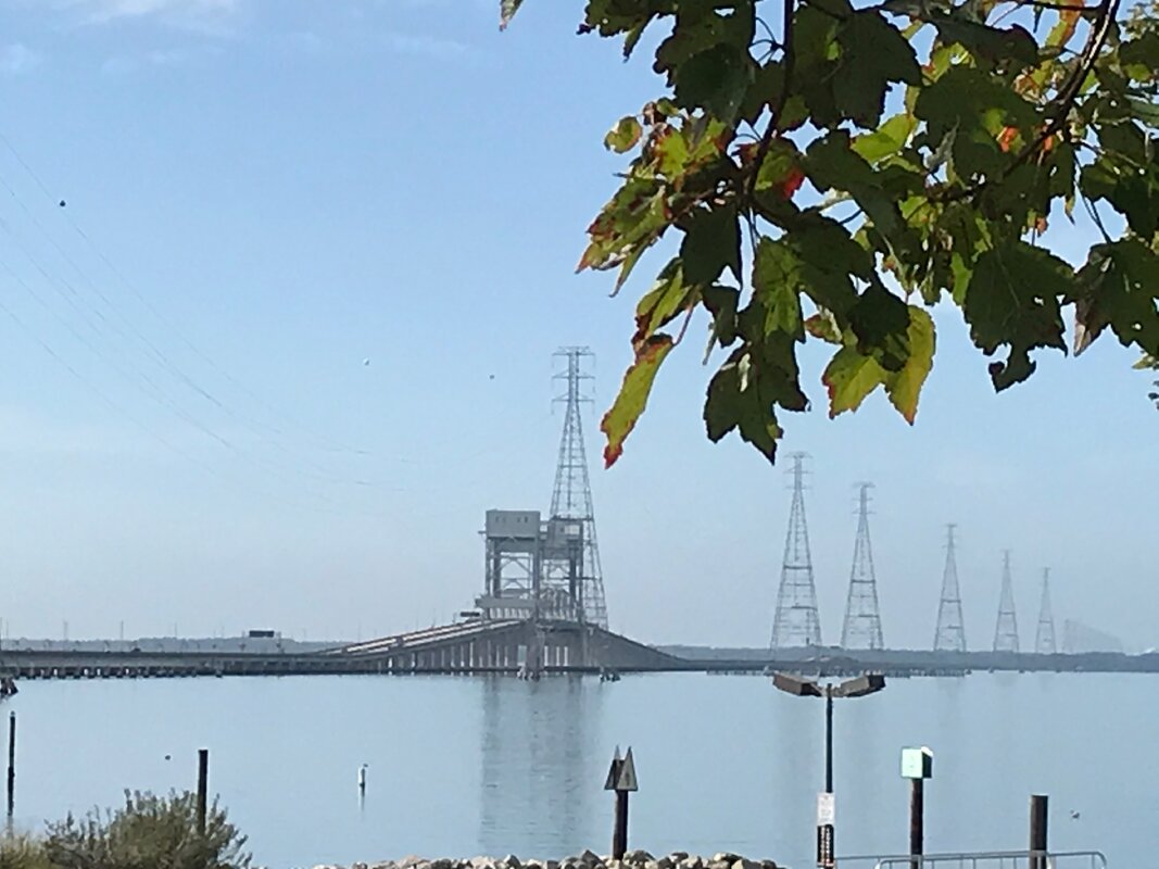

I live on the other side of that bridge, it's 4.5 miles across. I got over 75mph going across and even at that speed it felt fine with no helmet buffeting.
FWIW, just to the east of the bridge is the Newport News Shipbuilding where the nuclear carrier John F. Kennedy is being built. They pulled the plug in the dry dock a few months ago and floated her out, she's now sitting in the water being outfitted. It's a big river. And deep. ;)
James River bridge

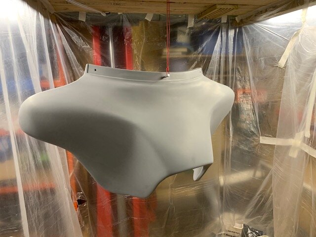

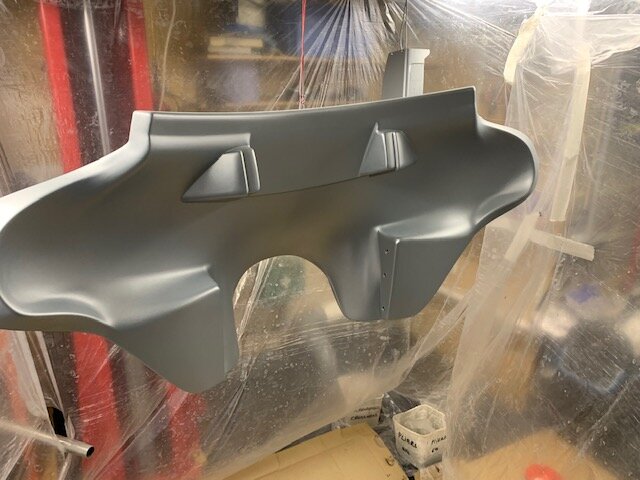

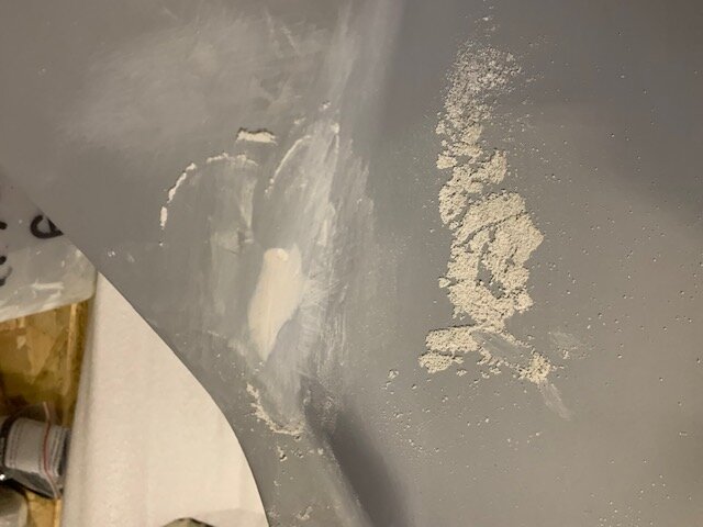

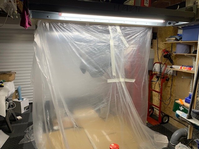

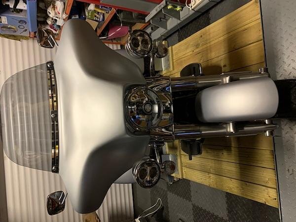

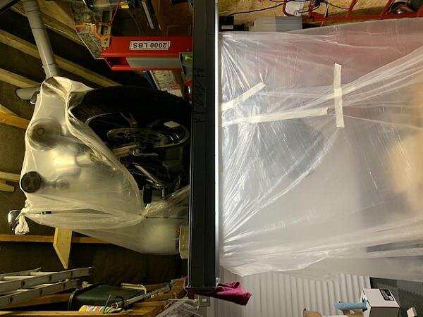

Well it was raining all day yesterday so I set up a small spraying area under the Freewheeler in my garage and colour matched the new fairing, here are a few pictures....
Just a couple of small holes from the manufacturing process that needed filling and as it came already primed and sanded it was ready for 2 colour coats and 2 clear coats in matt.
Then back on the Freewheeler, very happy with the result. Total cost was about £50 ($67), much better than the £350 ($470) I was quoted...happy days:D:D
