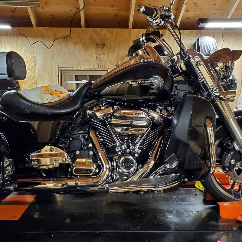

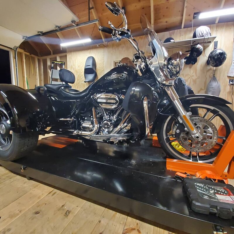

Bunch more stuff.
Cobra 909s
Ventilator Air cleaner
Black and chrome defiance trim for the air cleaner
Crash bar
Lowers off my RGS
Daymaker headlight
Kuryakyn 1" forward 1"out extenders on my Defiance foot boards. now my parking brake is accessible
Done for the night. Tomorrow I'll load the map for the Stage 1 and put my highway pegs on the crash bar.
Still waiting on my windshield and my rear bumper.
