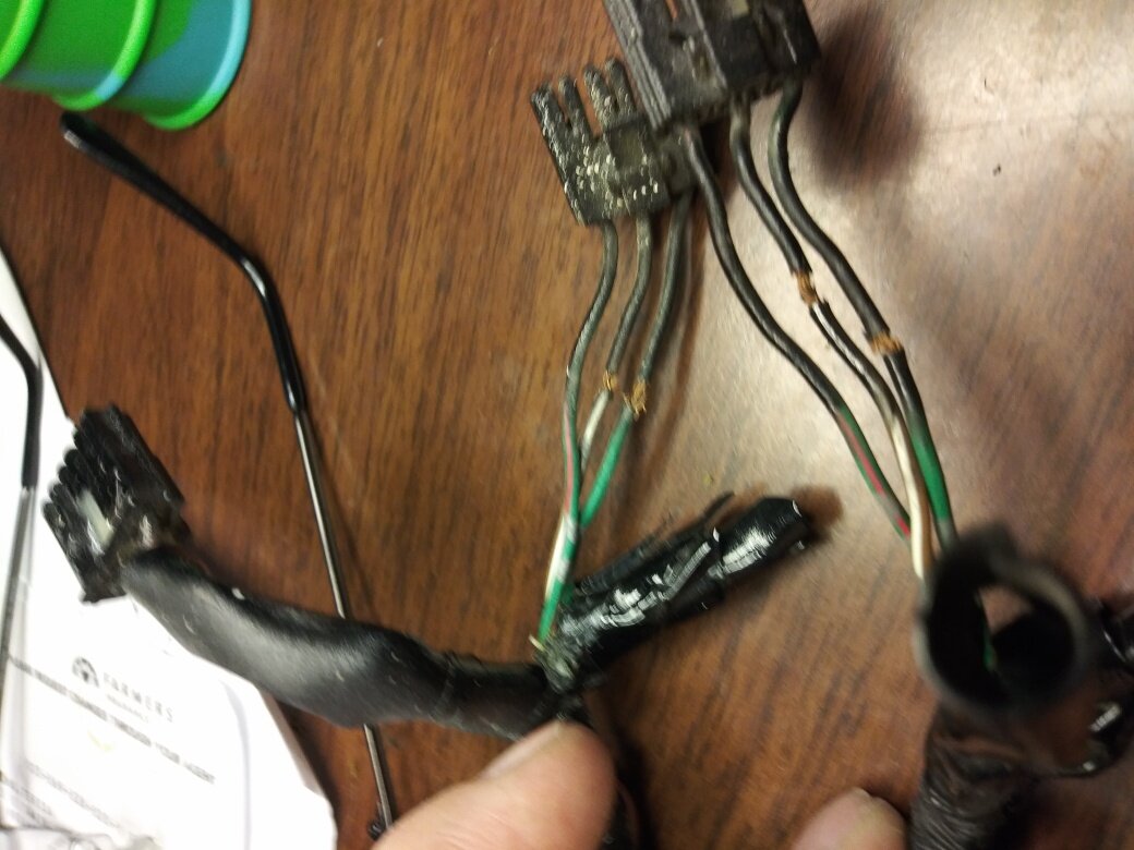

unfortunately i ran into a problem. things don't get my full attention until i'm working on them or installing them. i would have normally caught this and had it fixed. the wire harnesses from the tail lights too the bike were at one time spliced, right next to the connectors at the light. the splice's have 2-3 wires left holding them together. one is a dead short. these must be fixed. sorry the electronics tech in me just cant back yard this. might need new harnesses they very old the wire is very old. at least this is an indoor job.
the damage is to great and the wires would end up short or to long and not fit. at $15 each new ones are on the way. waiting again.

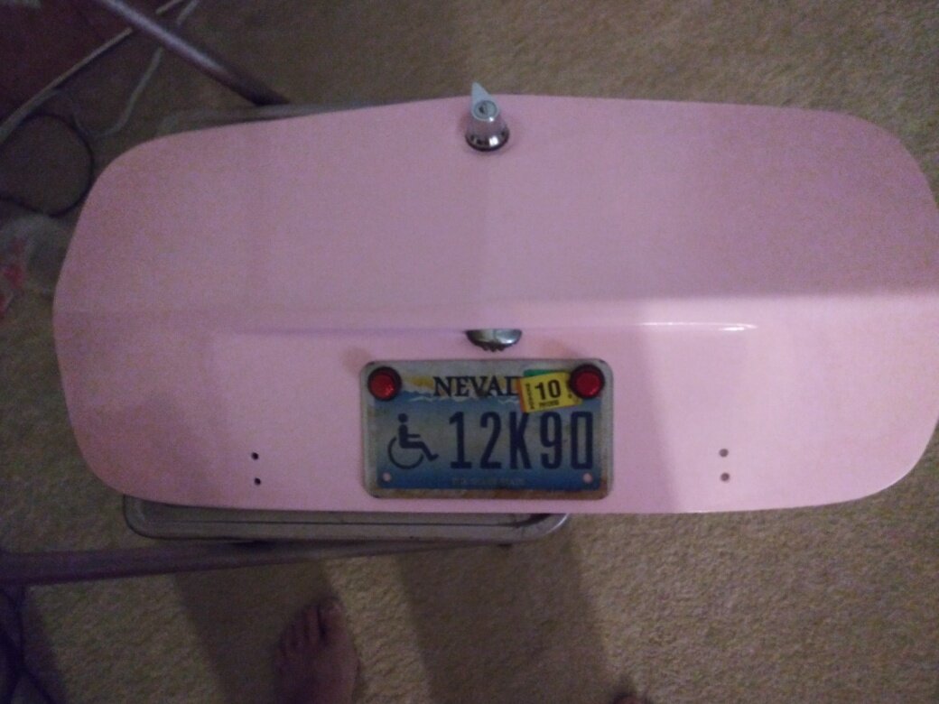

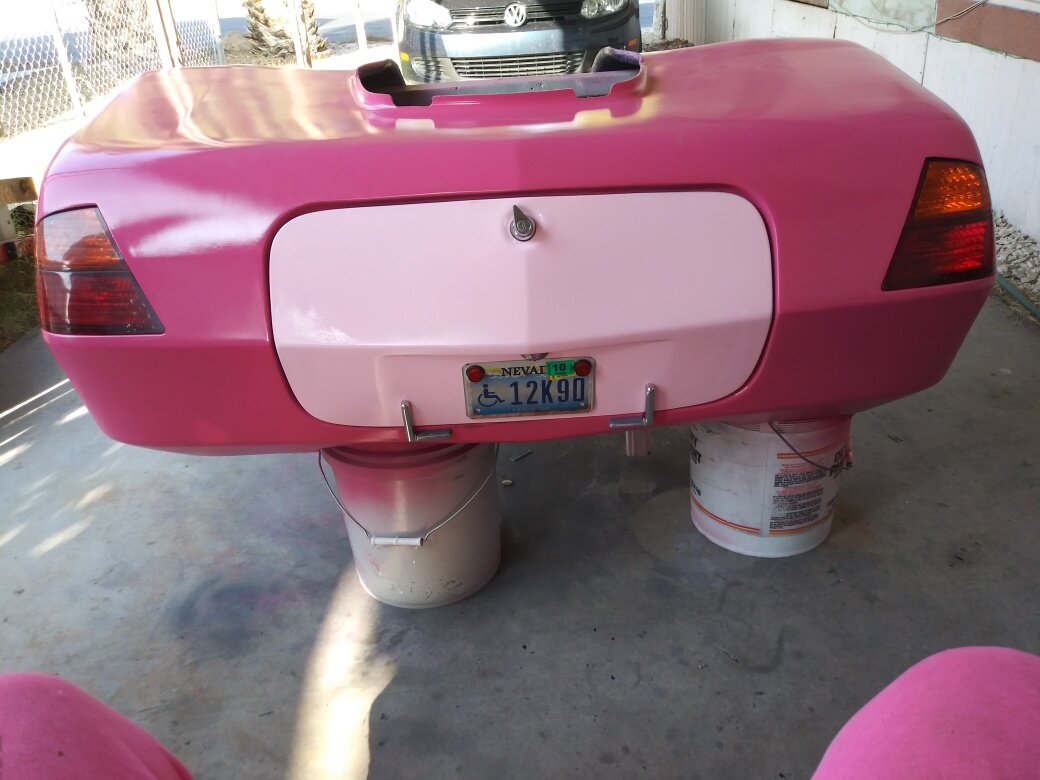

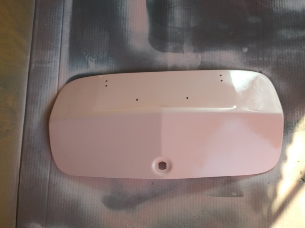

i got one side of the door done, with what i have. nice double coat of light pink, no clear im out. this paint really does not need it, none of the plastic is cleared. the fenders needed the extra protection. i'm going to let the door dry before doing the other side. it has to be laid down so to not scare the paint i'm letting it dry over night. i'll do the other side in the morning.
more to come on the fenders later.
If you can post a picture of the pant can; Ie The Brand...The rattle cans that i use never come out that smood and finished looking...ThumbUp....

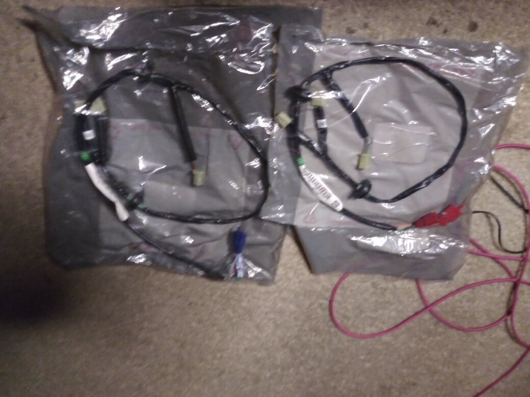

Good on you for getting new wiring:clapping: It never pays to cut corners with wiring IMO;)
I have seen electrical fires on bikes, it aint pretty
I had a bad fire coming home from Sturgis one year on a friends bike, Scared the Hell out of me

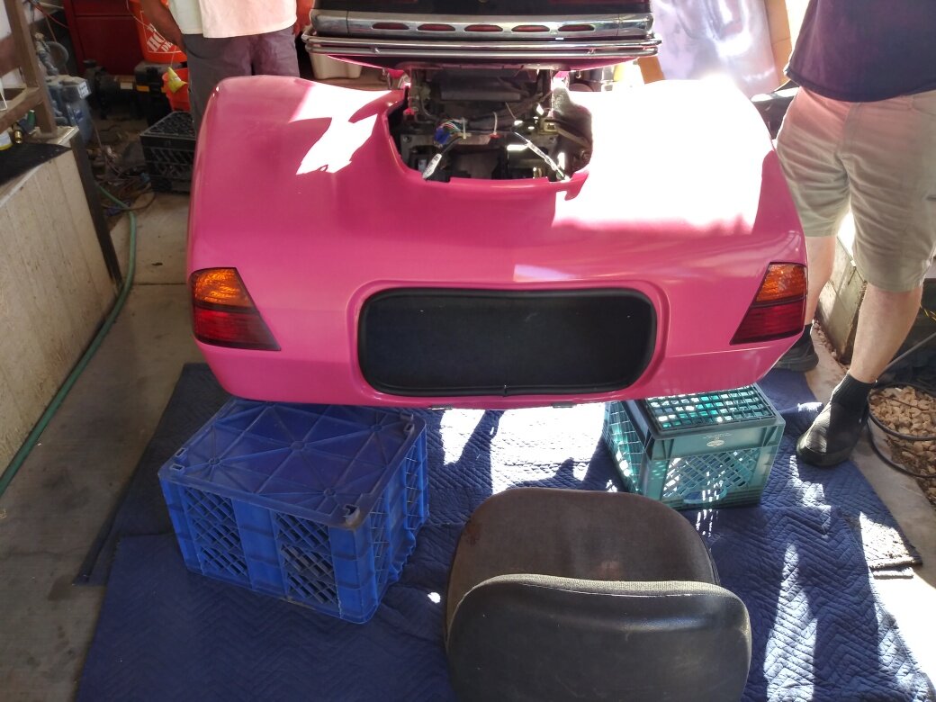

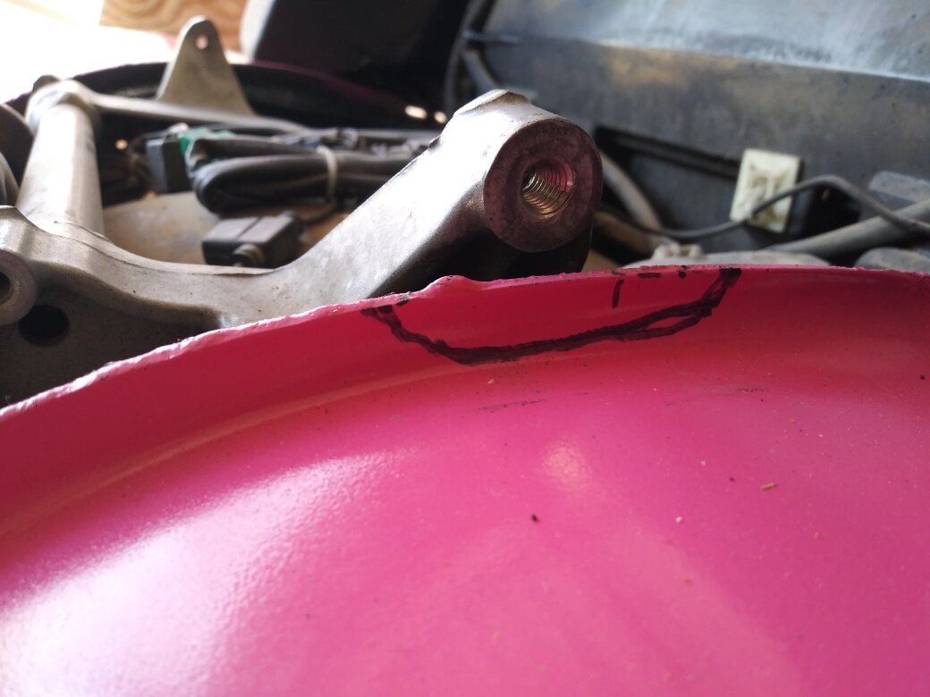

so now im mounting the seat i set it on and the rear bolt holes just dont quite line up, they dont go down far enough. so i need to cut 2 more notches in the fender so the seat will fit. this is probably what broke the seat there from the other fenders, did not cut notch in old fenders. :gah: no real big deal ill have it done by end of day and get the wheels on.
update; i cut the notches then pushed the seat all the way in. its not the notches the fenders are to high in the front. still an easy fix just cant use the nice rubber mounts. will have to thin it down and just use washers. also need 2 people cant reach the inside bolt and underside bolt with one person. so brakes on. :gah::gah:
ive been thinking, if i lower the front and raise the rear it will bring the front curve down and back. am i correct. it also just happens i have room in the back to go up and the front is a little tight and could come down. in my head it works i think?:confused:

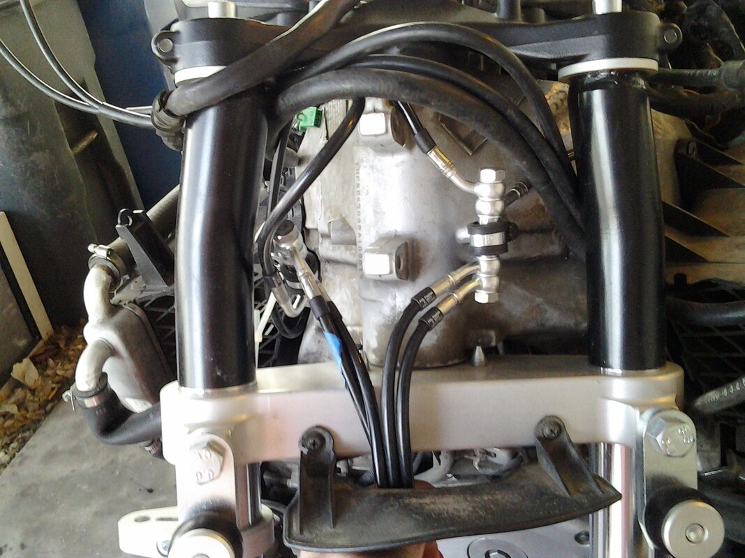

sort of, the rear brakes are still connected to the front. but the front brake only operates the front brakes. most of the factory lines are still there up too the connectors behind the radiators everything else is gone and been replumed. while i have no issues with the front brakes on the left in pic rightside on the bike they are isolated now no long lines to hold bubbles. the rear brake connection other side to the front is a different story. eurowing builders remove the proportioning valves out and direct connect everything. i still have the valves and the long lines on both sides. big issues with bubbles now that i fixed the leaks. if i had the money i would pull the rest of the factory lives and valves. direct connect the rear brakes and have just one line to the front. i believe its having the 2 lines going to the same place and using both valves is confusing the system. this is the way i was told to install it and the only way the lines fit.
added; on the rightside is the front brakes, you can see the caliper line the bent one on the bottom. the 2 lines coming out the top go to the calipers. on the otherside at the top are the 2 feed lines from the rear, they only fit here try it every way possible. the 2 on the bottom go to the calipers. its the top rear lines were im sure the bubbles are collecting. im sure having these 2 lines connected is messing with the proportioning vales which would cause pedel issues. except for the fact i have had a hard pedel, so i know im not done yet. i ran out of fluid, my air bleeder will change all the fluid in a minute. just pulls it through, have to push the peddle though weird.
The only reason I was asking if the front only operates the front,but the rears operate the rear and maybe possibly one side of the front. that could be where the issue lies.

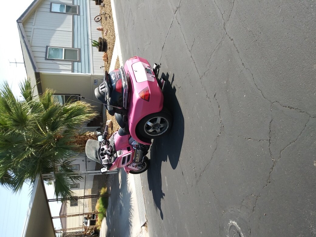

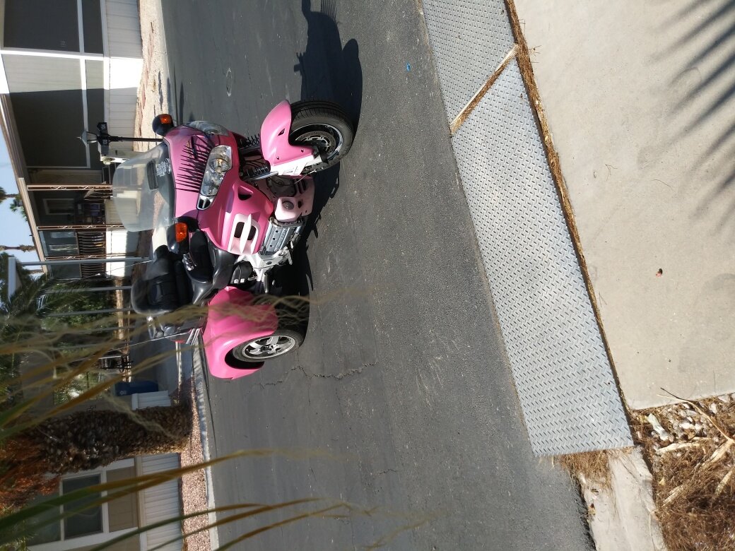

JOY is fixed and legal. :clapping:
still need to bleed but that will get done, i changed the bulb she is legally drivable now.
:clapping::clapping::clapping:
off i go hope i dont die this is the same road i got hurt on. it a good thing i know how to ride huh. was making them dance before these punks were born, we were the first the ones who started freestyle. thats why i'm alive today.
:GL1800:
YEEE HHAAAAA
:wave4::wave4::wave4:ThumbUp:pepper::pepper:
oh yeah i forgot why her name is JOY, OMG i forgot that throttle and sliding sideways around turns. oh the way she hooks up while sliding. OMG and the way that front car tire just like glue on the road. i also found out which muscles been cramping lately. yup the ones i aint used in 18 months. she runs straight and true, needs some air, and i think i heard a squeak up front. but all good. i'm no longer stranded.
