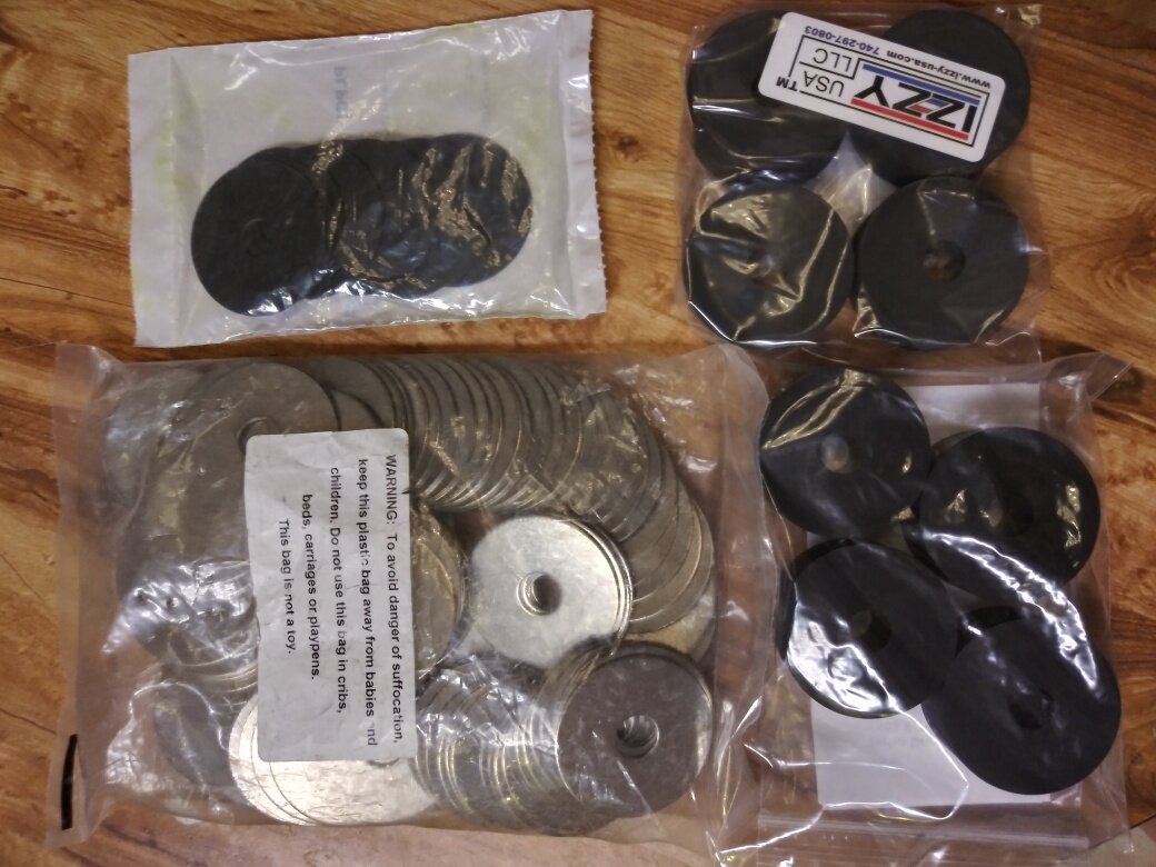

i ordered the spacers, 1 in and 3/4 in. for the top and bottom mount. they are 2 in in diameter and solid rubber. i also ordered new washers and rubber washers to go against the fiberglass. this time they will be mounted right. i am going to have to buy longer bolts though. i also ordered a new battery. i am going to spend my waiting time doing the trunk door. it needs the license plate holes drilled as well as the light. then prime and paint all can. hope to be done soon although i realize painting will have to wait till fall. primer can always be fixed. this means after mounting i dont have to take the fenders off for painting yet. just fix the clutch and ride.
i got my mounting parts. all 2 in diameter, #4 1in thick rubber spacers for the bottom, #4 3/4in thick spacers for the top. i also got enough flat washers top mount the fenders with just them. since the flat washers go under the spacers and between the spacers and the fenders, i also got 10 flat rubber washer to cushion between each flat washer and the fenders both sides. you will next see these installed. it will be mounted right and tight.

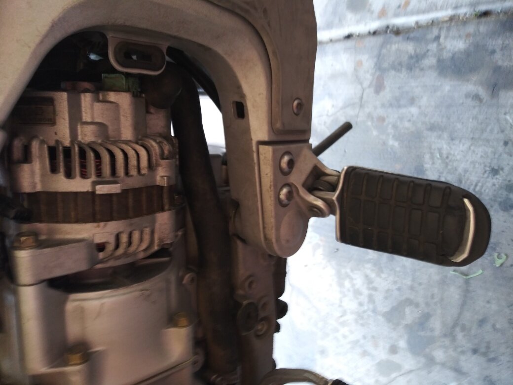

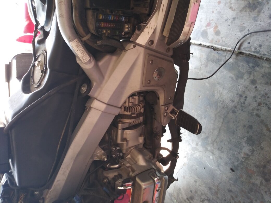

next we took out the alternator. wow so cool just a hole with a spline connection. the alternator is out and i have plenty room to work. i gotta skinny brush clean that up.

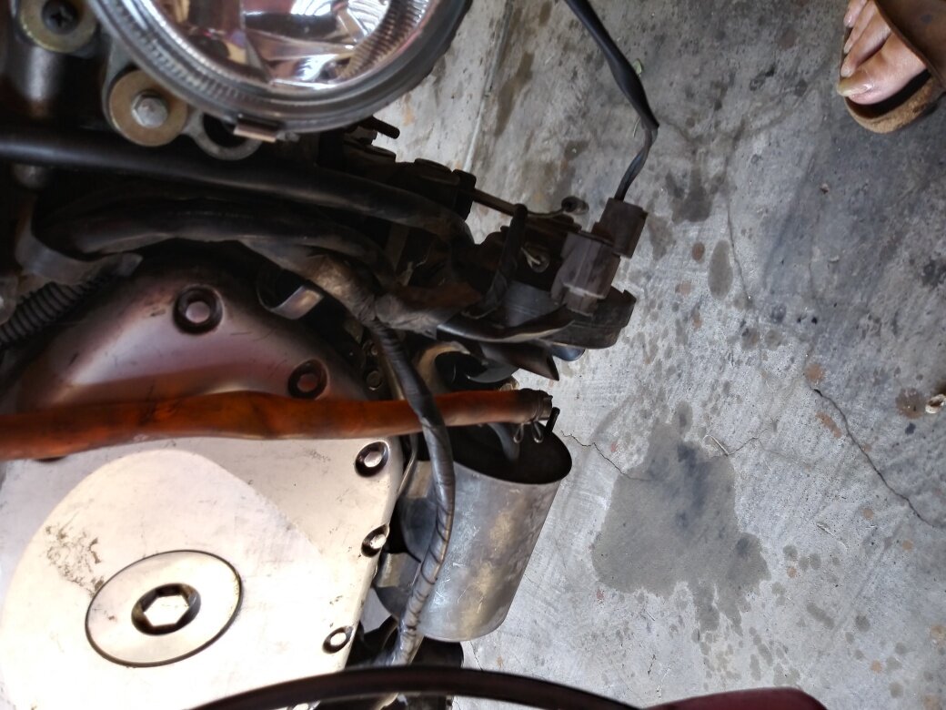

we got the cover off today. there was nothing obvious by eye.:confused: :gah:there was looseness and movement in the clutch lifter. we took the lifter plate off anyway and removed the lifter. still no obvious damage or wear.:confused: upon examining the rod my original decision to replace it stands obvious wear on the old one. the lifter still confused us both.;) upon examining the lifter under a magnifier i found wear.:( the decision is replace the seal, bearing, lifter and the rod. that should fix the noise. :Shrug:we will blow out the oil gallizes before assembly. i have to order a couple parts so the cover is back on and the clutch is waiting again. oh yeah the gasket came off clean on the cover. although i have a new one this existing one can be sealed back in place with a little gasket maker.:)

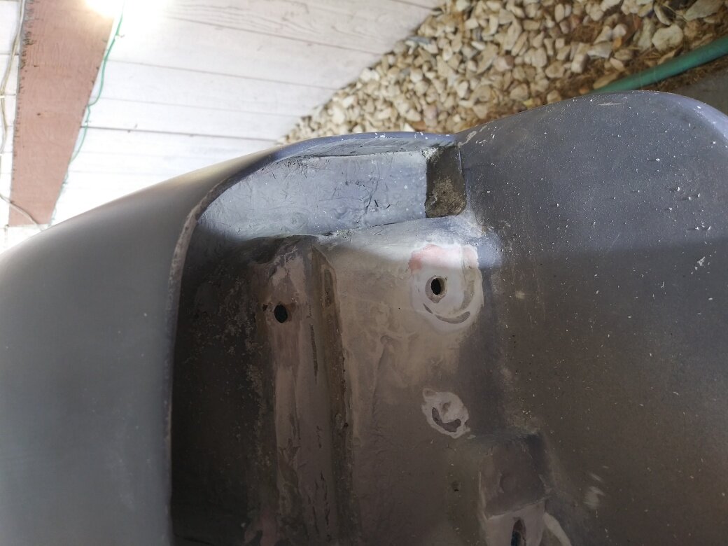

I cleaned the gasket off the clutch cover surfaces. still waiting on clutch parts. in the process of modifying the fenders to fit under the trunk. cutting notches in it and some off the lower inside of the speaker housings. having trouble with my dremel it wont hold a charge. so i do a little here a little there. going to do 1 last test fit, then drill the holes. as long as i make progress even if its slow.

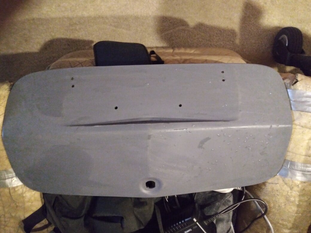

oh yeah i still have done nothing with the trunk door. guess i should get on that?
i got my clutch parts ill be putting them in tomorrow.:clapping: i finished notching my fenders they fit great now. i don't know what I'm going to do about getting new oil. i use golden specto 4, a natural synthetic blend. only available at cycle gear here. cant find a ride to get there. no one wants to go anywhere now. my normal ride is watching hockey.:gah: so yet another stupid hold up.:gah: oh yeah the neighbor friend that said he was going to paint my fenders and buy the paint pulled up stupid the other day. told me to do it myself with cans.:mad::mad: so i guess my fenders wont be getting painted. at least i wont have to wait for paint or any more prep. just put them on the way they are. going to use the old black door for now as well. i knew there was a reason i was not worried about the new door.:Shrug:i going to ride again enough of this stranded shit. oh yea hooked up my new battery to a battery tender it doing fine. under these conditions it just assembly now.

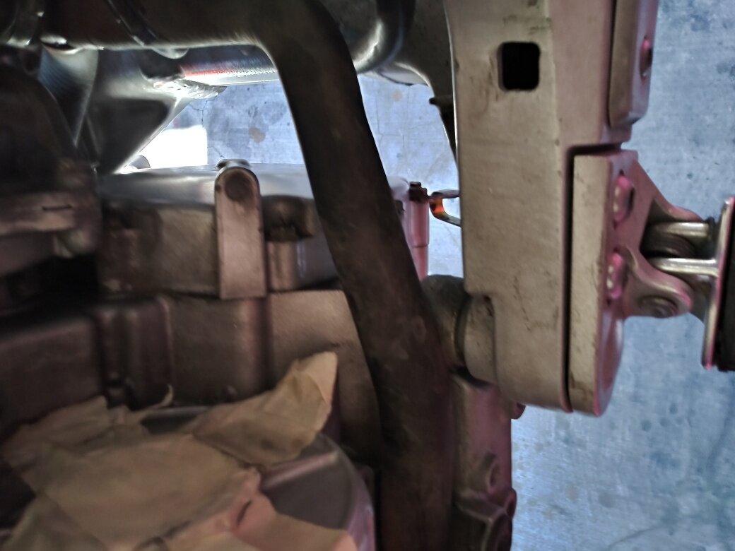

update after fitting the new parts together i believe the problem is the seal in the cover it seems to tighten things up.

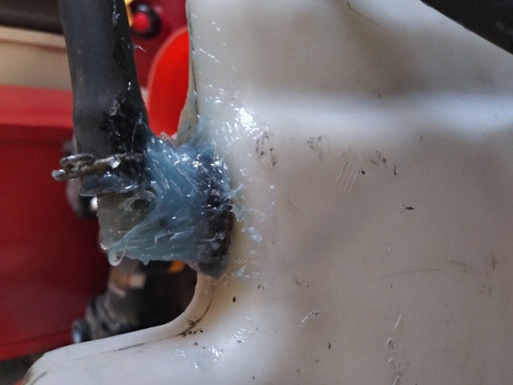

update; i installed the radiator tank today after gluing the connector in. then i ran the hoses, put the gas tank in, connected it and hung the exhaust from the back bolt. next on the list run and connect the o2 sensors wires. bolt up the header. by then i should have my oil. then its test start.

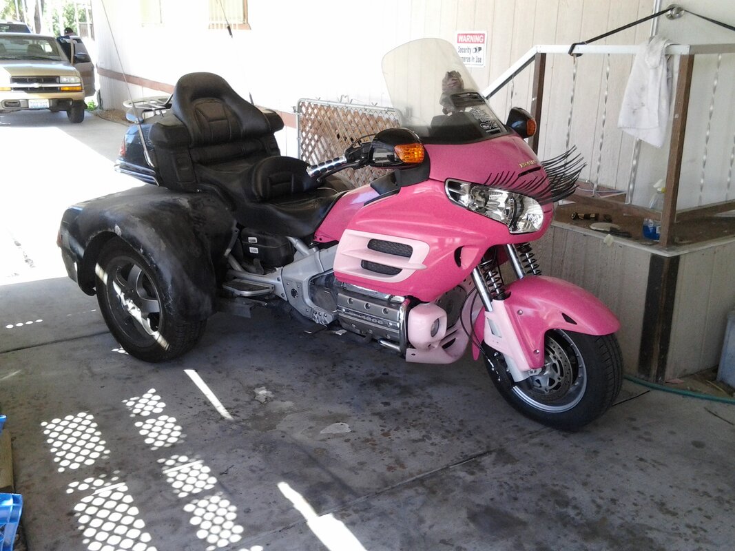

thank you sir and everyone, i originally in 2005 built this trike, i wrecked it, in 2014 and survived when i should not have. i rebuilt it during my recovery with a cast on my hand and a still today broken back. i installed the eurowing frontend with bad instructions and help from a builder, using helpers with little or no mechanical knowledge. i had to teach them how to help me, i'm still doing that. i bought and built this trike because it can always be repaired. i will never not fix her as long as i'm able.
JOY is all i have. she deserves to be repaired to the best i'm able. currently i have a friend who will do the paint, i'm not able to do. so i wait. if at some point painting is not an option i will mount them as they are until other arrangements can be made.
ever since i was little and fell my first time and got back on and rode harder i have been determined to never give up or quit. since my injuries have added limits i have learn to slow down and do as i can. but i will not stop. for those counting i parked her last year in june to fix the clutch and rear bearing. i already had the new fenders. that's 15 months now.

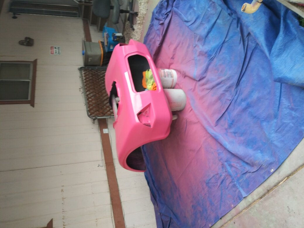

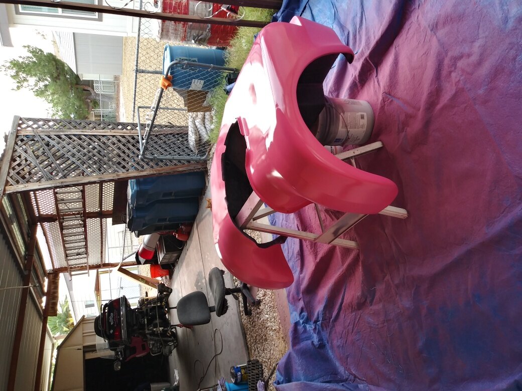

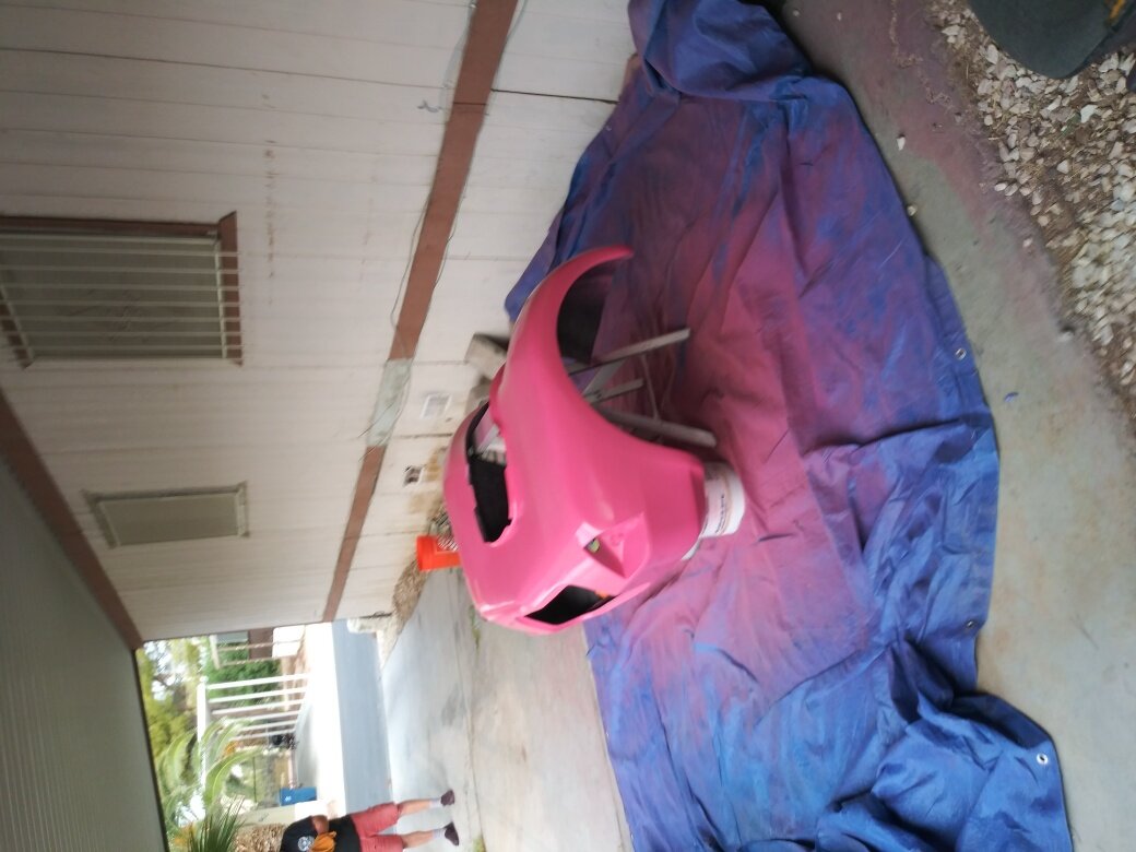

now i'm making progress, the fenders are pink and clear coated. yes they are rattle canned but they came out great. hes says i should buff them, not sure i can do that, not one of my skills. hes going to put a ceramic coating on them monday.:clapping::clapping: now i have to do the trunk door. it will follow the 2 color motif and be the lighter pink color. should have the fenders on next week, just need 2 people helpers at same time. got plenty to do this weekend now.
20200911_081712_resized.jpg20200911_081725_HDR_resized.jpg20200911_081739_resized.jpg
View attachment 91359View attachment 91360View attachment 91361
That looks pretty good for rattle can paint. I am getting excited:clapping: for you and your first ride
I'm pleased to see you doing an excellent job, people can do good work with rattle cans. Your trike will look great when completed. :clapping: I needed to click the like, but got the Thanks instead its all good.
Getting closer
Just about got her done!
Keep up the good work.
Interesting to see when you paint the door a different shade of Pink. Can't imagine it but might look great.

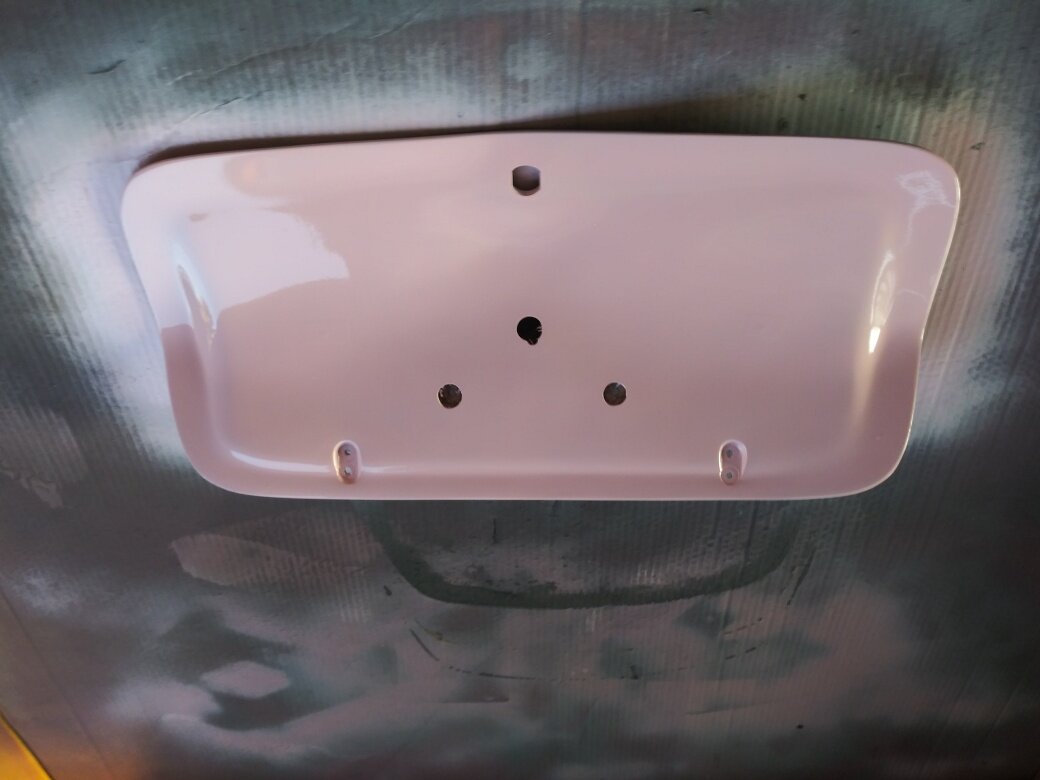

i got one side of the door done, with what i have. nice double coat of light pink, no clear im out. this paint really does not need it, none of the plastic is cleared. the fenders needed the extra protection. i'm going to let the door dry before doing the other side. it has to be laid down so to not scare the paint i'm letting it dry over night. i'll do the other side in the morning.
more to come on the fenders later. the fenders are done ready to install. after the tail light wires get here.
