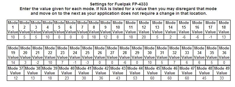

I have the V&H fuelpak. You should not need Dyno, go to ::: FUELPAK SETTING LOOKUP V1.0 :::
When you start to fill in the info it will probably say contact for custom data. They will review your setup and provide an email with your settings like example below. The system is very simple to setup. I had a stage one already so timing is already adjusted with that flash.
example:
Settings for Fuelpak FP-4333
Enter the value given for each mode. If N/A is listed for a value then you may disregard that mode
and move on to the next as your application does not require a change in that location.

Bike Mfg: Harley Davidson
Bike Model: Tri Glide / Trike
Bike Year: 2013
Engine Type: V103
Exhaust Mfg: Rush / Vance&Hines
Exhaust Model: Big Luie / power dual
Baffle Type: 2.0 Inch
Air Filter: Big Sucker (arlen ness)
ECM Calibration: Harley Davidson stage 1
Thank you,
Robert Martinez |
