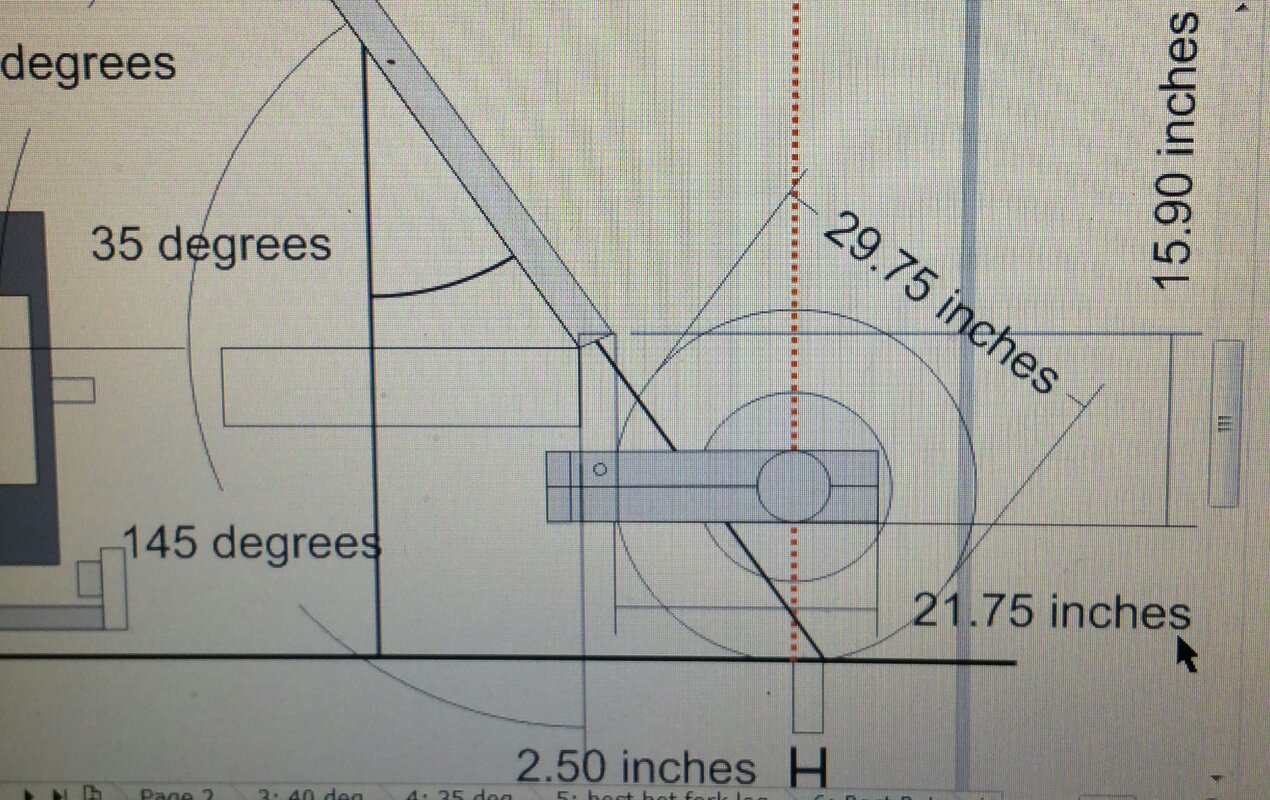

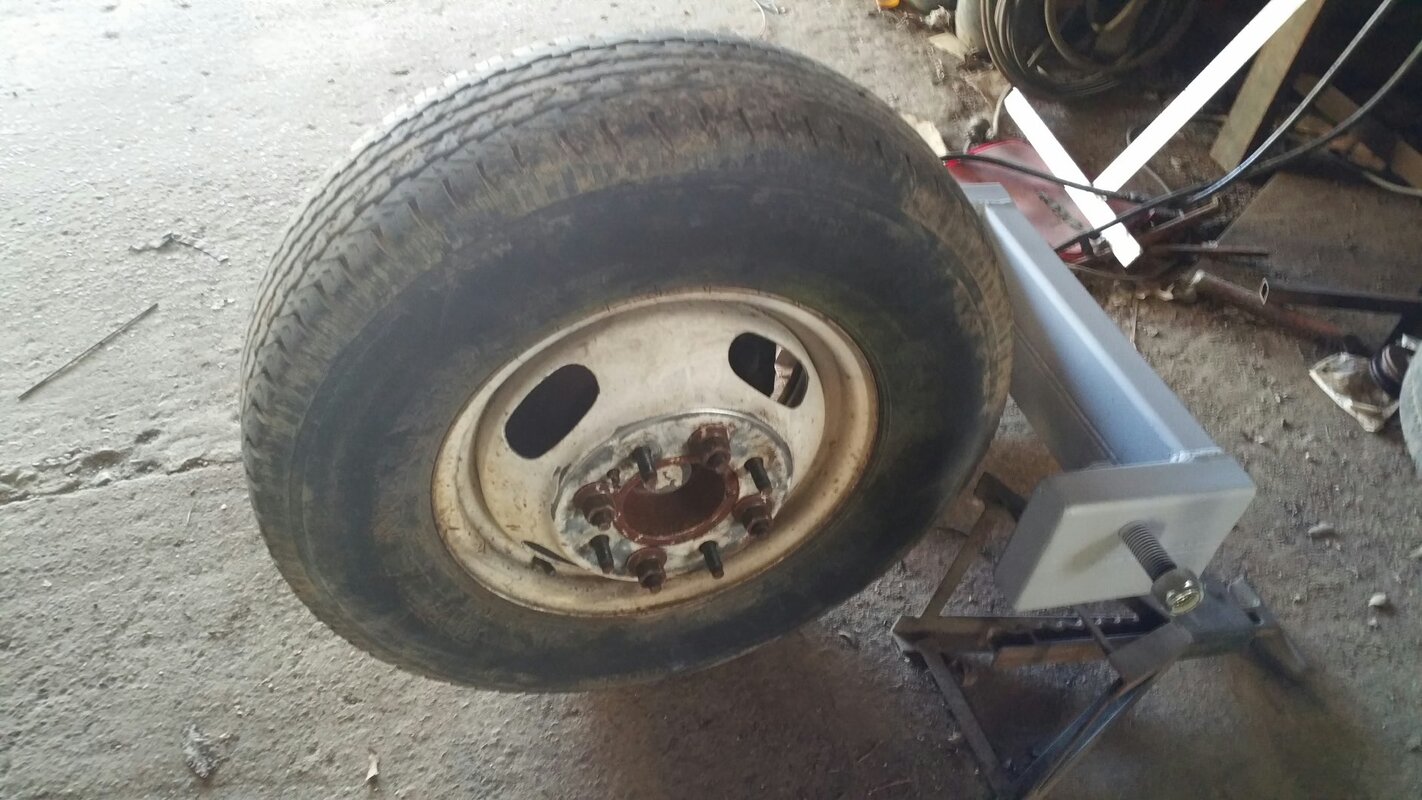

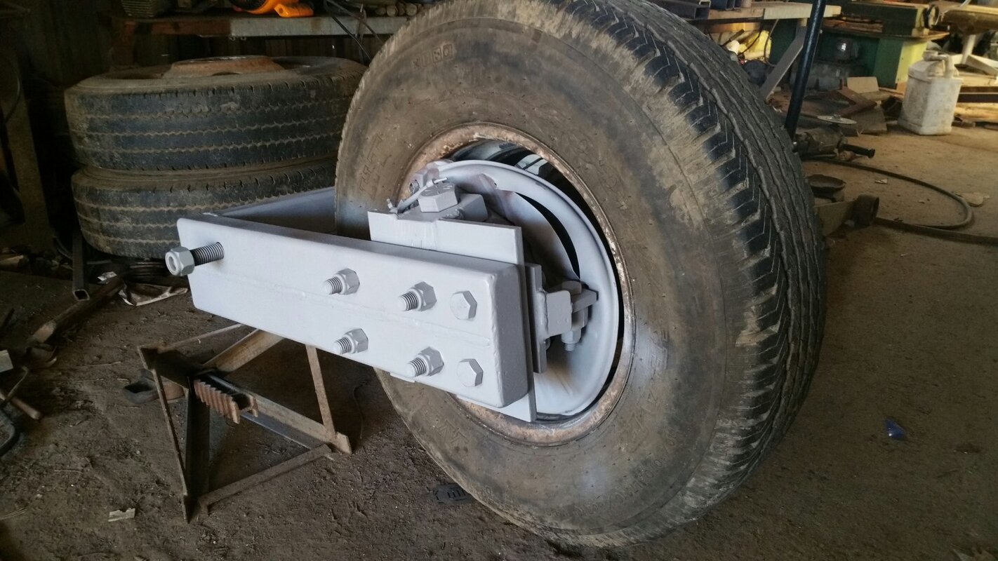

Sorry it's been so long since I've posted. Been busy! This is my ultra heavy duty leading link!!!2016-02-16 17.10.07.jpg

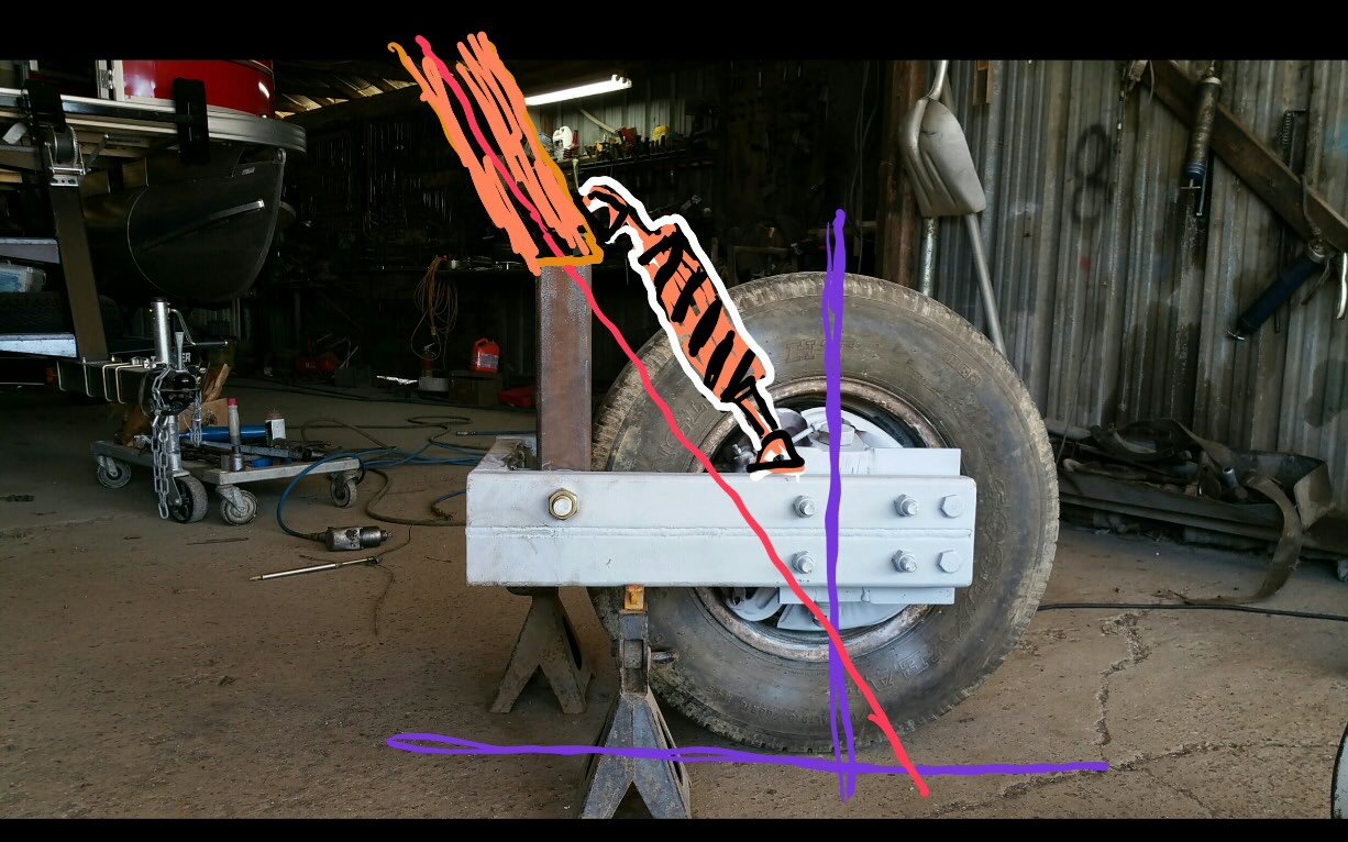

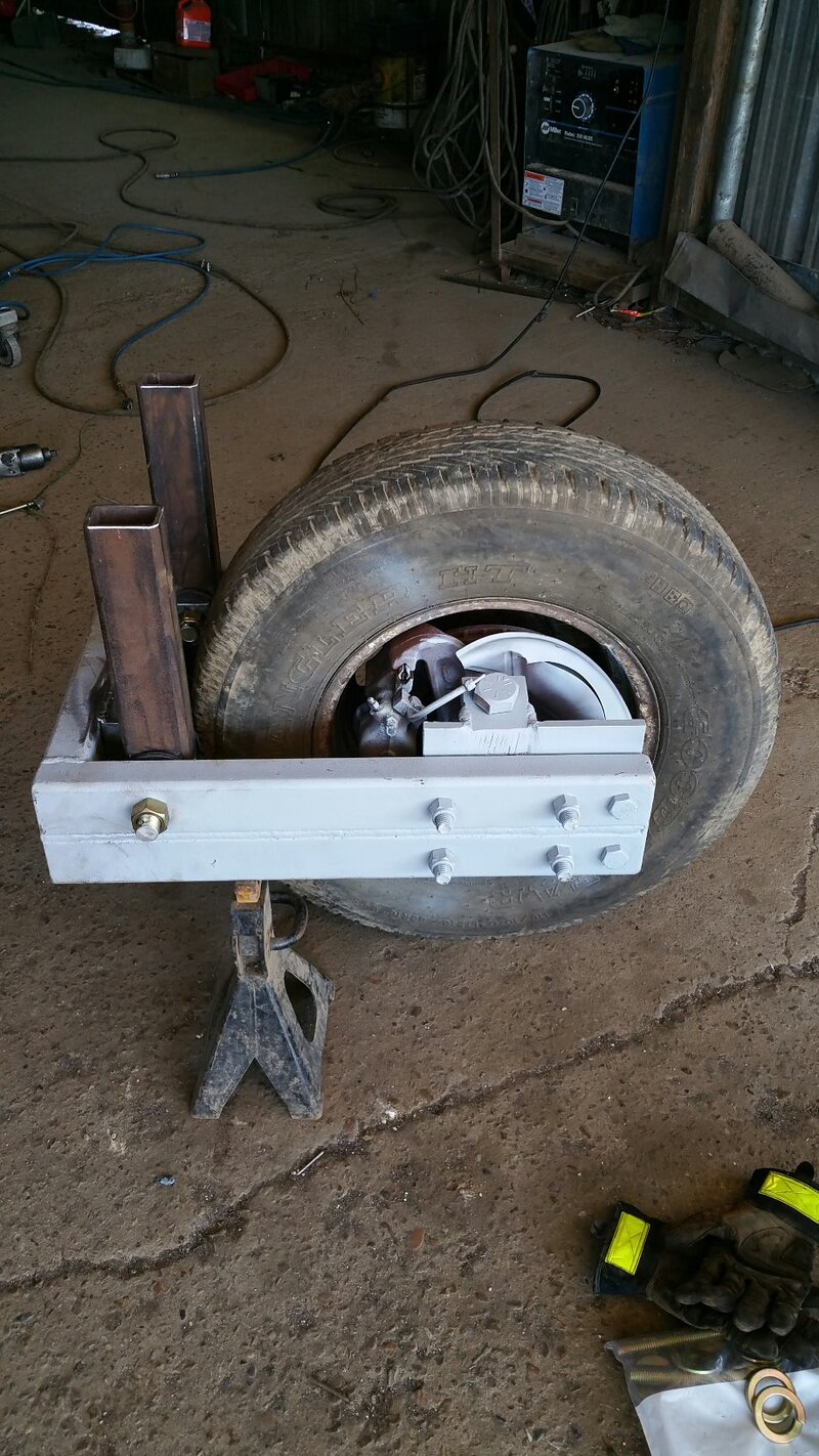

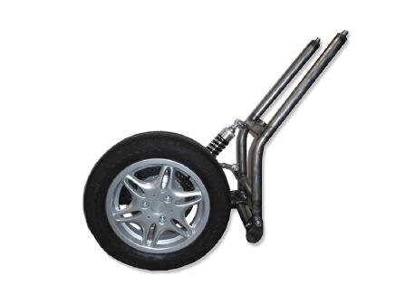

It's going to be a lot like this front end. Just a lot bigger! The hub and wheel are from the front end of an F350 Ford truck. I'm also using the 10.25 dually rear axle. My engine and transmission will weigh in around 1,200 pounds. I'm overkillin everything!

Looks like a lot of twisting torque on a single sided swing arm. I'm curious 2 c how that will take the weight.
Heck my v6 ride weighs in at 1700 with me.. I think the weight may surprise you a littleThumbUp. That is a monster and i like it:clapping:

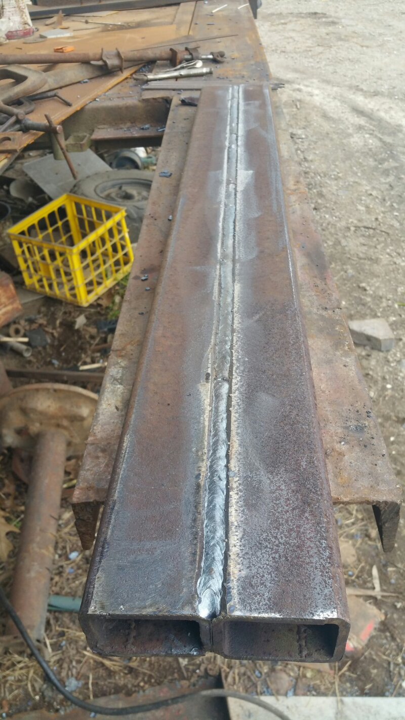

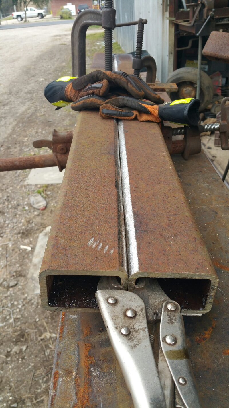

Yep. I went heavy on the swing arm due to the torque it will see since it's only supported on one side. The swing arm is made of 2x3 rectangular box tubing with a 1/4 wall thickness. I stacked two lengths of tubing and seal welded them together with two passes of 7024 jet rod. The pic shows a cross section of the tubing I used for the swing arm.2016-02-17 19.28.41.jpg2016-02-17 19.28.07.jpg

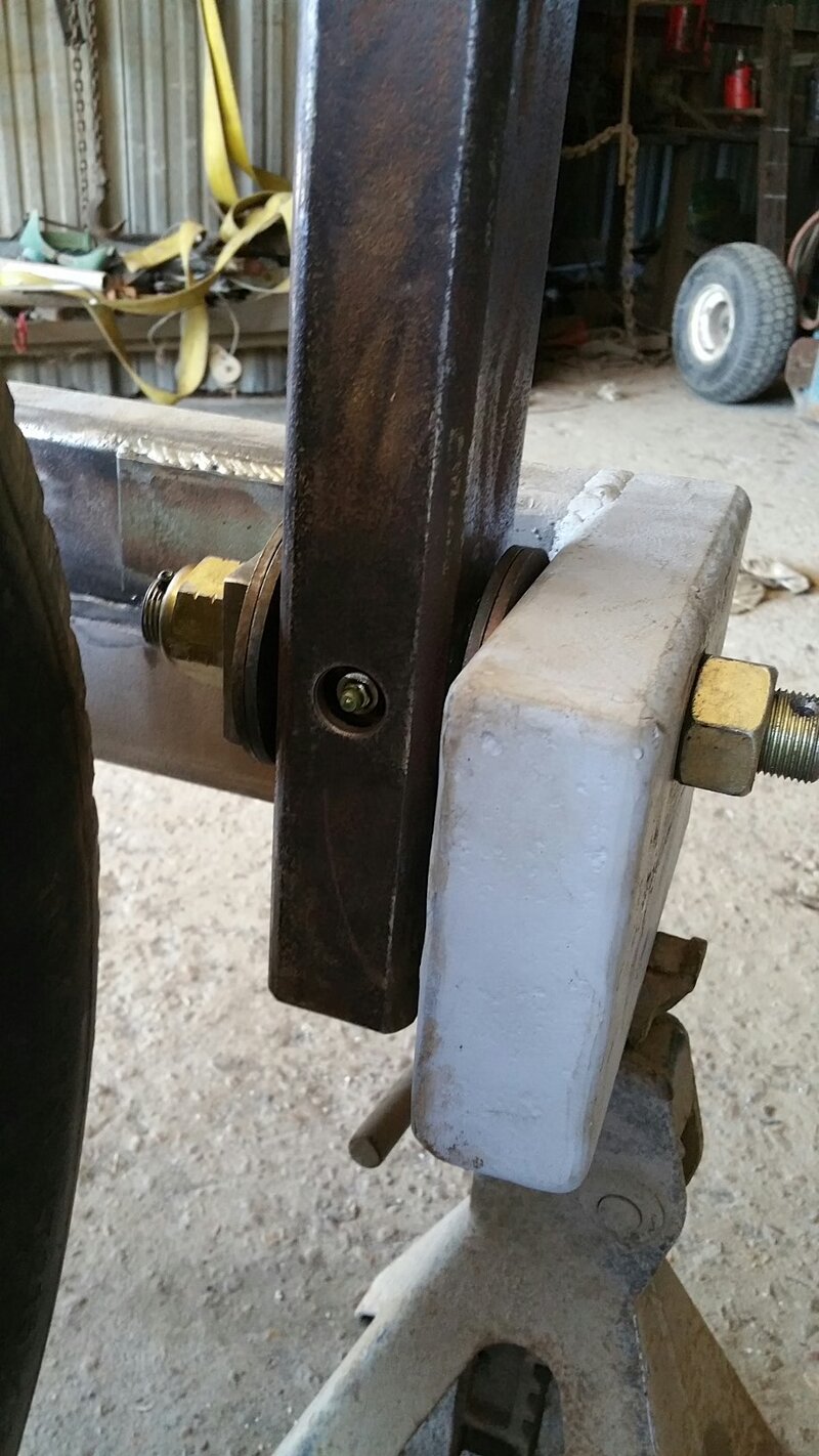

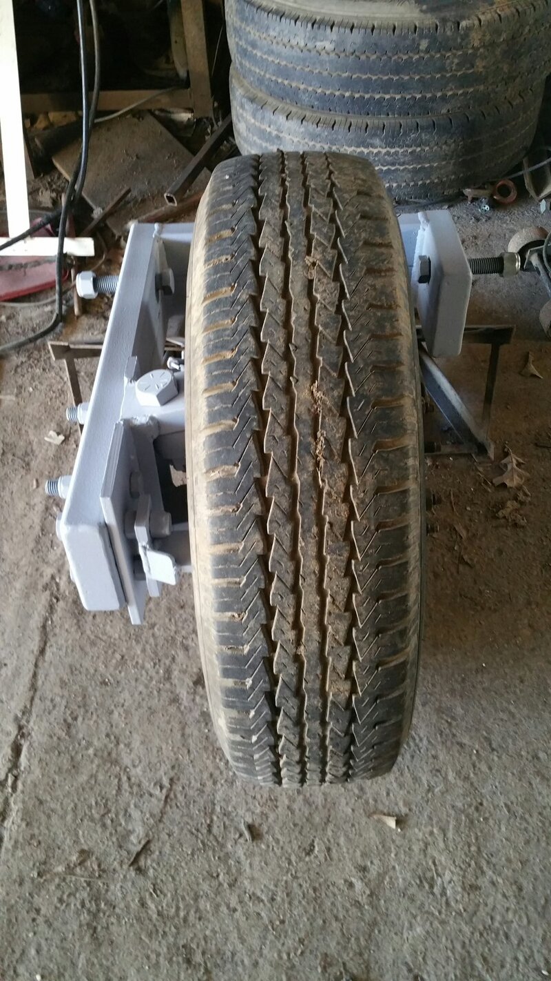

More leading link pics. I have the lower forks made. Busing welded in with grease zerks! 1 inch grade 8 fine thread bolts. Bolt bushings are easily replaceable 1 inch pipe.2016-02-18 12.19.06.jpg2016-02-18 12.19.38.jpg2016-02-18 12.22.30.jpg2016-02-18 12.20.02.jpg

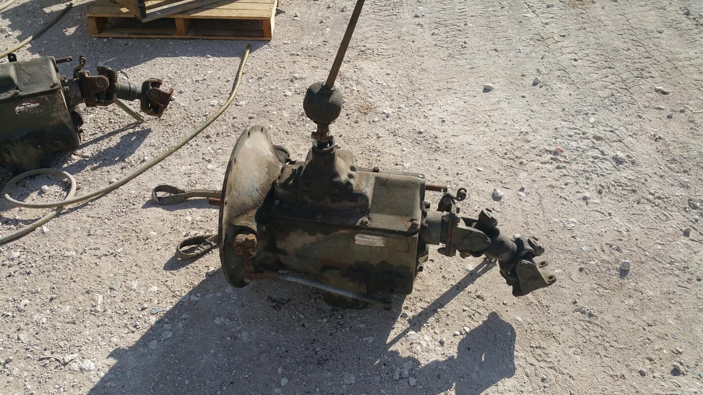

Oh... Almost forgot. *Part of the reason I haven't posted is that I've been chasing the transmission dragon for well over a month! The flywheel housing on the 3-53T is SAE 3. Almost nothing out there bolts up without adapters. I need a transmission with overdrive to get up to highway speed. Long story short. A Spicer 3053a from *2.5 ton Military truck!!! SAE 3 bellhousing with 0.85 overdrive! *I'm planning on going pick it up in a couple of weeks!!!

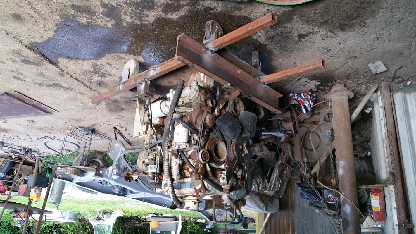

The diesel trike is slowly progressing
Well, I purchased the engine last week and I'm getting it cleaned up and dressed out for the trike. I'm hoping to get my transmission soon and really start rolling!!!20160611_184002.jpg

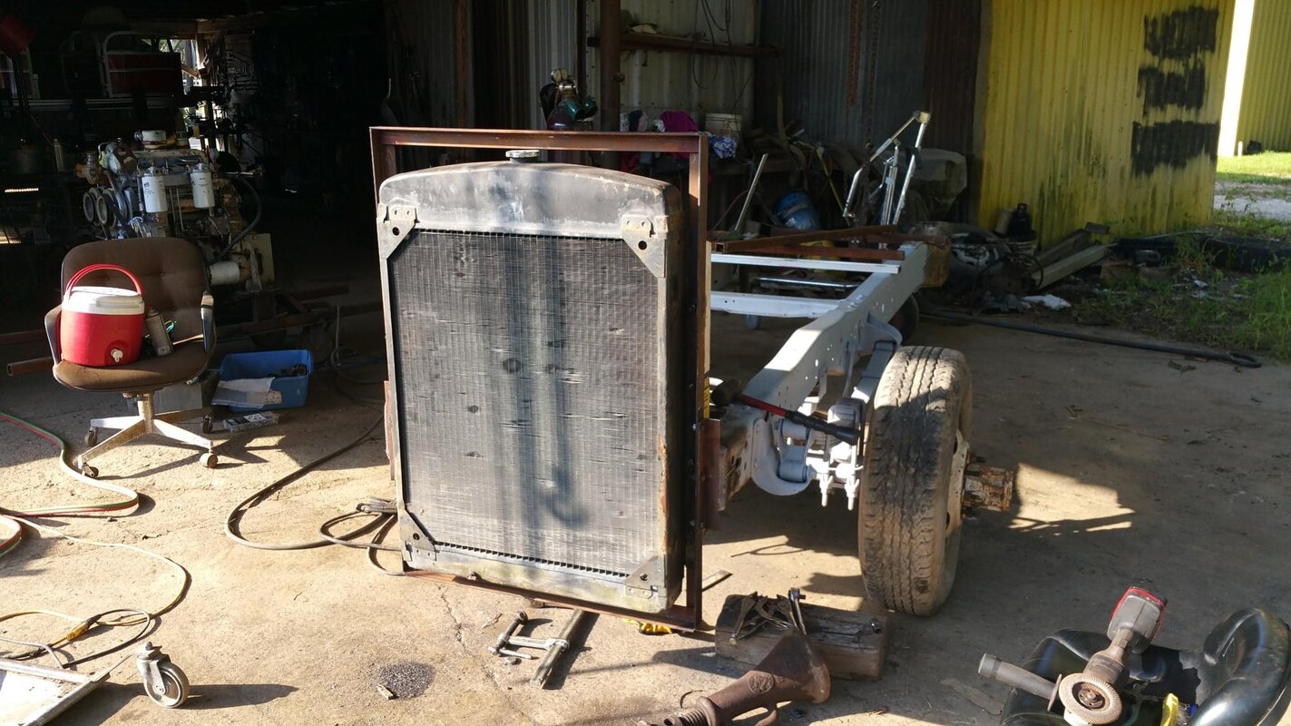

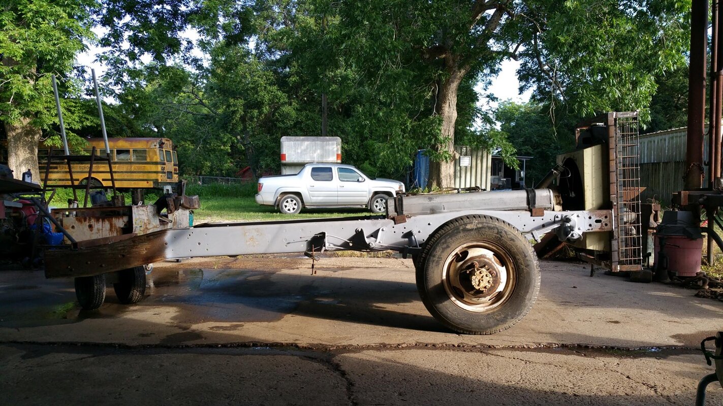

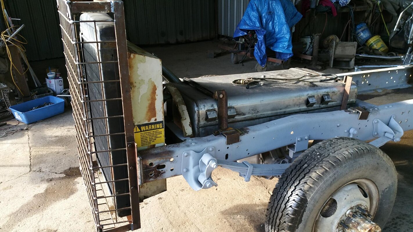

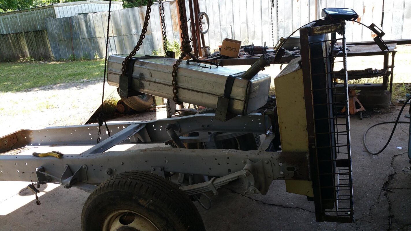

Radiator and fuel tank
Well, I mounted the radiator and fuel tank. I'm going to try something different with the rear mount fan. I'm going to belt drive the fan with a saft on pillow blocks that will run from the front of the engine to the back of the trike! Yes, electric fans would be easier but this will be sooo cool!!! Also, the radiator is big! It's big enough for a 6-71 detroit. The little 3-53t should be able to idle all day in the desert without overheating. The file tank is a 30 gallon factory ford diesel tank that was on the uhaul. Keep in mind, the Mad Max movies I grew up watching are a huge inspiration for this trike. A beast to travel the wastelands on!!!

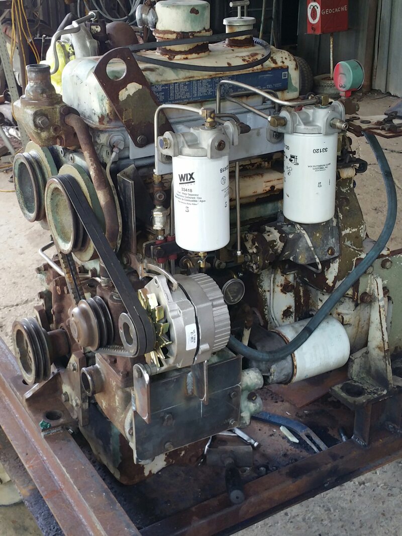

Primary and secondary fuel filters installed with brand new custom stainless fuel lines. Altenator bracket fabricated and installed!2016-06-25 09.15.45.jpg
