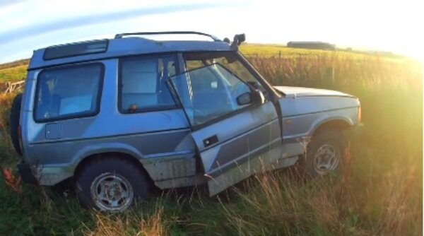

As promised in the new members section, here's my rather odd idea of turning an old and fairly knackered Discovery, with a 200tdi 2.5 litre diesel engine into a trike.....as far as I'm aware this hasn't been attempted before....mainly because it's a pretty ridiculous thing to try to achieve.
Here is a picture of the discovery before I started...
As you can see it was in an amazing condition....or not :D

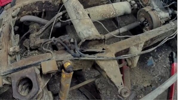

So I dragged it into my small Barn and ripped the body off of it...here's a pic of the wonderful chassis (frame)
As you can see it's in need of a fair bit of work to even make the chassis usable.

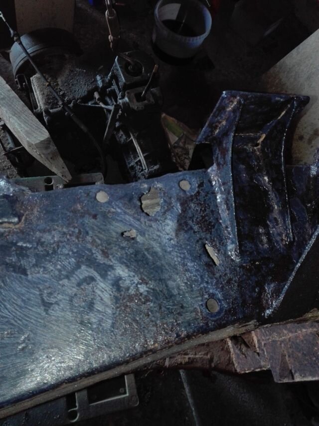

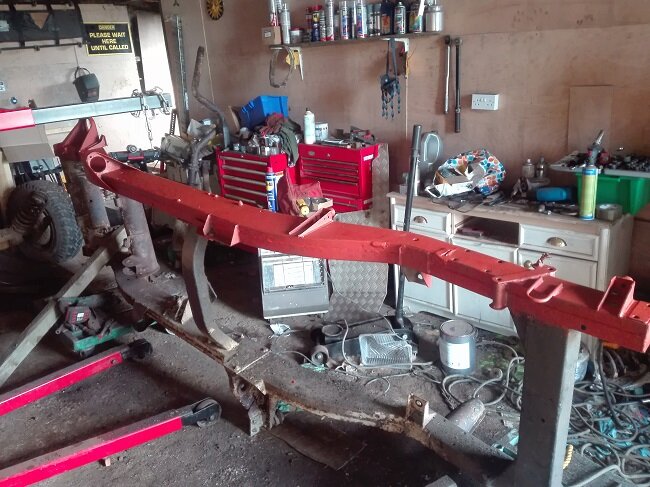

....I've been working on this trike again over the past few days, and have cut off several of the unwanted outriggers from the chassis. I've also cleaned one side of the chassis and rust treated it....thankfully the cleaning only showed up one area that will need some welding later. All of the details of this are in the video below.
...just a couple of photos of how the chassis is starting to come together....
Heres one showing the cleaned up chassis leg with a swift coat of primer to stop it flash rusting

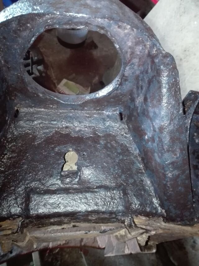

...and one of the rot I found hiding behind the rear coil spring seat
...this will obviously be cut out and welded up later, but for now the primer should help it to not get any worse for now.
I've also started cleaning the other side of the chassis now....more pics will follow later of the rot I've discovered there :gah:

...found a nice rust hole behind this rear spring mount...
....and several holes behind the rear shock top mount, thankfully that was it, apart from 2 other pretty small holes
....this is the chassis (frame) after complete cleaning and rust treatment, all it needs now is a quick coat of primer before I set about repairing the holes.
Once I've repaired the rust damage, I'll be ripping apart the rear axle, cleaning it all up and refurbing it before putting it back on....this might take awhile as it needs a few replacement parts that I'll need to find some cash to buy..

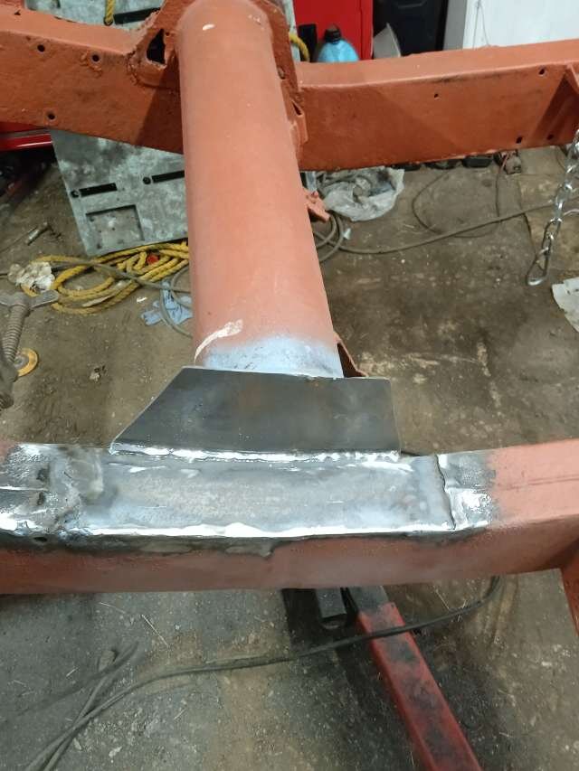

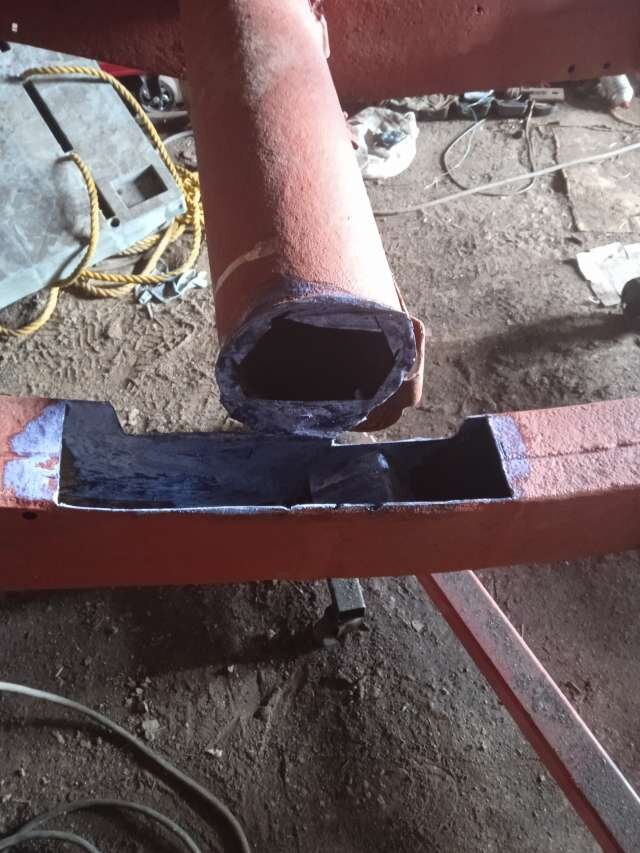

This is what one side of the rear suspension crossmember looked like after rot removal
...and after a lot of buggering about, cutting, welding and grinding later it looked like this
...until finally it looked much better....

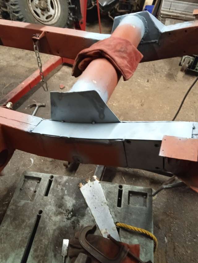

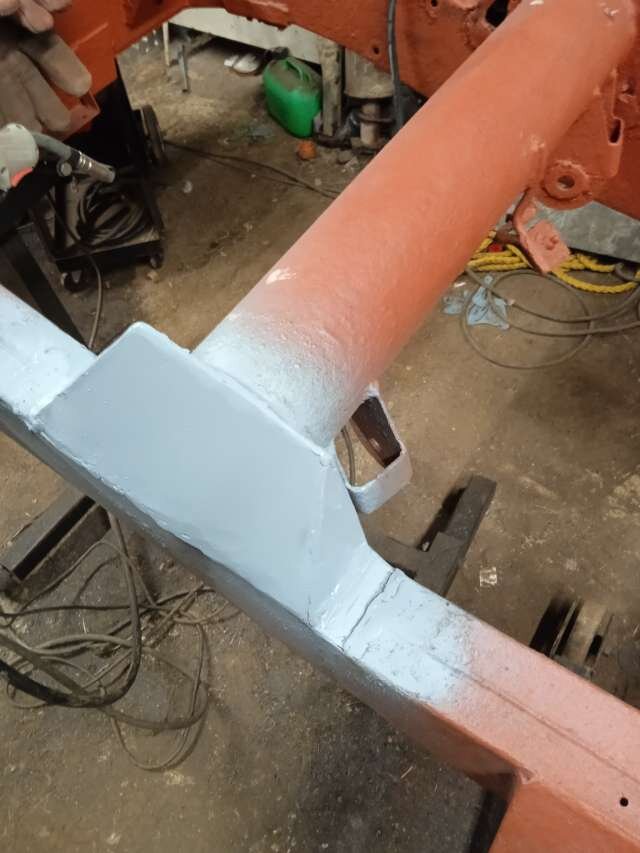

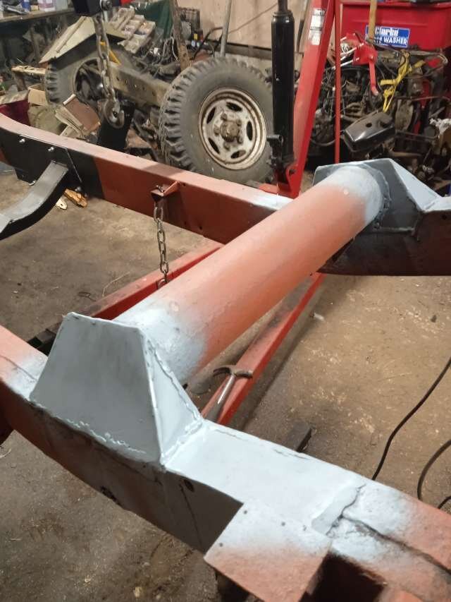

The other side had even more rot cut out, and after the initial repair pieces were tacked in looked like this...
The almost finished repair looked something like this...
I still have to grind back the welds on that last one and there are a few more holes to repair before the chassis is finally done.

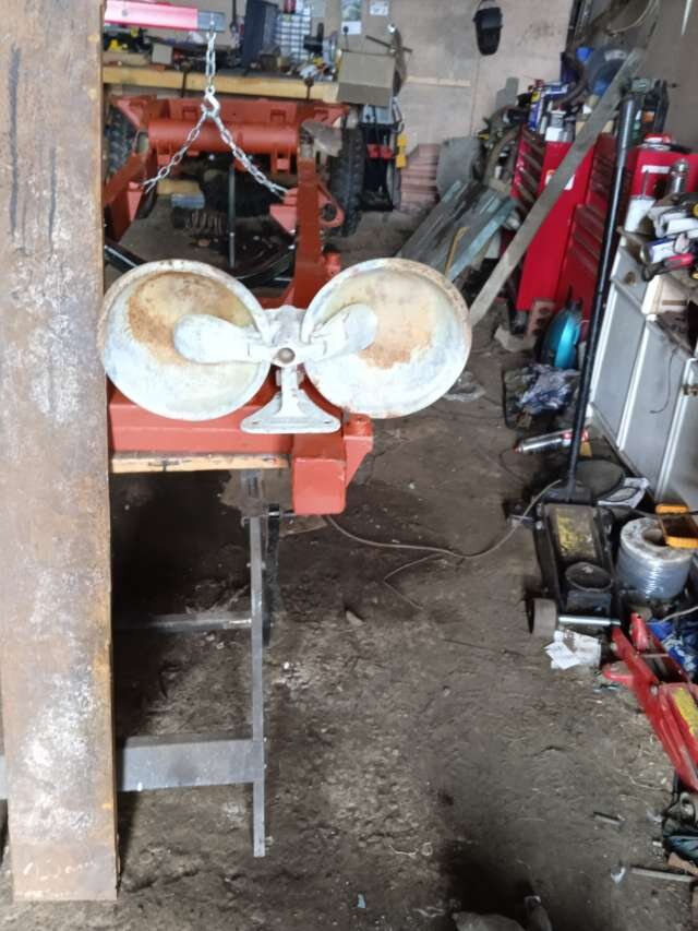

On a lighter note, I recently managed to get hold of something that will look great as a front headlamp holder....
I just had to have it :D .....will look great with twin headlights in (It's actually a cow drinker....and it's definitely going to hold my headlamps!)

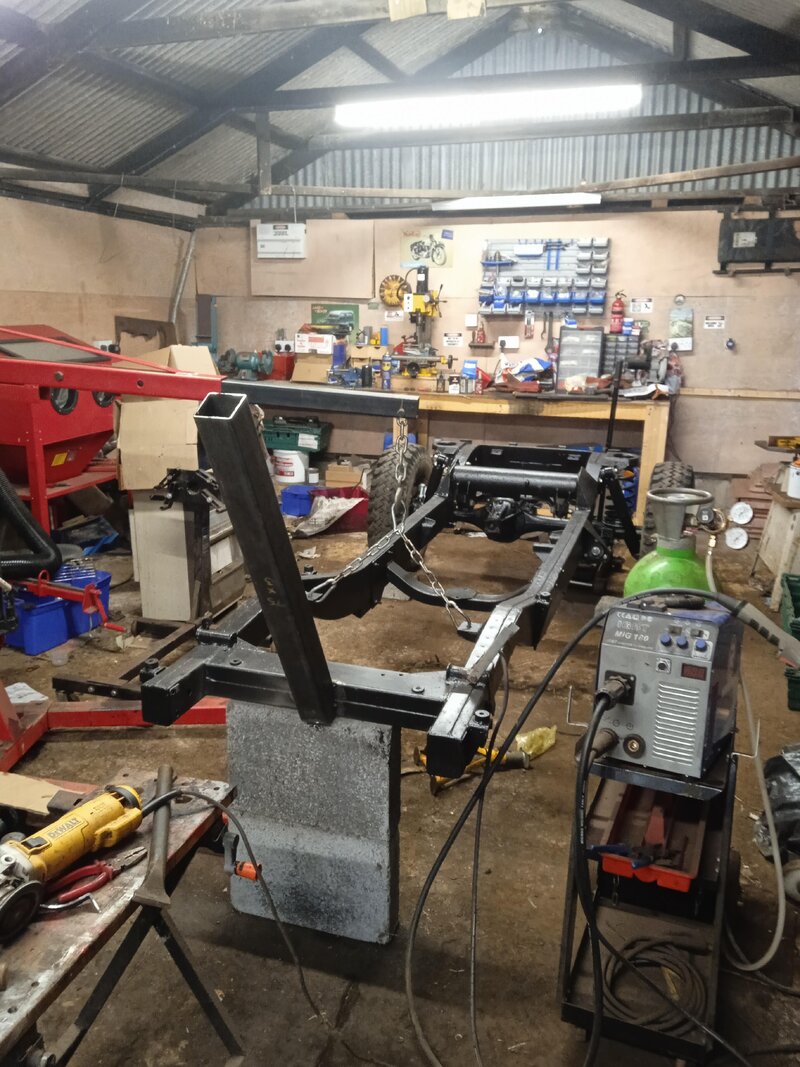

Despite the fact that I've not posted in ages, I'm still getting on with the trike....the chassis (frame) is now fully repaired, the rear axle has been fully rebuilt/ repaired and I'm well on my way to sorting the front end.

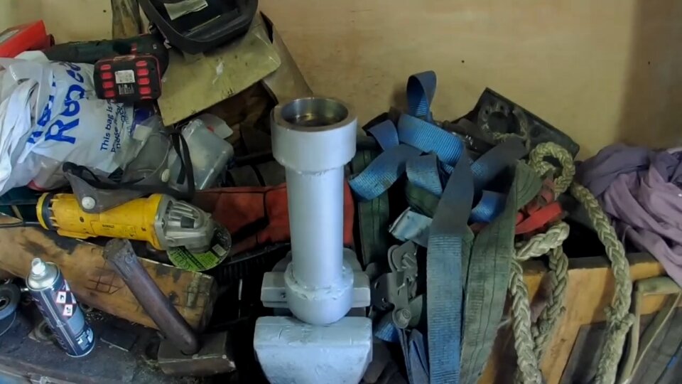

Just today I finally got around to welding on the main frame member that will hold my steering stem and started to make the stem as well.
The pic is how it looked before the welding....my decidedly dodgy welding can be seen in my latest video
The rest of the steering tube fabrication should hopefully happen in the next day or so....

I've just spent the day boring out tubes for my headstock bearings with a mini mill made from the finest chocolate grade chinesium...it has been a nightmare having to nursemaid the machine just to ensure that it doesn't strip its NYLON gears...:xzqxz: (The milling machine is what you guys probably know as an X2....and they can be made usable by changing the gears to metal and adding a belt drive to the spindle, but that costs plenty and I'm spending too much already on this fun project!)

....the steering head is now finished.....and what a pain in the parts it was to get done....
...full story in the video below....and just a quick reminder guys, I do tend to swear a lot in my videos, so if you don't like curse words please don't watch it!
