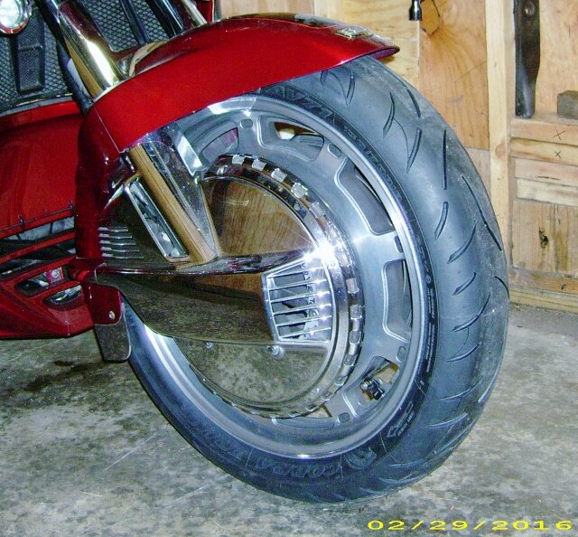

Wow! ...... today I came home, slipped the battery back into it, put the seat back on and took it for a short test ride. Almost immediately I noticed that the ride was some smoother over pavement joints, etc with the new radial and it does steer "smoother" some how. Don't misunderstand .... it steered great before, but now it just has a different "quality". Not harder like before the rake .... and not really a featherweight like after the rake ..... it's still easy with no increased effort but now it seems like it has a damper that holds a line better. Hard to explain.
"It's as easy to steer, but now it stays put better" ..... does that sound right?
Ran it up to highway speed on some new pavement .... it's definitely a smooth tire .... and NO "Buzzzzzz" at 30-35 mph.
Anyway .... you can color me "PLEASED"! :)
I neglected to say that I did swap the brake pads over with the rotors and I also threw 2 ounces of Airsoft Red Jacket BBs in through the bead using a small funnel before inflating the tire yesterday evening .... and judging by how smooth she is, it was enough.

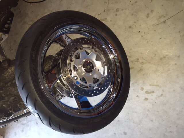

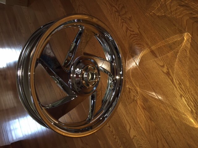

I took off my wheel while my Wing is at the dealer to have it chromed. It came back yesterday. Boy it sure looks nice. But it required patience and a lot of elbow grease to clean out the bearing races that had been chromed. I also had to tap put the rotor bolt holes and one of the rotors was too tight, causing me to grind a little off the inside of it to fit on the hub. Here are some photos of the wheel just after it arrived and after the build up and tire mounting.
Avon 130/70R18

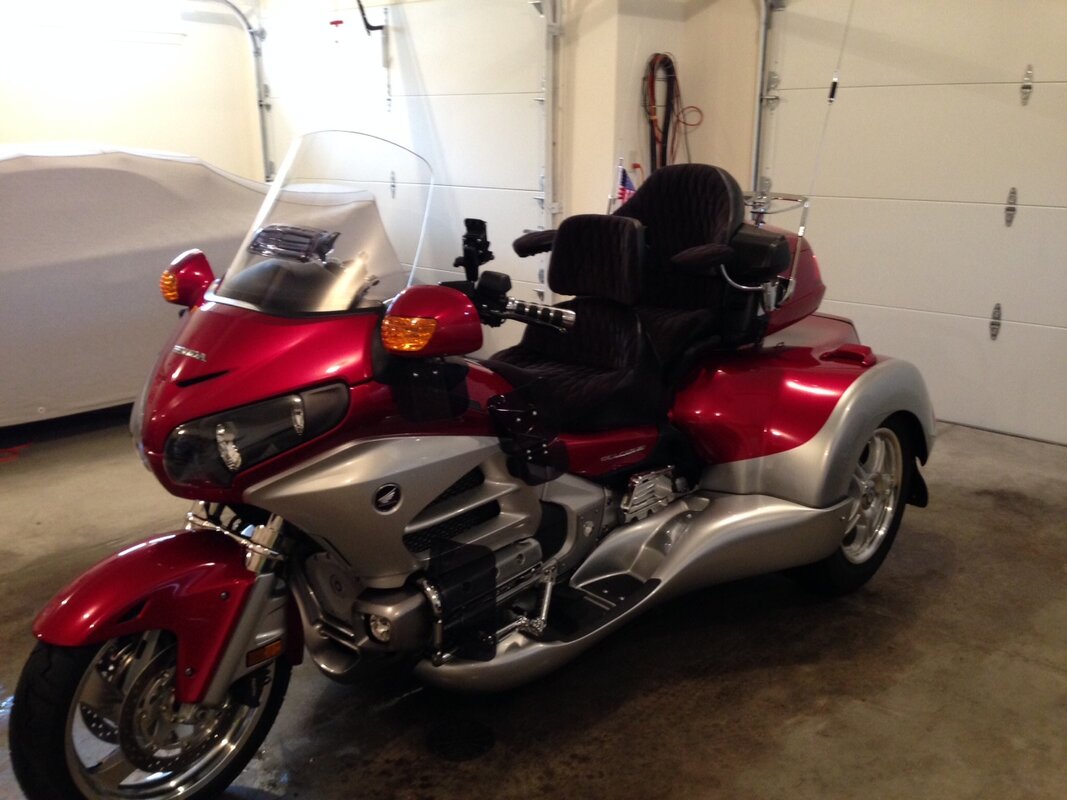

Avon trike tire
image1.JPGI have put over 7000 miles on it and could not be happier!
Cant say enough about the Avon went to Longmont CO from the Toledo Ohio area on a trip and put on 5647 miles. No problems with tire wear, handled great and doesn't feel like the Trike is going to push through the corners and go off- roading on me.
I tried the rear tire in the front mounted backwards idea and tossed the tire in the trash after 250 miles awful!
Low speed wobble vibration just didn't feel right.
I use Avon Cobras on my two wheeler and love them will surely replace the Trike tire with another Avon after it needs it.
I will be interested in how long this tire lasts will keep you all posted.
Hope this helps! (cheapest I have seem is 198.00)

I am still really satisfied with my Avon Trike tire and will buy another when the time comes. Only 8K on it so far.
I must also say that you have a beautiful Trike, really looks nice.ThumbUp
