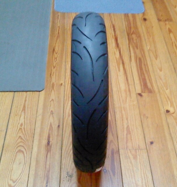

Well .... ordered late late Saturday night the 20th (actually near midnight) from Chaparral using an Ebay ad. anticipated delivery Monday the 29th .... it was on the carport this afternoon the 23rd. Not sure where the tire came from but every address I can find points to San Bernardino, Ca. That's pretty swift.
Guess I'll be working on that later this week .... maybe tonight after supper. For the record, I measured the tread depth in several places being sure to miss the TWI with two gages and found it to be 6.5 / 32nds which is a gnat's hair above 5 mm (6/32nds is 4.76 mm).
If mounted as intended .... NOT reversed .... then the loading on the tread "blocks" (really big slabs, not small blocks) is across from center to rear following the general direction of the grooves .... as scarce as they are. Personally .... I LIKE what I see ..... looks like the tread would experience minimal scrubbing.
Also, the tread is rounded with a gentle arc so that it's profile new is a lot like a worn Michelin PA that's on the Trike (minus the cupping). In point of fact ..... it was easily stood up on it's own on the kitchen floor for several minutes.
Date code is 45th week 2015 so it's "fresh" too!

Wonder what the weather is gonna be like Friday????
