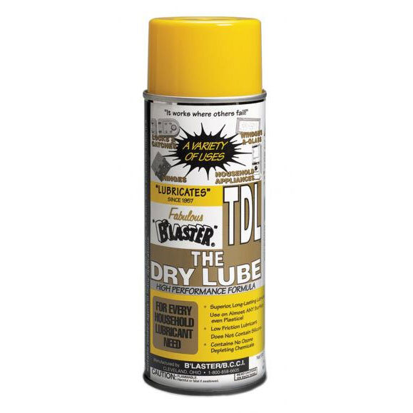

My door fell open once, good nothing fell out, bad it was inside the trailer and chamfered the top against the ramp. I have a "new" beveled edge door for sale. I little lube has prevented a second time.

Like others have said, lube lock occasionally, keep door locked and don't slam the door. Wife and I put over 5000 miles on 2014 triglide last year and door never came open. Last summer I rigged up a led light inside of top and bottom trunk. There is a magnetic switch that turns light on when trunk is open. Been thinking lately about running a led light up to fairing somewhere to alert if door comes open. Just tap into existing wiring, simple.
