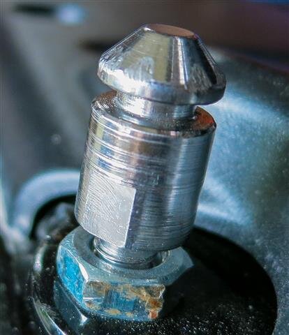

I just returned from a trip to Wyoming and Montana on my 2011 Tri-Glide, and once again, my trunk lid popped open on the trip. This time it was in a parking lot instead of on I-90 at 80 mph like last time. I rotate the lid latch pin to keep a fresh unworn edge at the latch point, but I spend a lot of time worrying about the lid opening and not knowing it. I've searched the internet unsuccessfully for a trunk lid warning light. Do you know of anyone who makes a kit?
By the way, every time I rotate the trunk latch pin to get an unworn edge, I lose the recommended 26.67mm pin height. If not rotated, the pin edge wears away and the latch becomes loose and susceptible to popping open. This is a terrible design, but when I talked with my H-D dealer, there is no fix or recall.

I have a new 2015 Tri Glid and its come open twice in 2200 miles....I'm thinking of putting a hasp and padlock on it.....It would be better than the HD design...Ha!! Maybe the locking pin has too much chamfer on the corners(?)
where in locks into the latch.???
I had the trunk open a few times with my 2011 tri.. I found that the pin was not going in deep enough so the latch that drops down into the groove doesn't go fully into it. Since i adjusted it 3 years ago it has yet to pop open. I didn't use any measurements i did it by eye.. Also my pin doesn't have any marks on it, So maybe your latch is just resting on the tip of the pin..And not fully locking :Shrug:

Looks like an adjustment is the way to go, but if thatdoes not work I would put the pin in my lathe and open it up a few thousands squaringthe shoulders up in the process
I have ordered a new latch pin. $21 for the pin alone. I keep it pretty well lubed, but will make sure it's lubed nicely before my next trip (Prince Edward Island at the end of July.) I'll also lock the trunk all the time.

I adjusted it this morning and found the edge dinged up so I turned it and adjusted it out just a little bit and sprayed some lube on it. While I agree a better latch would be the optimal way to go I would like to have a warning light until that happens is ever.
