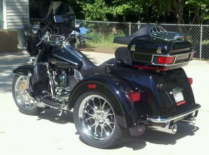

I put a set of brackets on my Triglide to raise the rearend mainly to keep it from dragging the pipes. They make it look better because it sets level now, no handling affects at all. Have not hit the pipes on the ground one time even though I have 4 inch exhaust. Only raised it 1 1/2 inches at the shock but raised the tail pipes even more. At 130.00 it is a buy if only to save my exhaust.
I put a set of brackets on my Triglide to raise the rearend mainly to keep it from dragging the pipes. They make it look better because it sets level now, no handling affects at all. Have not hit the pipes on the ground one time even though I have 4 inch exhaust. Only raised it 1 1/2 inches at the shock but raised the tail pipes even more. At 130.00 it is a buy if only to save my exhaust. Dennis Swan in Ohio sells them if anyone is interested.

I made my own 1.5 inches and they really do make a difference. No more dragging the mufflers and makes your hitch not hit the ground also. I have not found anything unfavorable about the raise in the back of the trike and you can see it would help taking the rear tires off.

I am very pleased with the lift on my spouses FHLXXX. It was the naked XXX as opposed to Dan’s XXX with the tour box and all the FLHT gadgets. The pics with the trailer is Dan’s Trike and he rides two-up most often and runs 50PSI from day one, still bottoming out from time to time and quite often pulling that trailer. His trailer was loaded to the hilt last year and probably weighed 300 or better. It is empty for these pics but still weighs in at around 170,but the pics don’t show how low it normally is as we didn’t have a passenger available for pictures and the tongue weight at the time of photography
Is only 18 lbs. Loaded is about 40. His trailer is a Legend.
Now on the wife’s Trike; she is towing a 115 lb empty Motorvation Trailer, around 215 loaded normally and she rides solo. So these pics are at 28PSI which is a little stiff for her solo without the trailer so with the lift I will try 28 with the trailer and probably drop to 22 without. I weigh 240 and with the lift riding home at 28 the bike felt pretty darned right to me. It was always OK handling for me but a little loose feeling in the front end over dips and bumps, especially after we changed her front tire to an Avon Venom.
The Venom is slightly larger in diameter than the stock Dunlop and puts a little wider tread bite on the road which amplified the handlebar wag back and forth over uneven bumps and dips. After the lift within the first 50 yards I was liking the way it was feeling and after the 3 mile ride home I was loving it. NO MORE WAG! The bars stayed solid and true over bumps, dips, freeway joints and on and off ramps. I was amazed at how much more in control it felt and I am absolutely positive it is the best $130 I’ve spent on this FLHXXX to date.
I’ve ridden near a ½ million miles on various bikes and done a ton of upgrades to date, but for the difference in ride and control I felt on this first short ride $130 was a real bargain. I’m one of those people that feel everything on a bike. I’ve ridden my bike home from and dealer and know the air pressure is down in a tire by 3 or 4 pounds or that the steering head is a bit loose and the like. It’s not because I’m a pro mechanic or anything special, it’s just that I’ve ridden so many miles and when I ride I indulge completely in the ride, the feel of the bike, and every turn, smell and sound. I just love to ride. Riding is what I do to feel relaxed and alive. So I notice things like this and I’m impressed.
Dan just called me. He took my advice and dropped the air pressure to 35 and went for a short ride before our daily rain downpour this spring and first words out of his mouth was, “Wow, what a difference, I like it, best money I’ve spent on this Trike.” He can’t wait to try it with his passenger and trailer.
First pic Right XXX lifted 50psi left stock 28psi
Second pic XXX lifted 50psi
Third PIC XXX stock50psi

I have put on a little over 500 miles since putting these on, and very happy with the way it looks and handles. It made the trike sit level. If you did not own a trike you would not even notice the lift, It looks the way it should have came that way. Yet if you park next to another one, very noticable, and much nicer.
