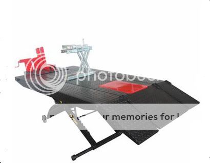

I have two Handys and four BlackJacks like these:
They are actually stronger and longer than the Handys and cost less.
