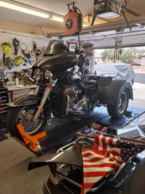

I bought a lift from Redline Engineering when I got my trike, I'm also too old to be rolling around on the floor. It's a model HD1500 and the lift capacity is 1500 lbs. I like it because the sides in the back that the rear wheels sit on can be removed. I built a work bench that is tall enough for the lift to slide under when not in use if I remove the sides. That way everything is out of the way. It's air over hydraulic and has a good front wheel vise. It also cam with a front end extension which allows the trike to sit far enough ahead of the side extensions so that working on the engine is easy.
Here is a photo of the lift with the trike on it.

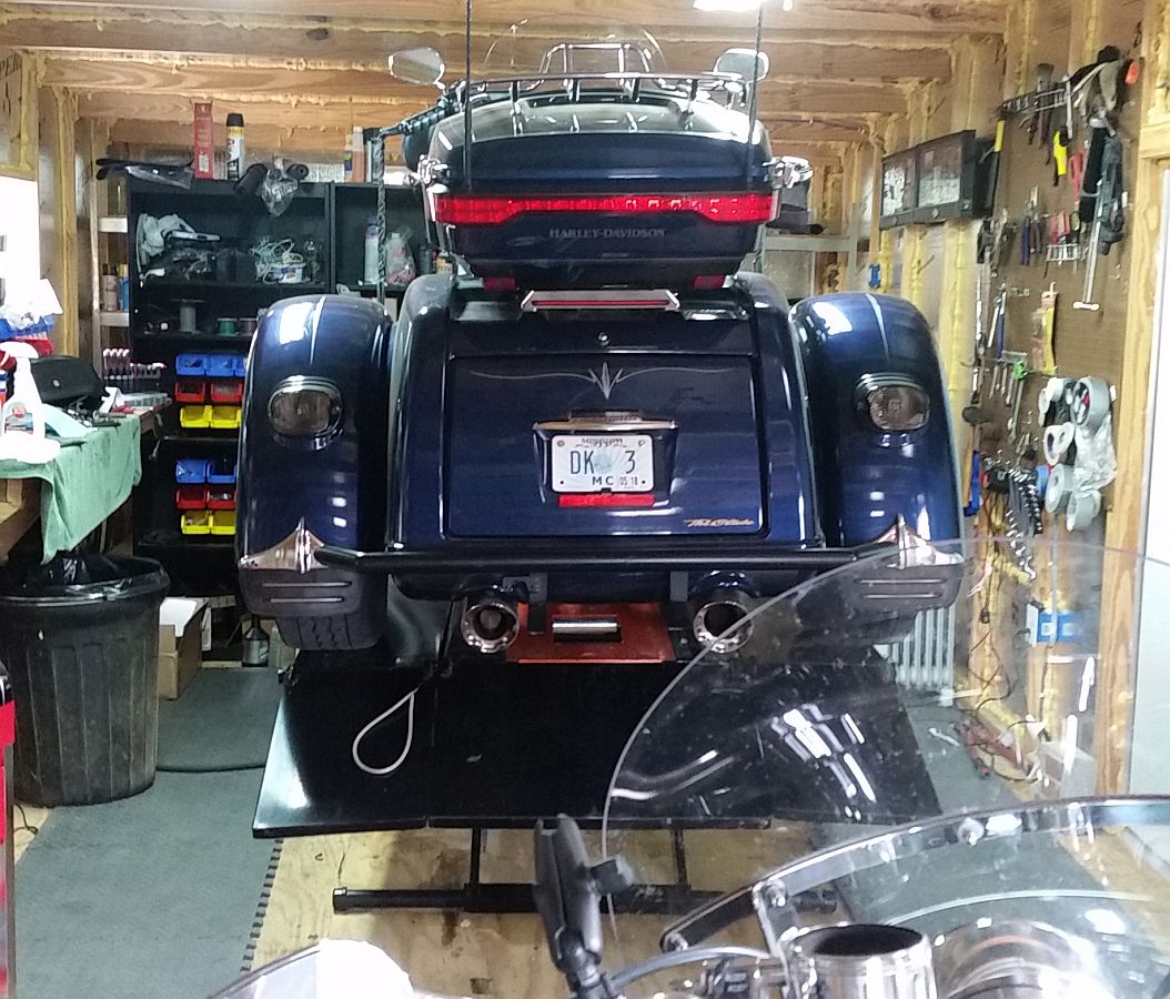

I purchased a A-Plus lift through Amazon. It has lift for 1500lbs. It is 48" wide and with the extension which I utilized since I just triked my GW. I have improvised the rear to support my rear tires as 1/2 of both rear tires were half off the rear table. Used 2- 4X4's stacked and about 1 foot long on each side as temporary fix until I can get a welder to fabricate a wider rear extension for the rear tires. It is pneumatic and lift and lowers without issues. It has served me very well from two wheels to three wheels. I too am to freaking old and stiff to be rolling around on the concrete floor servicing my trike. Below is the information on the table. Hope this helps you out.
Product description
APlusLift MT1500 is a 1500lb Heavy Duty Air Operated Lift Table. It is one of the most popular lifts with a Front Wheel Clamping Vise, a Drop Out Tail, a 3 Stage Adjustable Front Extension, a 20" long Drive-on Approach Ramp, and a FREE Service Jack.
Specification
  • Adjustable Table Lengths: 84" - 97" - 110"
  • Weight Capacity: 1,500 LB
  • Table Length with Approach Ramp: 128"
  • Table Length without Approach Ramp: 110"
  • Adjustable Front Extension: 84" (Table Alone), 97" (Stage 1 Extension), 110" (Stage 2 Extension)
  • Stage 1 Extended Length with Approach Ramp: 115"
  • Stage 1 Extended Length without Approach Ramp: 97"
  • Stage 2 Extended Length with Approach Ramp: 128"
  • Stage 2 Extended Length without Approach Ramp: 110"
  • Drop Out Tail Dimensions: 14" x 21"
  • Removable Approach Ramp Length: 20"
  • Table Width without Extension: 24"
  • Table Width with Extension: 48"
  • Table Steel Thickness: 1/8"
  • Safety Locking Positions (to top of table): 19.5", 21.75", 23.5", 25", 27", 28.5", 30"
  • Maximum Lifting Height (to top of table): 33"
  • Lowered Height (to top Of table): 7"
  • Lifting Table Surface Area with Extension: Table: 48" x 84"; Stage 1 Ext.: 48" x 97"; Stage 2 Ext.: 48" x 110"
  • Service Jack: Max Lifting Height: 15"; Lowered Height: 3.5"; Weight Capacity: 1,000 LB
  • Air Requirements: 90-110 PSI
  • Shipping Weight: 500 LB

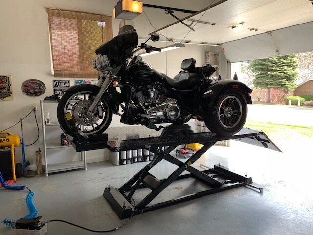

Been using this lift for the Trikes and the 2 wheel bikes for about 8-9 years now. Been happy with it.
