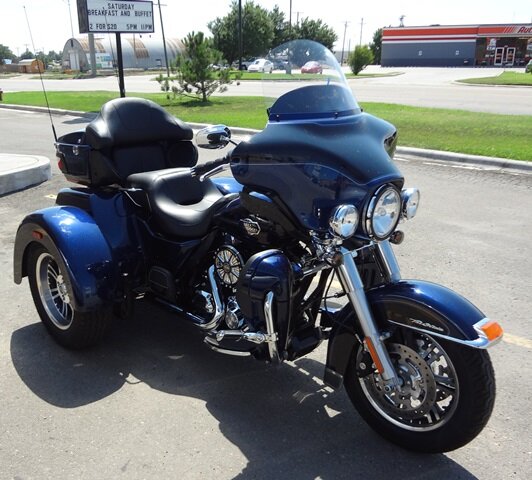

Here is a photo of her trike... 2013 model

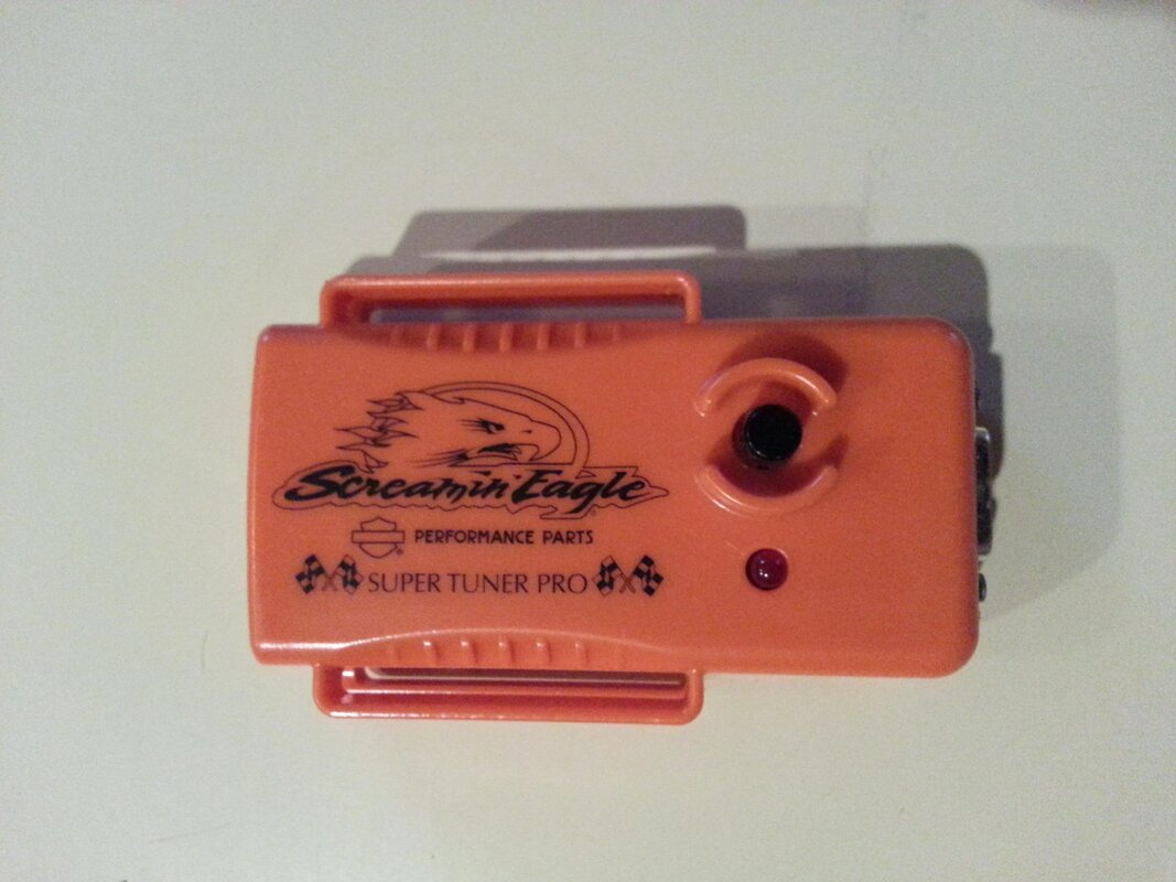

Nice looking trike. The company who builds the Screamin Eagle Pro Super Tuner is SPX Kent Moore, not Vance & Hines. Things get a little tricky when you say orange box, they have two SE tuners in orange boxes, the Screamin Eagle Pro Super Tuner and the Screamin Eagle Street Performance tuner, the street tuner only allows limited adjustably. The street performance tuner is pretty much like having a canned map downloaded into the ECM. The Pro Super Tuner allows a whole bunch of changes to be made, it is the more desirable of the two offerings. The down side is the Pro Super Tuner will void the warranty if Harley finds out that it has been installed.
Your loading up problem sounds like its from oil, I'm betting the installing dealer has screwed the pooch on the build. I'm thinking you have a piston ring problem, all the dyno work in the world won't compensate for a poor engine build. The dealer needs to start with a compression and leak down test and trouble shoot from there.
Below is a picture of the new Pro Super Tuner, I won't confuse things by posting a picture of the 1st version of this tuner which was in a black case. Which of the these do you have?

Well that is a good question. I was told it was a super tuner and I know it's orange. I never physically took it out of the box for a close look. I think it looks more like the top one but I cannot be 100% sure.

Also the tuner we have actually has Super tuner printed on it. The box states "this product is intended for race applications only. Intended for experienced riders only.
