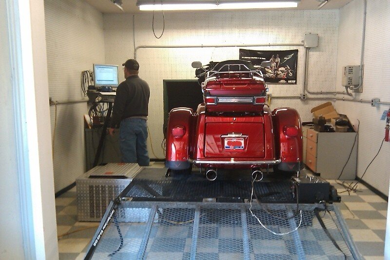

I had 2 trikes dynoed by the same shop. I was there in the shop both times the whole time watching the work. First tune was to a 2007 HD 103 Police Roadking with a Champion conversion. The interface was a Power Commander III. The tune took 5 hours. The second was a 2013 HD Tri SE tuner and the tune took 6 hours. The tuner person took a 1 hr lunch a 2 smoke breaks. A good tune does take time.
