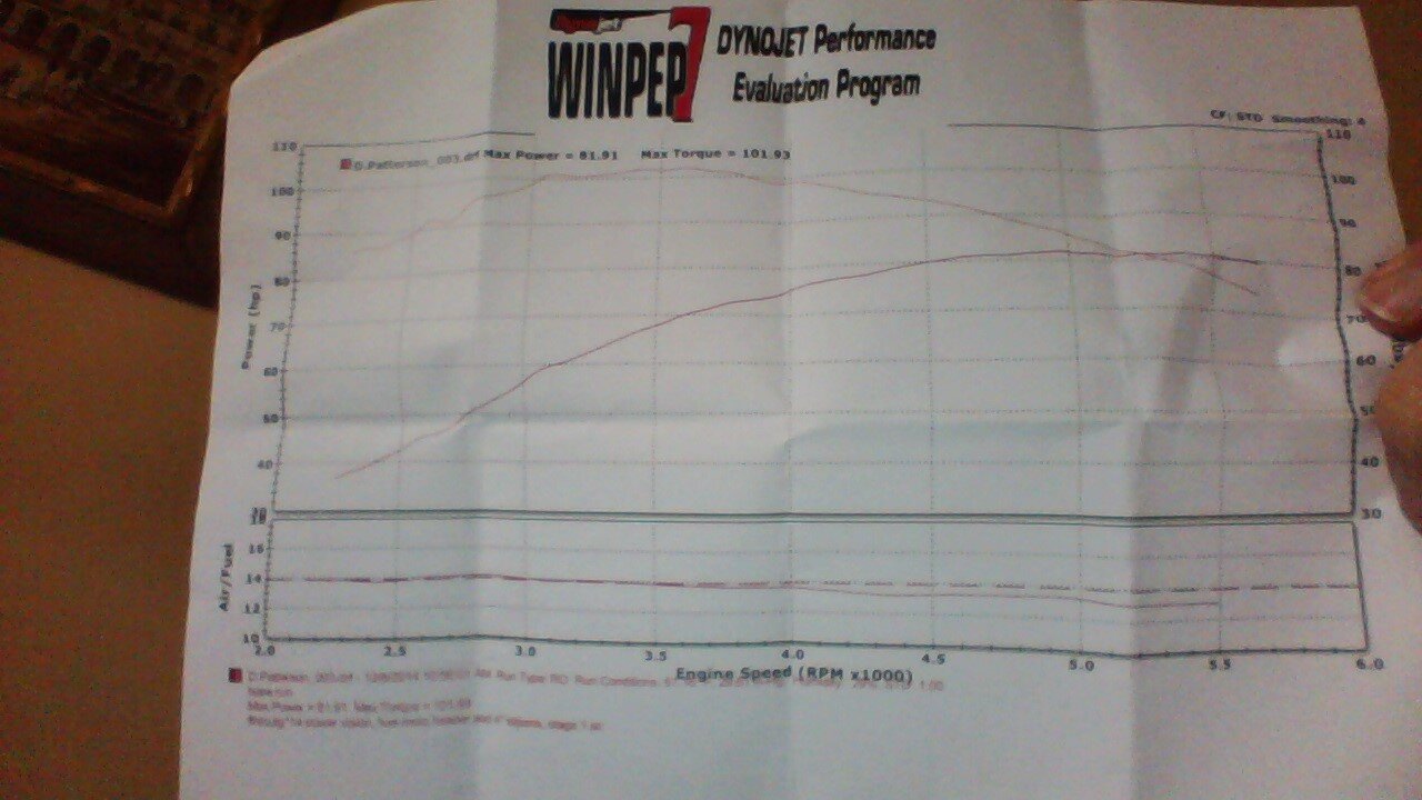

My dyno chart
Aug 31, 2014
459
31
Sacramento, KY
David
2014 Tri Glide Stage 1 A/C, Fuel Moto SS headers, FM 4" Jackpot mufflers, and Power Vision Tuner
Tuned with the auto tune feature. Had free pulls, it was done STD and in 4th. I would appreciate any input, I know it shows high due to the way they ran it, but does it look like a decent tune? max HP81.91 max torque 101.93 Thanks
Doesnt look bad. AFRs might be a tad rich above 4ooo rpms. Clutch slip around 2700 rpms and up.
