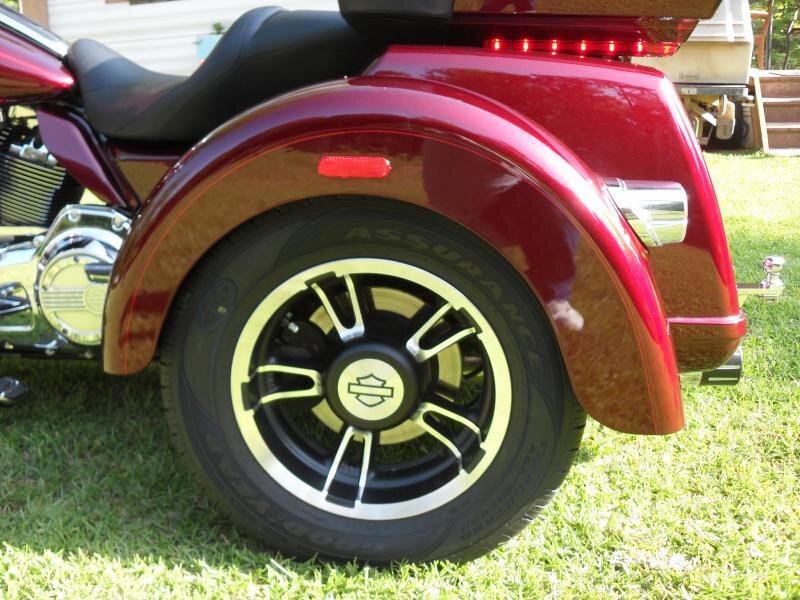

I've tried to search this, but.......
Will the Free Wheeler Rear rims fit the TriGlide? Both are 2015's
Thanks - And Happy New Year Gang!
jc
Yes they all fit
jc
I'm sure they will interchange if I would change wheels It would be after market lots out there any tire and wheel shop could assist you in selection. Clint has a wealth of knowledge on wheels and fitment on triglides PM Clint he is always glad to help. Please give him a little time to respond he is really busy right now. ;) ride safely fearless
Thanks Fearless - I will wait on Clint - There just happens to be a new pair near me for $150....Hard to pass up if they fit - I do like them better
jc
Will the Free Wheeler Rear rims fit the TriGlide? Both are 2015'sThanks - And Happy New Year Gang!
jc
I'm almost positive they are interchangeable as I've seen TriGlide wheels on Frees,and vice versa.
jc

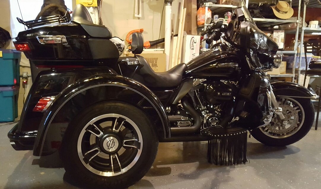

Yes sir they will and a 19" Street Glide will also...
