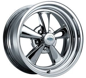

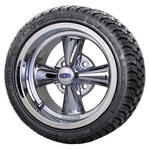

Unless someone can give you info on changing the hubs to five lug Cragar SS wheels aren't going to work as the spokes go the whole way to the center of the wheel and are 5 spoke/5 lug only. The only 4 spoke/4 lug Cragar SS wheels were 13" made for Fox body Mustangs. All 15" Cragar SS wheels are 5 spoke.

Not enough room to use an adapter/spacer, unless you also buy Yaffe's wider fenders.
There are lots of wheels out there that will fit a TG or FW. Just know that many will not.
Do a forum search as I've explained the numbers you need to know, to get a correct fit.
