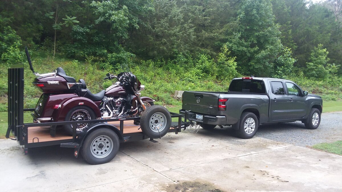

I haul my Tri Glide around on a six and a half by 10 trailer. I have the Condor chock all the way to the front and just drive it on and lock it in the chock. Never checked the tongue weight. Traveled thousands of miles with it and never had a problem with weight. I'm towing it with a 22 Ford Explorer King Ranch.

No just the trailer on a class 3 hitch. The trailer is only a 10 ft bed so I only have maybe a foot to play with front to back before the tour pack hits the gate.
As you can see with it sitting on a trailer there's not much room to go back even if I wanted to move it. It works fine just the way it is. Shown with the truck I had before the Explorer.20230715_083113.jpg
