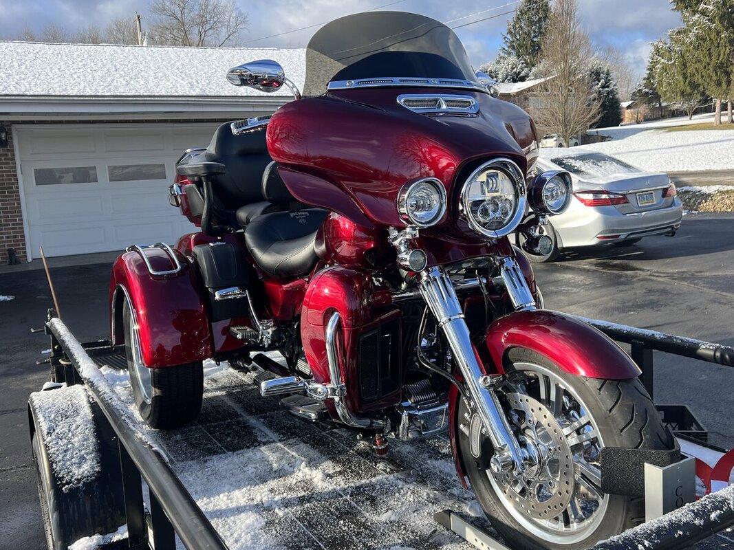

I’m going to chime in what works for me.

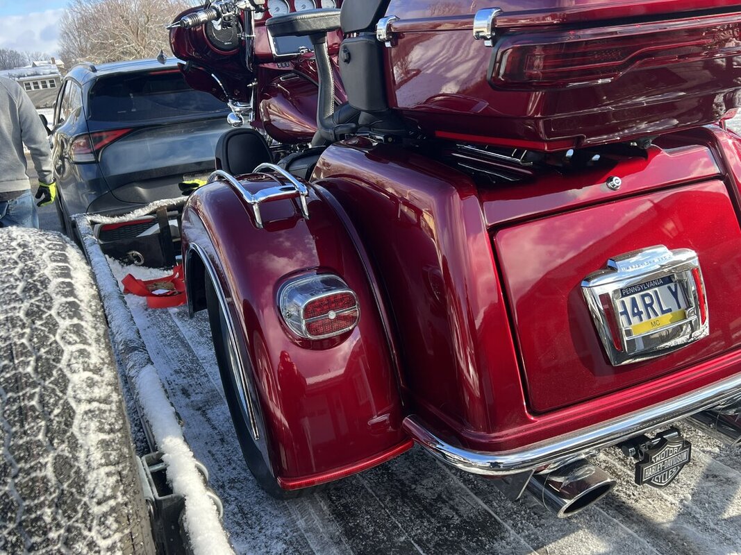

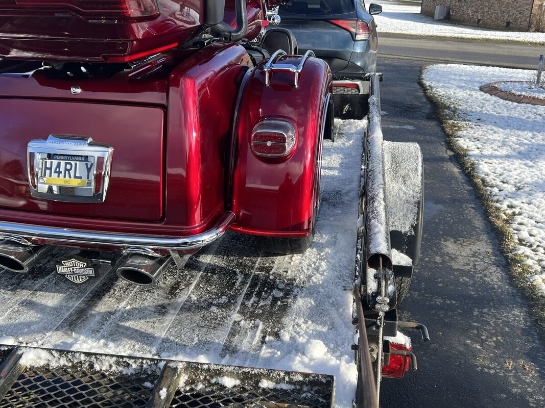

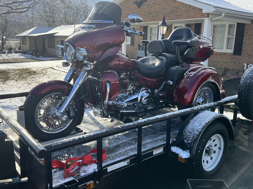

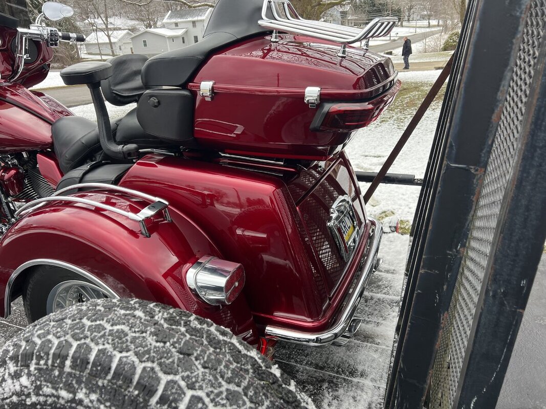

Years ago, I purchased a 5.5’ x 10 “Carry On” brand trailer from TSC (Tractor Supply Company).

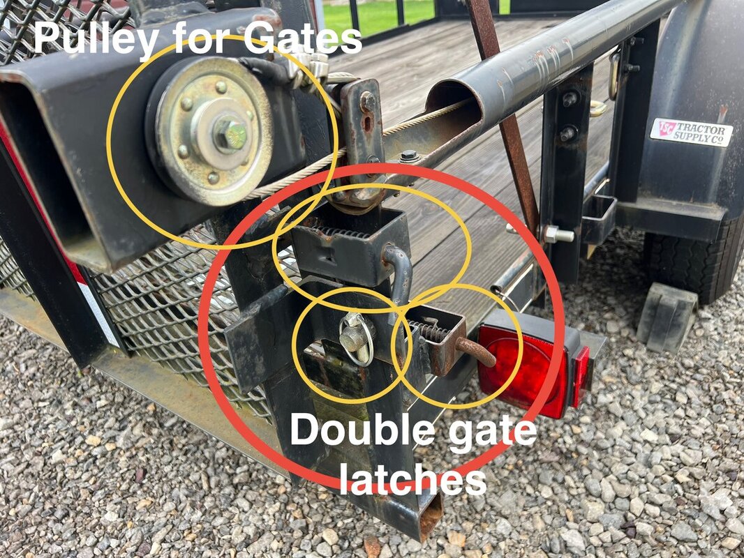

I’ve had numerous bikes on it, and even modified it a little by adding (welding barrel hinges and welding on another gate) so approach angles are very minimal, and even put a spring inside the tube so one hand open & closes it without effort.
This spring was the first time putting my trike on it. I had a scheduled appointment to get it professionally ceramic coated & the weather was still being a PIA, so I decided to just trailer it and this gave me the time to see and make any adjustments for any future trailering of my Tri Glide.
Even with the 9 degree rake kit (which increased length by approx 3”) … my Tri Glide’s TOTAL overall length is: 108-1/2” (just a hair over 9’ long).
And my overall width (fender to fender) is: 53” (just a hair under 4-1/2’)

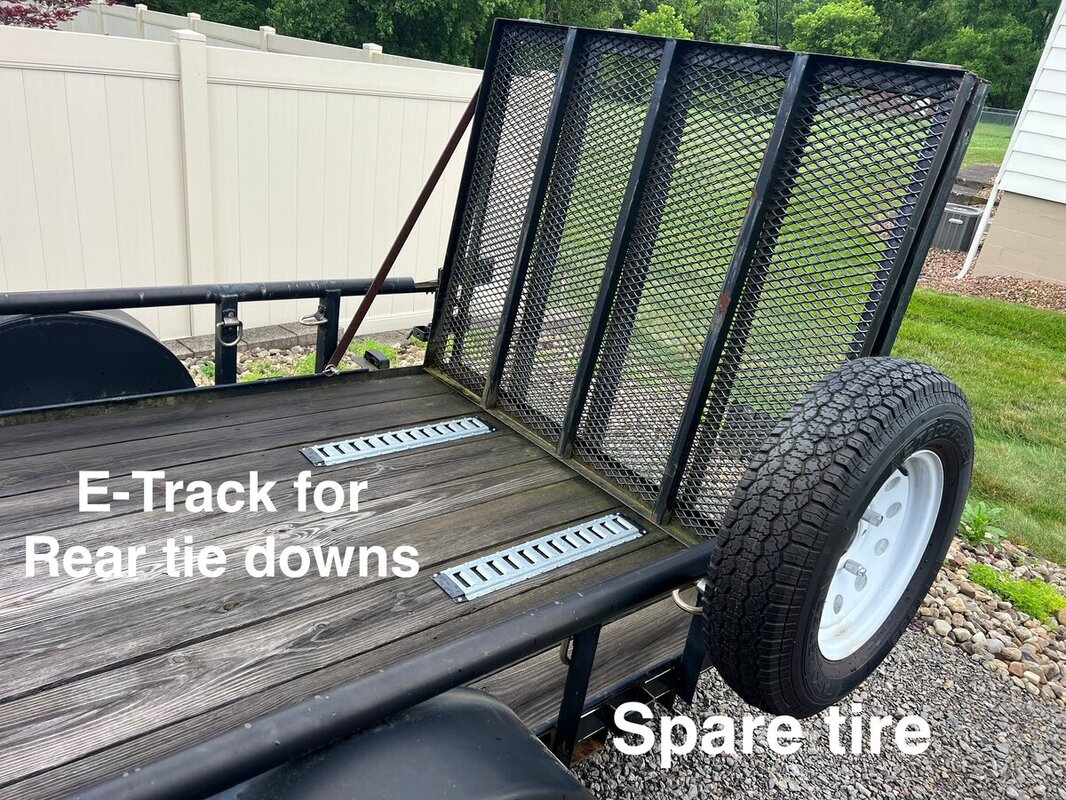

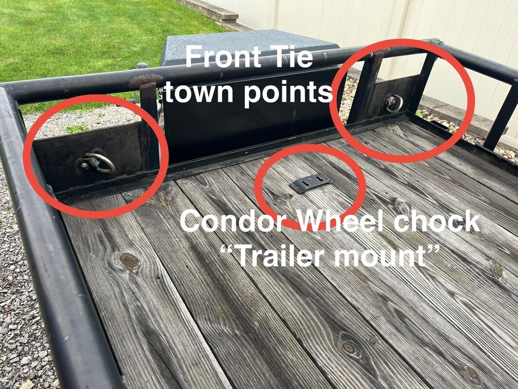

With a condor wheel chock on the front, and my double gate in the rear, it still fits without any issue. (Since the pics shown below, I added some E-Track rails to make it more convenient to tie down - especially the rear) … but I would not hesitate recommending this same size trailer for this. (It fits fine & affordable at a price tag of $2,000 if one has intentions to use it more often and/or other uses).
The length from the wheel chock, to my “double gate” is 113-1/2”, and the width is 64”
I Still have 5” from my gate(s) to my rear bumper.
And I still have 5-1/2” of clearance on each side of my fenders.
If tied down properly, the trike will never move nor make any contact whatsoever.
The trailer max load is: 2,076
The trike weighs: 1,250 (fueled up & gear/ready to ride.
That is still 826lbs below max load.
Of coarse going with larger size and/or enclosed is totally up to you…. I’m just saying an open trailer works just fine for me if it is set up correctly.
Hope the info and pics help.

The trailer you purchased from TSC looks like a very good plan. Almost looks like it was tailor made for the Tri Glide

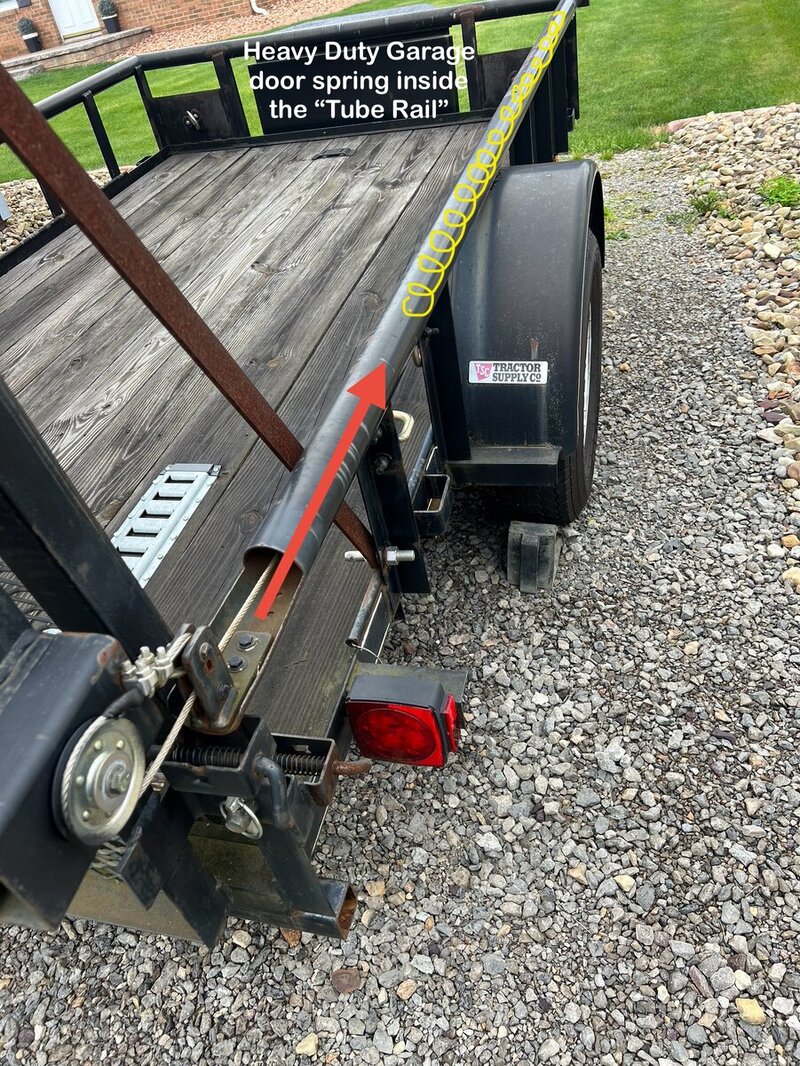

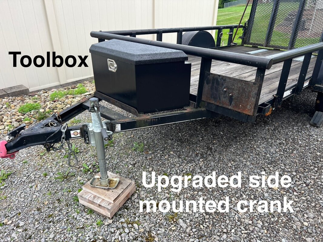

It’s a pretty decent trailer. I put a small tool box on the front, and the “double gate” is awesome so it’s a gradual approach and no “bottoming” out.
I had our zero turn’s mower catch when I first purchased it, so that’s what gave me the idea to buy another rear gate, weld on some good grease-able barrel hinges and then welded on a couple brackets to keep the gates from any movement.
But, it was heavy…. So the one I have has the round tubes on top. I experimented with some garage door springs to allow to fit inside the tube, and is effortless to flip both gates up with one hand.
It fits the Tri Glide with comfort room to spare. 👍🏻👍🏻
Here are a few pics of the upgrades I’ve done over the years to make it “Perfect for Me” and my needs:
Changed to Rear LED lights and although hard to see… but in the corner of the last picture, I welded square tubing on each side and purchased 2 more hand cranks that I crank up the back of both sides to get the tires off the ground in winter time (tires are treated and then covered)… but the crank jacks are in the front tool box and also can be used to jack up for a tire repair, if needed. 👍🏻

I could only wish I had your skills for making those modifications. Well done.

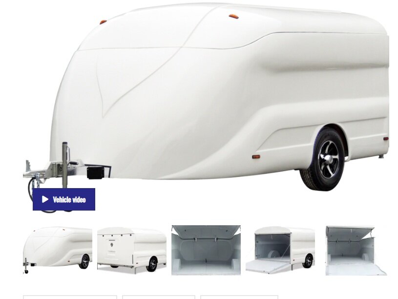

Not the cheapest, but arguable amongst the best for quality and weight are Ironhorse fiberglass/aluminum enclosed trike trailers of McMinnville, TN. See Ironhorse Trailers - Motorcycle trailers, enclosed trailers
The factory Harley Trikes have a narrower rear end, thus easier to find a suitable trailer.
Brochure link here https://ironhorsetrailers.com/wp-co...s-Widebody-FlipTop-Motorcycle-Trailer-V23.pdf
The IRS Hannigan Mod trikes are W I D E and need a W I D E trike trailer. We got an Ironhorse Wide-body FlipTop trailer (1,170 empty trailer weight, add your trike or a pair of two-wheelers for total weight) for easy ONE PERSON ride-in load, back-out unload, with locking wide, low ramp and internal tiedowns, and front wheel chock. Aluminum frame and Dexter low profile torsion axles. Also got the trickle charger dongle option. So the trailer is a secure at home/on travel storage option...
One tip, we'd suggest if getting an enclosed trailer box or otherwise, to resist the temptation to deck out the trailer in mgf colors (e.g. Harley Orange & Black) and decals... 👉👉👉 for trip/storage security considerations.
Most folks/thieves can guess what's inside an distinctive Ironhorse Trailer (motorcycles/trikes), but for a smaller box cargo trailers the contents (your precious motorcycles/trikes) are less evident unless --- you advertise your pride/ride.
