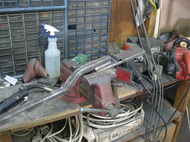

The 1 1/4 inch male receiver that comes with it I bent upward for 3 more inches clearance. Just fill with sand, pack it down real good (no air space), cap both ends mark where you want the bend and heat then bend until you get the clearance you want.
It has never dragged. I did not use their male receiver, I used my own. I do a lot of welding so I have plenty of steel most of the time.

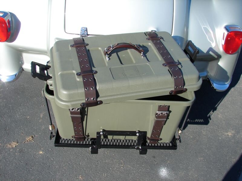

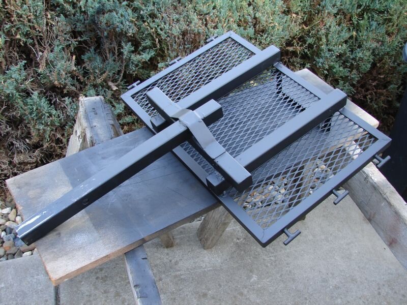

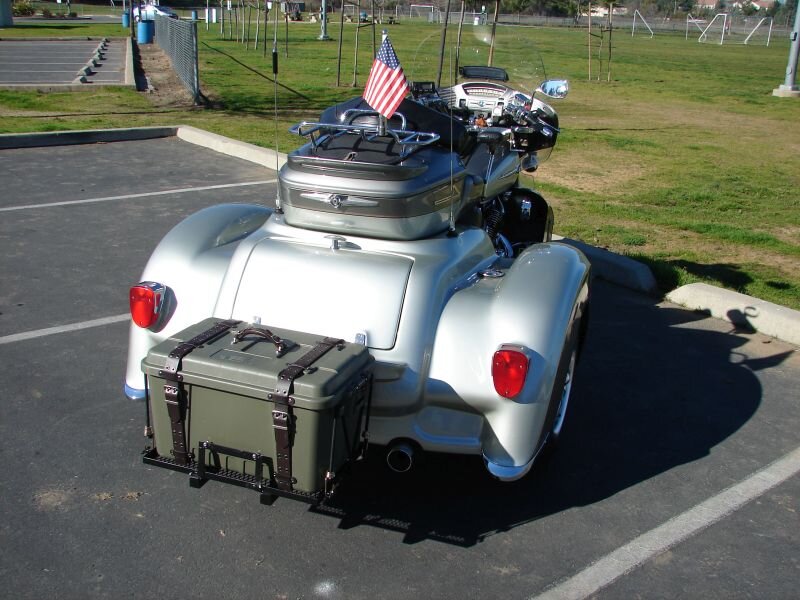

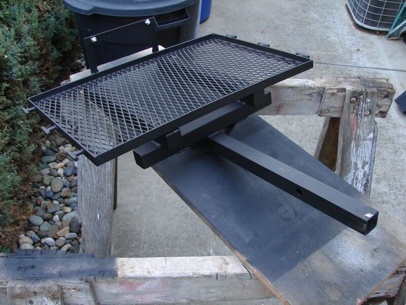

My Venture is up for sale at this time but thought I would share with you the carrier rack that I built. It was sized to fit the box. I did not like the color of the box and was against painting it (plastic) so the next best thing was to try to make it take on an older classic look with straps and handle... My only suggestions is if you make one or have one made, is to be sure its high enough to it will not hit the ground or drag of course, but to be sure you have full access to your trunk when the lid is opened... I moved my license plate and attached to the carrier when being used, it only takes a few minutes. Its great for two to four day overnight trips for riding two up, longer that that we use the trailer. If on your own "hell" who knows.:D

Nice sturdy looking rack. This is what I had in mind for a carrier rack. Do you remember the measurements and where you got the box?
I purchased the plastic box from Sportsman Warehouse. The container is made by Plano Item #1301885 for $17.99 specs are 24"x15"x18". I believe it's 56 quarts... I think it's a great container for storage and just about the right size check it out... I looked for quite some time and have been very satisfied with my choice... The rack I designed exterior is 21"x13 7/8" remember the container tapers down toward the bottom.. Lot of luck in building your own..
