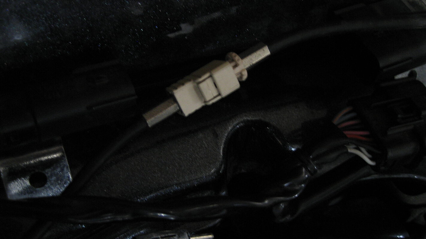

I purchased DK's relocator and have all the elec. connections undone except for one stubborn one. Can anyone tell me how this one comes apart? Thanks Rich

Success. A bit of a pia, the squeeze tab wasn't completely releasing it. I took a thin, flat blade screwdriver and inserted on the round side end and that helped push the clip out of the way. It was stuck on there pretty good! Now on to the removal and relocation part.
