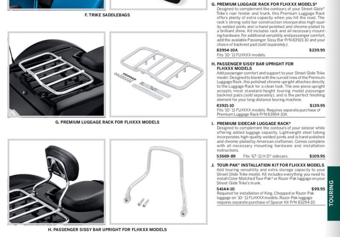

FLHXXX Parts & Accessories Snapshot
This snapshot with pictures and part numbers of the Street Glide Trike Luggage Rack and Sissy Bar Upright might be helpful for searches in the future.
