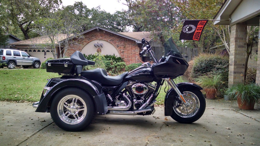

Hey guy's,
I love this trike, but I am craving more power. My 2010 RGC trike has a 103 with 255 HD cams Dragos H-pipe exhaust and Power Vision Tuner. It runs "OK" kinda peppy from Idle to about 3800 to 4000 RPM and then it just falls flat. (i understand that is the design of this cam)
I understand it is the weight that is killing my performance (1260#'s). I want to build/buy a Torque monster. If I am going to do this, I want to do it right or not do it at all

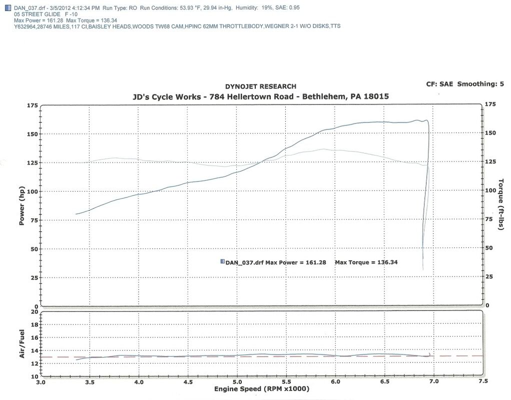

YW. There was a guy who built a 117" engine that made over 150tq/hp for his Streetglide. He ended up building a 124" that wasnt as radical on the street.
Sounds like TXChop, way radical engine. It would have been a hoot as a bar hopper, but traveling would have sucked.
