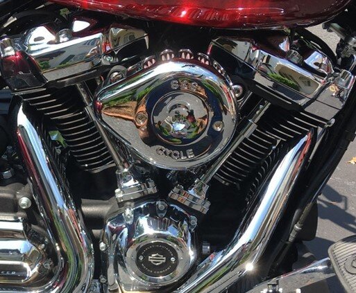

Looks good on your Freewheeler Jeff
Quality made in the USA;)

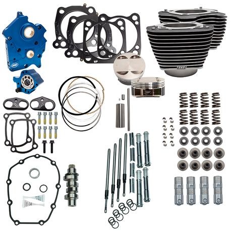

Jack, I have a couple questions???
1. If you had this kit, do you think the stock throttle body would work OK?
2. When they are talking in the description about "gear driven kits" does that mean your eliminating the cam chain?
Yes , gear drive cam
I would want a bigger throttle body and injectors
Would gear driven be a better way to go with that much of a power increase?
A bigger TB & injectors would add a lot to the cost.
I found a 5 year old post on here & the guy spent $6,500 on a S&S 124 cu. in motor.
If I ride down to Florida this spring, will you install it for me? I'll buy lunch!:D
Yes, Gear drive is more accurate valve timing provided the crank run out is in spec
A bigger throttle body and injectors would be a big compliment to bigger cam

135 ft. lbs of torque. I would get in so much trouble on that, it would be a high cost besides the installation.:)
Just a days work, right?;)
Yup, that much torque would be fun
Good thing the engine and tranny are bolted together
Back in the day they were not
Many hot rod Dynas suffered broken inner primaries til this came along
  • Like
Reactions: MDO
Ahhhhh...the Carlini torque bracket.So beautiful I could mount it on a polished wood pedestal and just stare at it.But I bolted it onto the shovelhead instead-with some modification.Not just for hotrods!Any big twin from the Evo back could crack.No I would not go to gear drive on the M8 without flywheel up grade.
