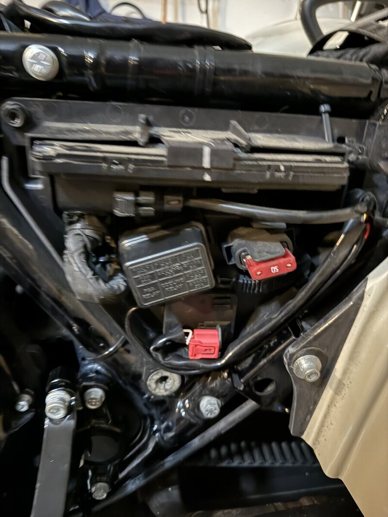

I went looking for the battery tender and aux power connector today to wire up some stuff. The battery tender was zip tied by the left muffler and has no power. Does it have a fuse. I could not figure that in the manual.

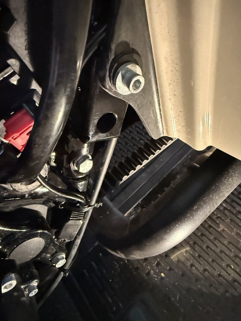

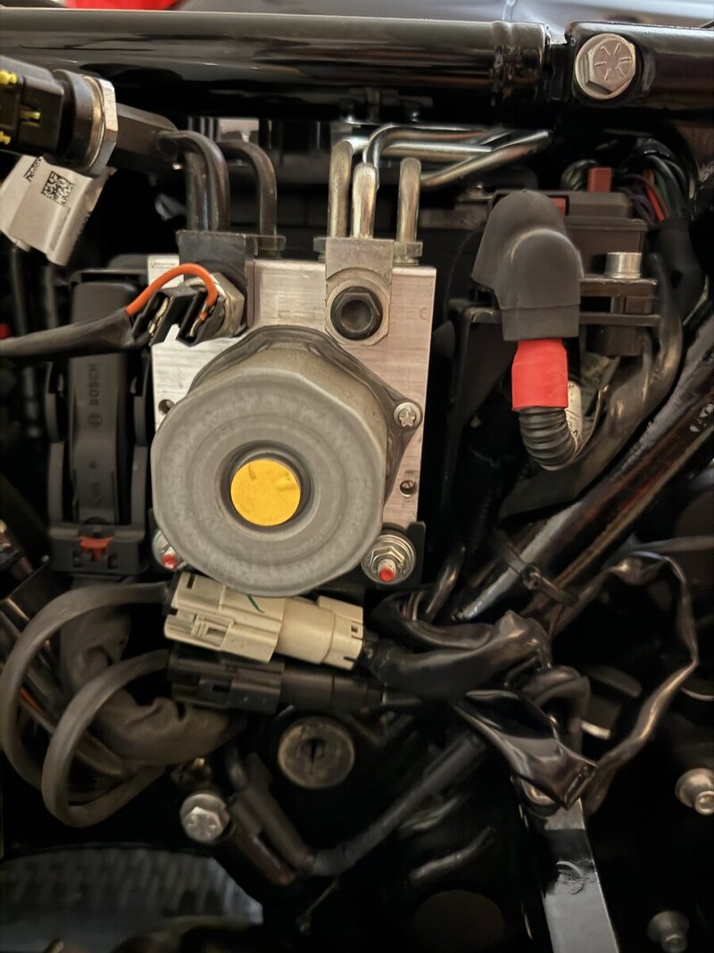

I found it, blown fuse 4… I should have searched better. What I can’t find is the aux power plug on the right or left side. I bought the expansion harness from HD 69201599A. But I can’t find where it plugs in and the manual is no help. I added pictures of the under cover left and right side.
If I remember correctly, I found the connector you're looking for in front of the battery compartment rather than on one side or the other. Note this is on a 17 Tri-Glide.
